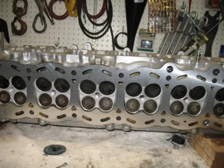

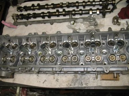

Pics of the head after cleaned, shaved off .007".
looks beautiful.
Can't imagine it's good to have water in the crankcase even for a a few days. Probably better without anything at all? Or just use some cheap oil and replace that before very long. May also help with any dirt / metal that may have found its way into the engine during all the work.
So fresh and so clean (clean!)
Maybe now would be a good time to do one of those fancy AutoRx treatments to remove sediment and other impurities from the crankcase... it would mean a shorter interval for your first change, but I think that's a good thing in this case.
I would drain the water/oil mix now. When it is ready to run refill with cheap oil using the same filter, start it, warm it up, tune the settings, test drive, then change oil and filter. I would only run that oil about 500-1000 miles, then change to a "good" oil and filter and normal oci.
