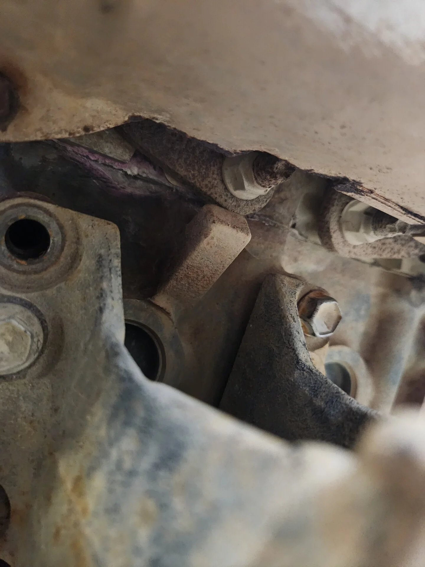

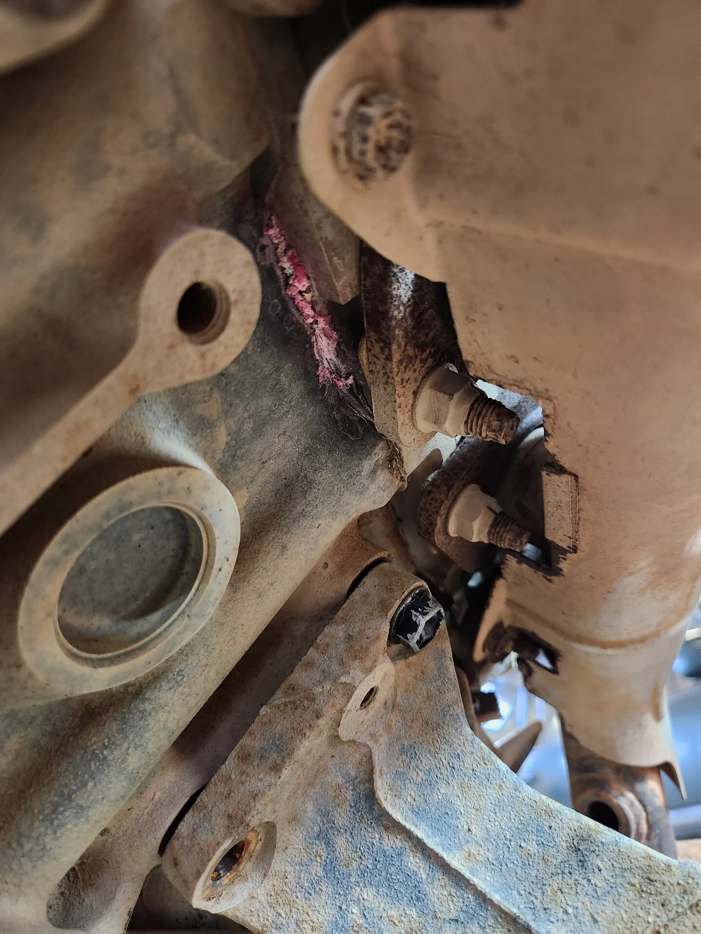

275,000 miles and 20 years. Started leaking externally at the back of the PS head as well as just above the engine mounts on both heads. Truck ran fine and an inspection of the cylinder bores didn't give me any reason to believe it was leaking internally but I'm sure it was only a matter of time.
Truck has never overheated or ran particularly hot. I believe the head gaskets just timed out. After 20 years of faithful service they just had enough.
I could have pulled the heads and replaced the gaskets and I'm sure it would have run for another 200k but I had a spare motor built up in the corner of the garage so it's getting replaced.
Thats certainly a rare occurrence on the UZ motor. Ive never seen it before or heard of it. You could probably just leave it and be completely fine, as long as its not leaking internally. Just check all throttle body , coolant hoses, and crossover pipes before you rip the heads off

That's very similar to a infamous Subaru EJ25 headgasket failure. Those are caused by a combination of poor-quality OEM gasket coating and grounding/electrical issues causing electrolysis in the coolant.
