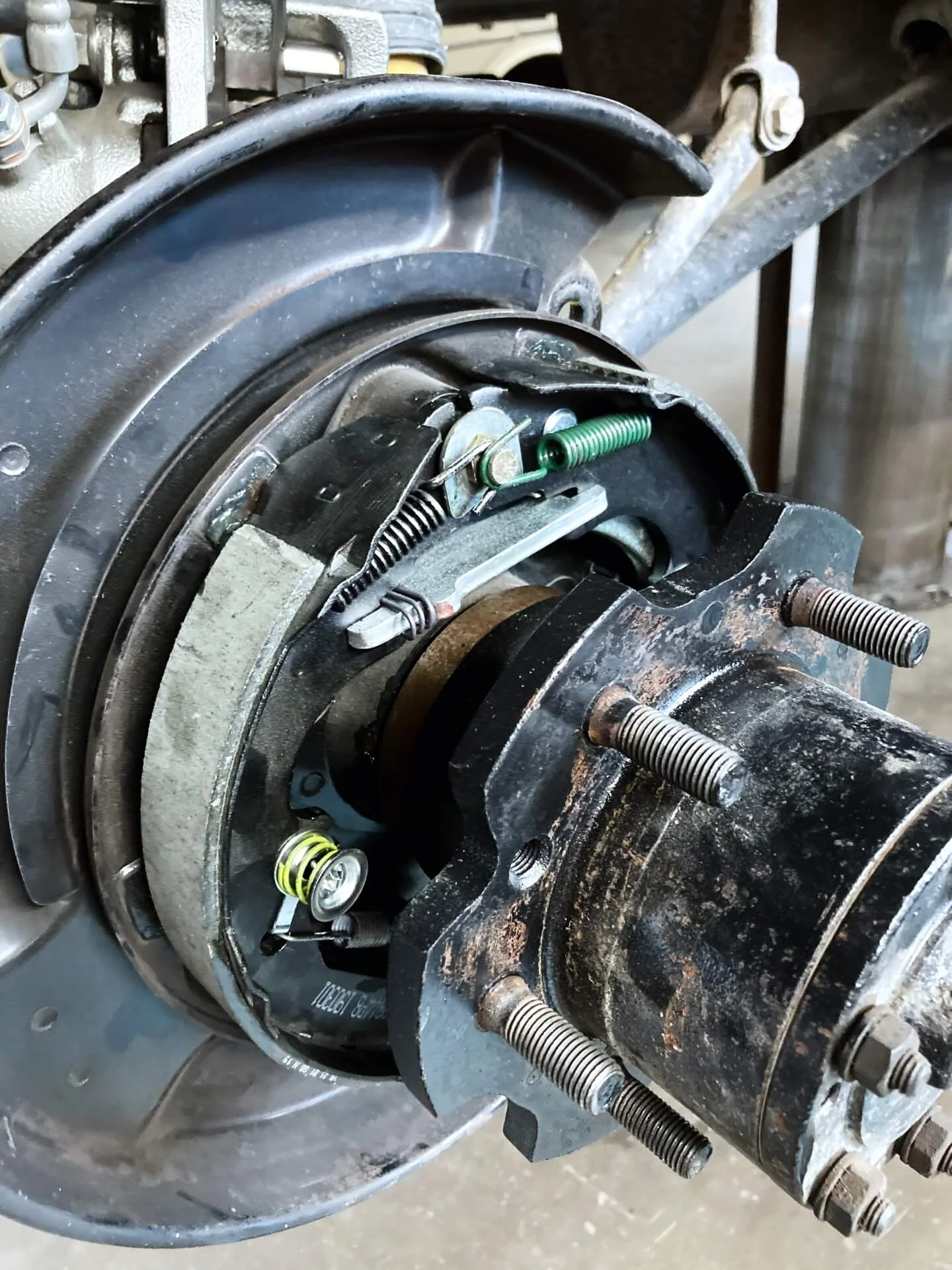

Once you have all the parts, crack open your FSM and follow the instructions for:
  1. Removing the old calipers and rotors
  2. Removing the parking brake shoes and bellcrank assemblies

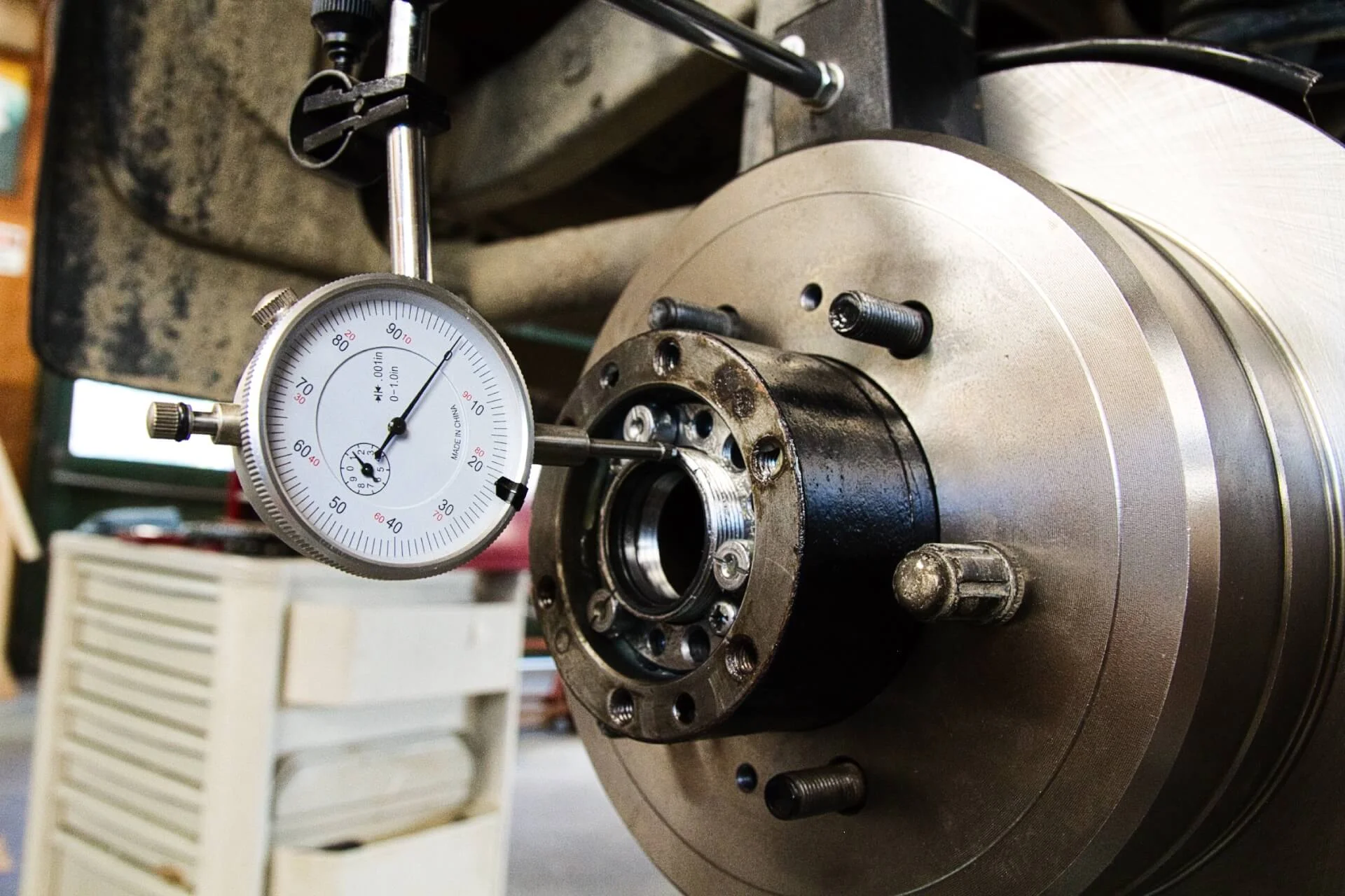

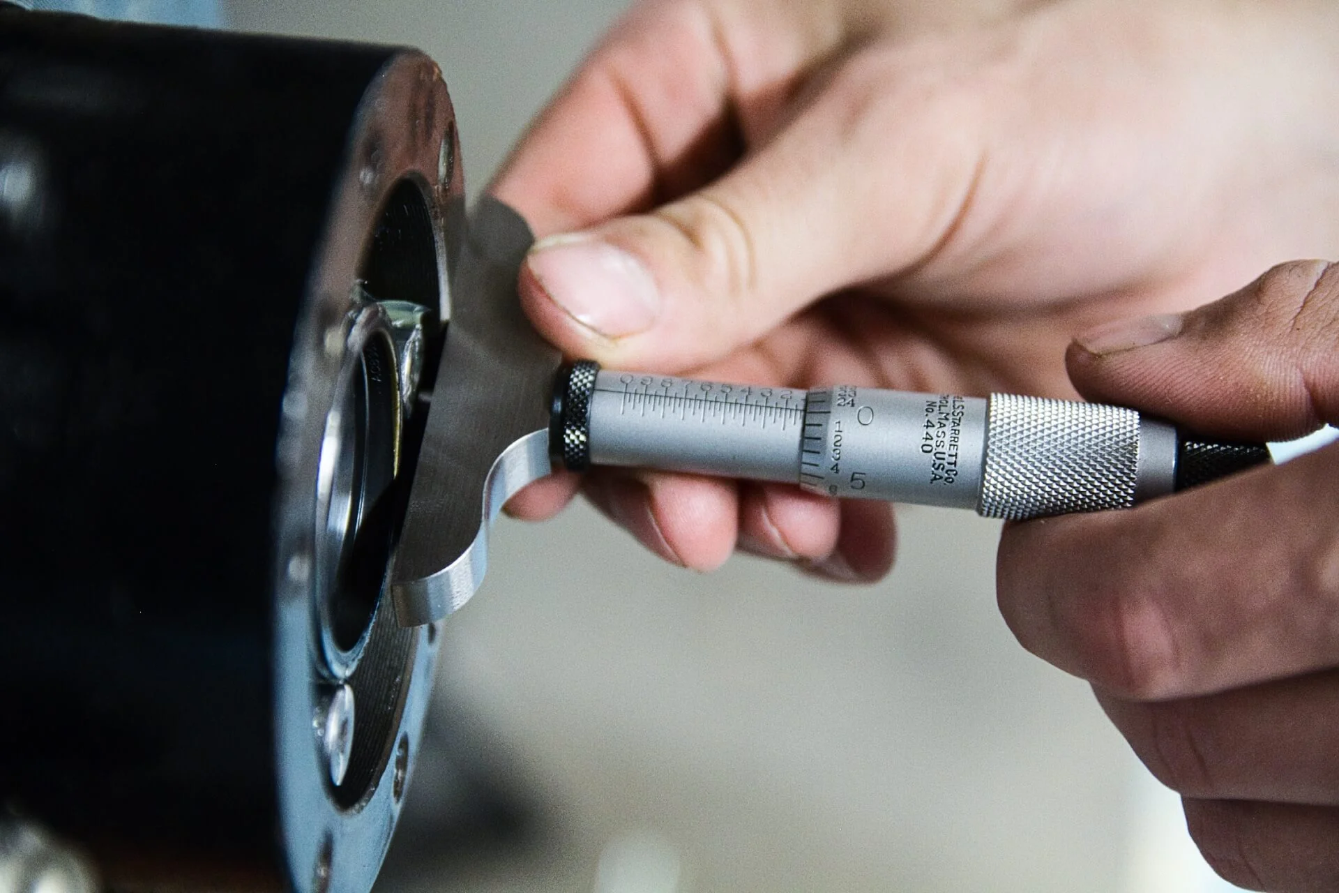

  3. Removing the axle shafts and hubs (now is a perfect time to replace/re-grease wheel bearings and change out diff oil)

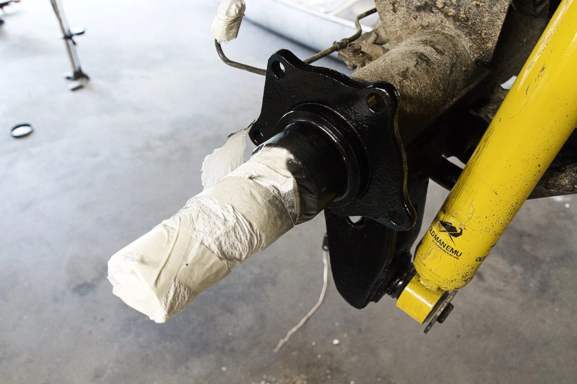

  4. Removing the brake backing plates
Installation is the reverse of disassembly. The FSM provides all the torque specs and more detailed instructions for things like preloading the wheel bearings. Swapping out the brake components is actually really simple. By far the most difficult part of this job is removing the axle half-shafts and then getting all the bearings repacked/adjusted.
