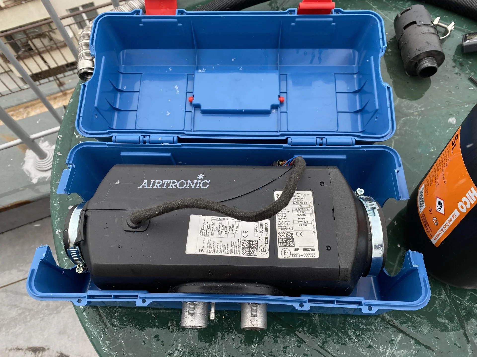

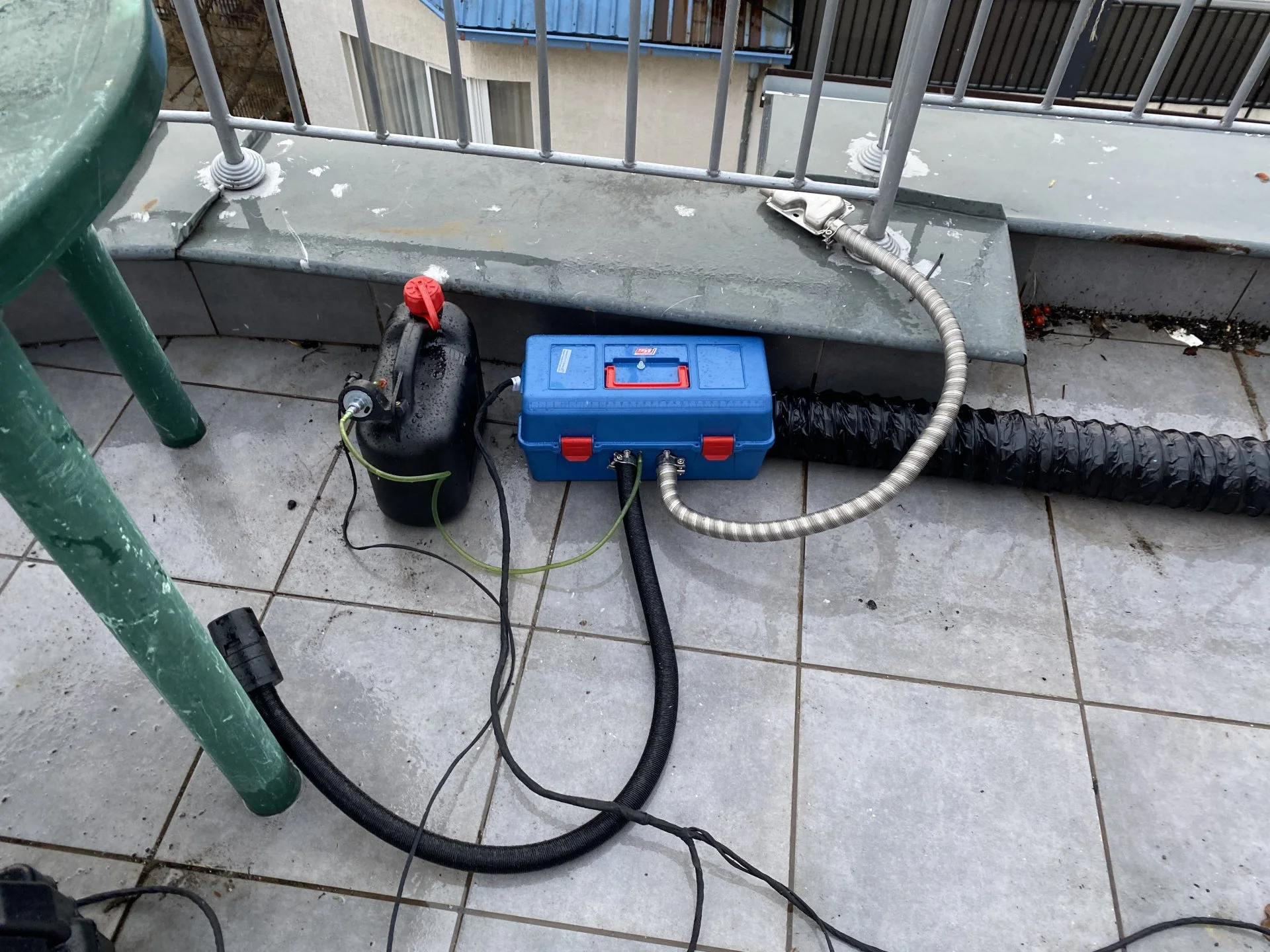

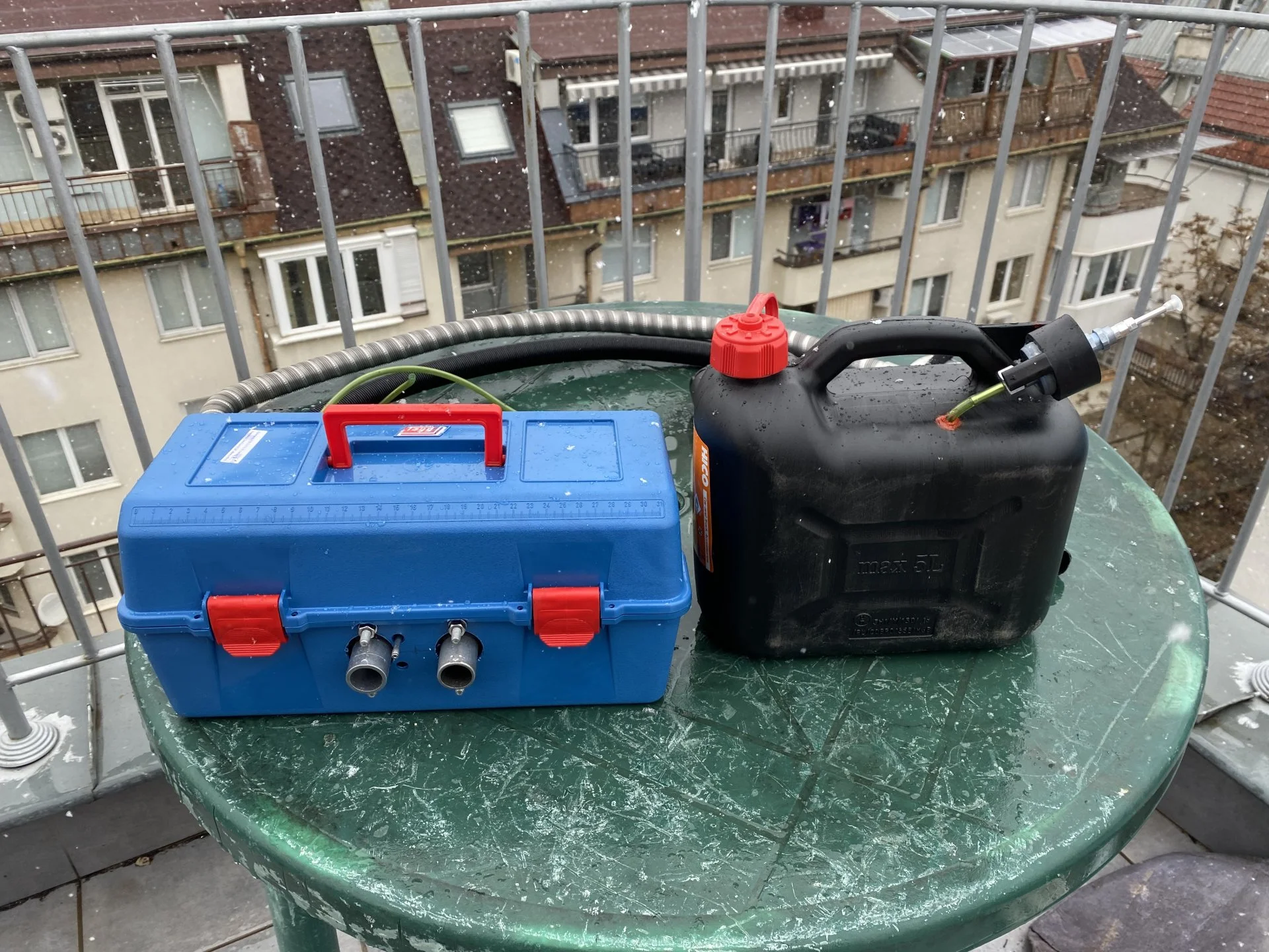

For heating I made this heater thing. It's a production version of the contraption from a few posts above. One air duct for hot air to the tent and another duct that will suck air for heating from the tent.
Inside is an Eberspacher Airtronic, instead of the Chinese piece of crap I tried previously. It's noticeably noisier, but has much much better control of temperature.
After 30-40 minutes of working at full power, it got up to 27C/80F inside the box.
I integrated the pump with a fuel can. I was considering integrating the can and heater in a larger box, but this might be a bit more convenient.

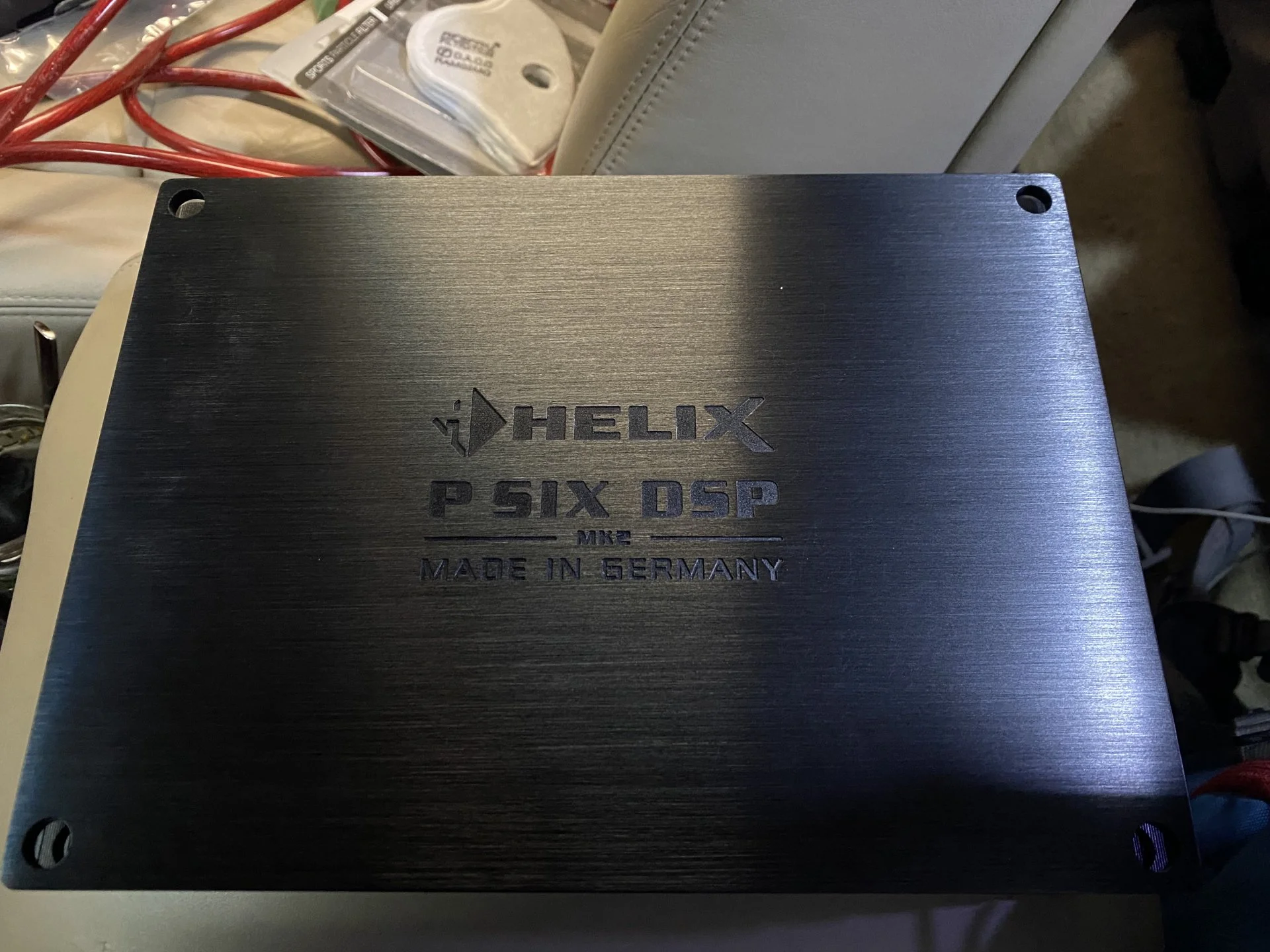

When you go active with the dsp you won’t need rears or you can throw in a dedicated midbass on two Channels of heavier amplification and get that 80hz-400hz really thumpin...if you like kick drums and what not
WOW WOW WOW WOW WOW were you right!

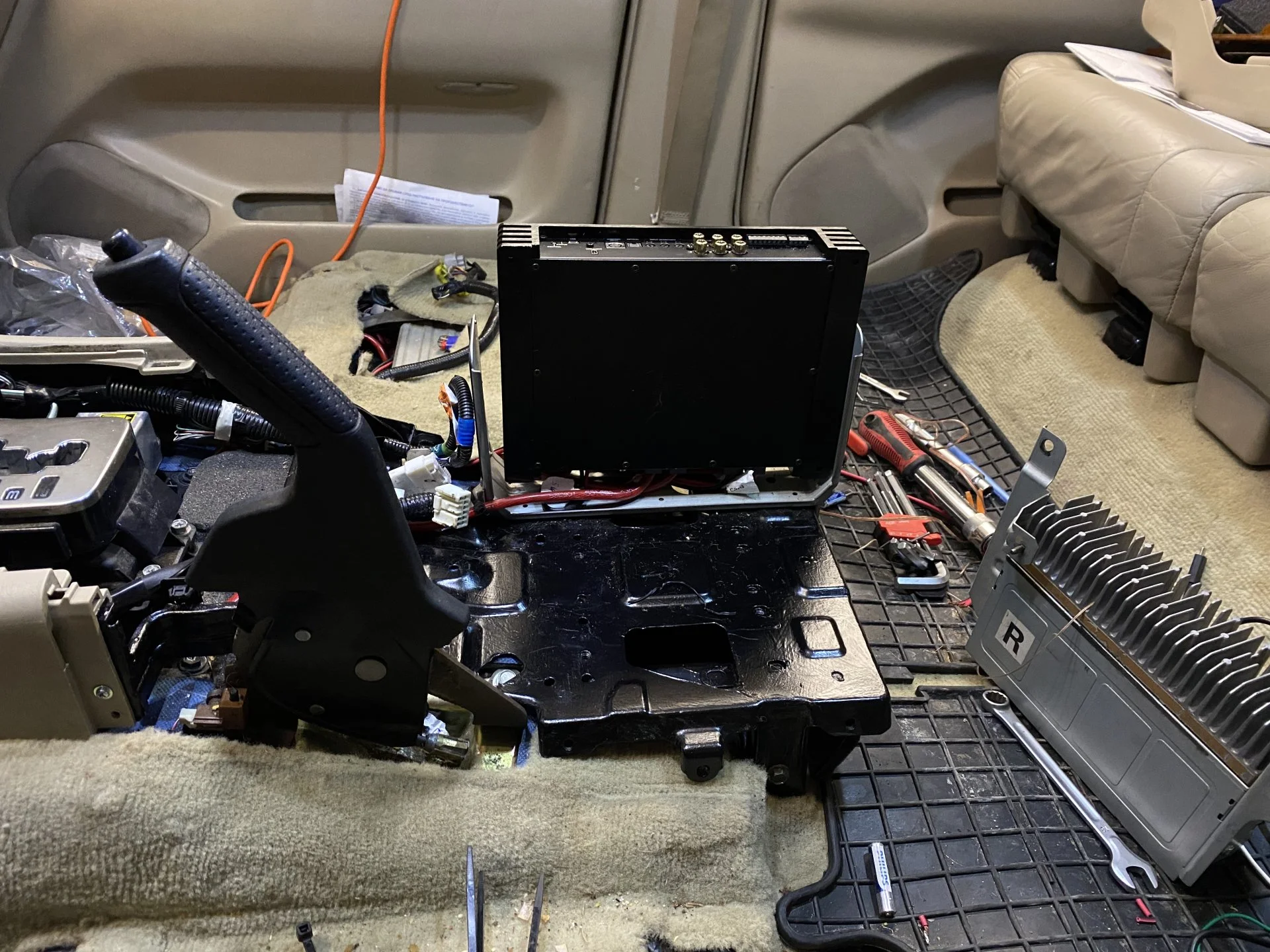

I went with the factory amp for the last 7 months until I finally caved in and went ahead and purchased this amp + DSP that I have been eyeing since I started looking into aftermarket speakers and amps.

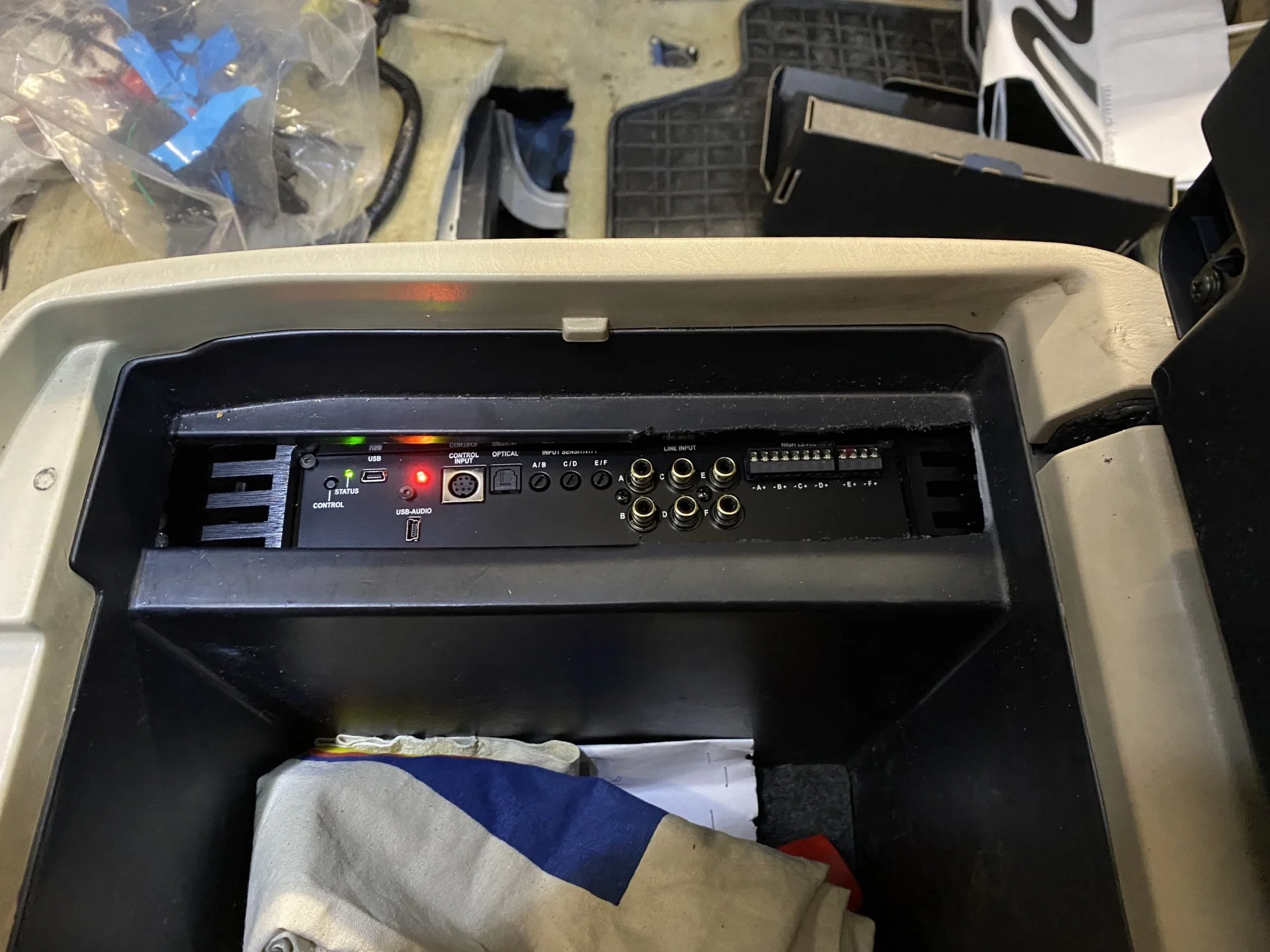

It fits beautifully in the armrest, replacing the factory CD changer.
Everything is easy to access and there is plenty of space around the amp, it occupies less than 50% of the void. I had some concerns of it overheating, with the transmission being right underneath, but so far in the winter weather that has not been an issue at all.
I also got a calibrated measurement mic to set things properly.
I am completely blown away! Everybody must do this!
If you have replaced your speakers and/or amp and think that you have made an improvement, you should really try an active system. It's almost as much an upgrade for the aftermarket speakers and amp, as they are for the factory system!
Properly tweaking the speaker delays and equalisation really brings the sound quality to another level. Much more vibrant and expansive sound.

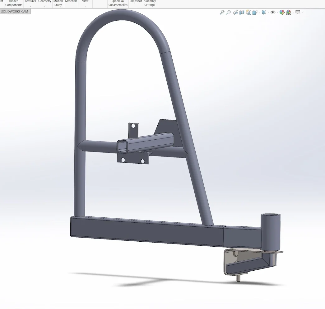

I shamelessly copied @clrussell design for a swing away carrier with stock bumper.
Then after some advice from my fabricator buddy I simplified it a bit and shed some weight (16kg projected vs 22kg). Also sized it so that I can potentially fit 2x 33" tires with very little rear visibility restriction and still having stop and turn signals visible.
I won't lie, the first one looks way better to me. But on the other hand it won't be visible with the tire on.
I will play some more with designs before committing to the laser.

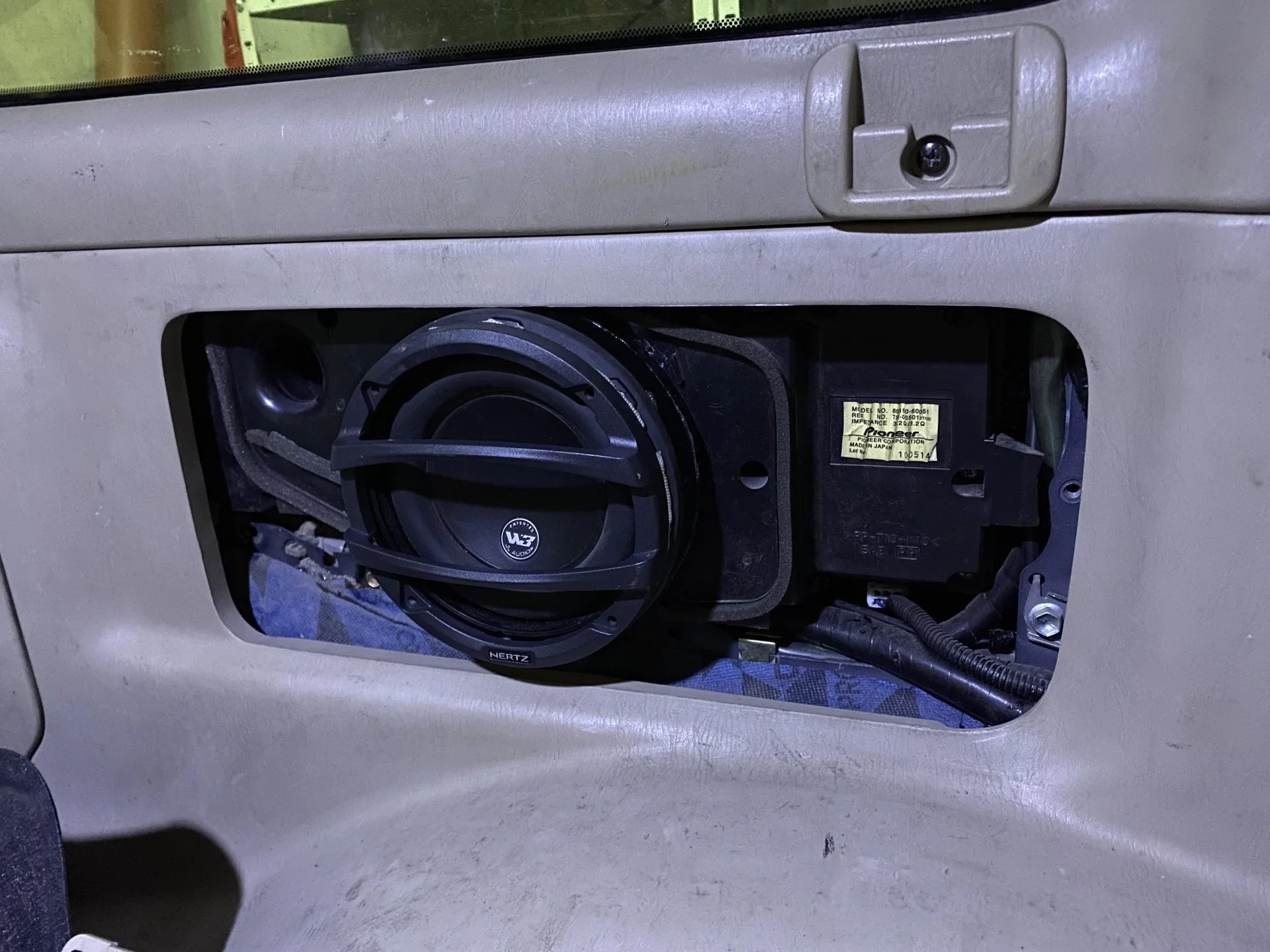

I also replaced the rear sub with the largest and lowest playing 6.5" I could find - KL Audio 6w3v3. I had to add about 40mm spacer so that it won't touch the bottom of the enclosure. I will also have to replace the stock mesh.
It starts booming right at 40Hz and I cut it at 80, where the Hertz in the doors take over. Unfortunately the stock enclosure (Pioneer for Europe instead of JBL) has very restrictive bass reflex, so I can't get it louder than 90-93dB, measured at the front seat, without heavy distortions :(

That looks great on both designs. Only Problem I see on the later one is how do you latch it? My latch is in a less than ideal spot anyway, (if my rig was 6” taller it would be so much better) that one would have to be behind the tire?
Awesome Build! I really like the galvanized zinc coating on the frame, definitely something I would like to do.
I like your tire carrier design. One thing I don't like on most tire carriers is the latch design. On most you have to reach down under a tire to open and close the latch.
I think it would be very nice to use a slam latch, like your doors and tailgate to keep them closed. You can then use a cable with handle to a convenient location to open them up.
Slam latch has its benefits and downfalls. My last swing out used the slam latch. It was very nice for closing it, but finicky opening and it was hard on fingers.

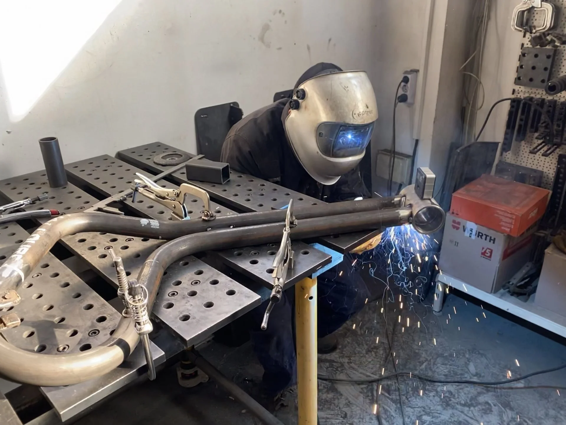

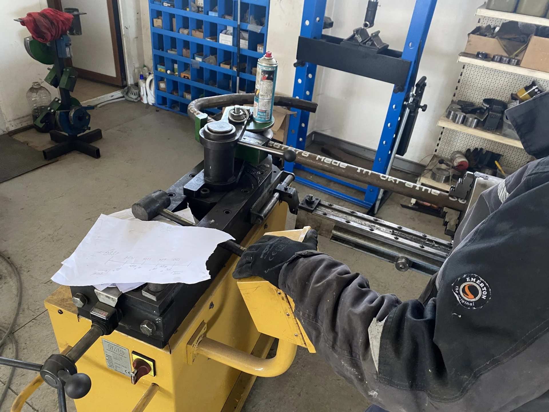

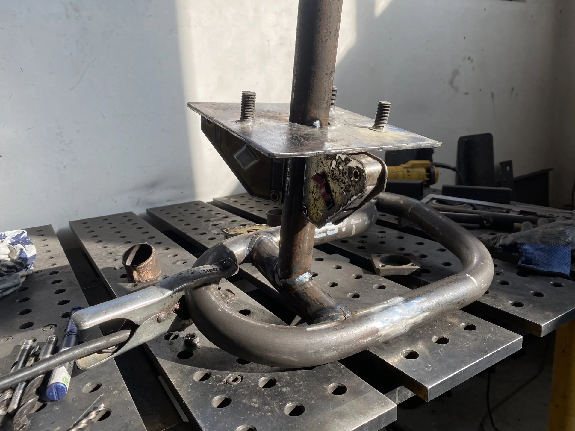

The press brake here can't bend 5mm well and the plasma CNC is out of service, so I had to order the bracket made and it took them 3 weeks! Lead times are ridiculous right now.

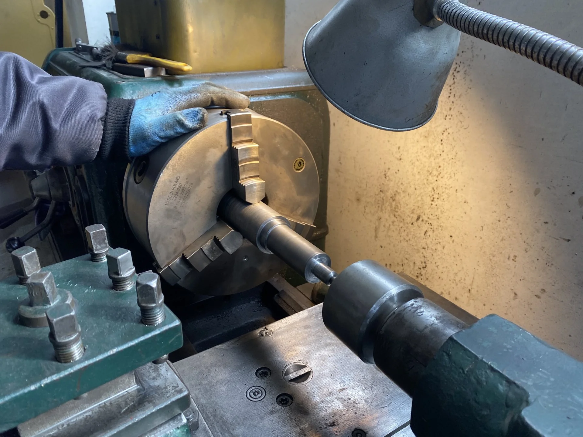

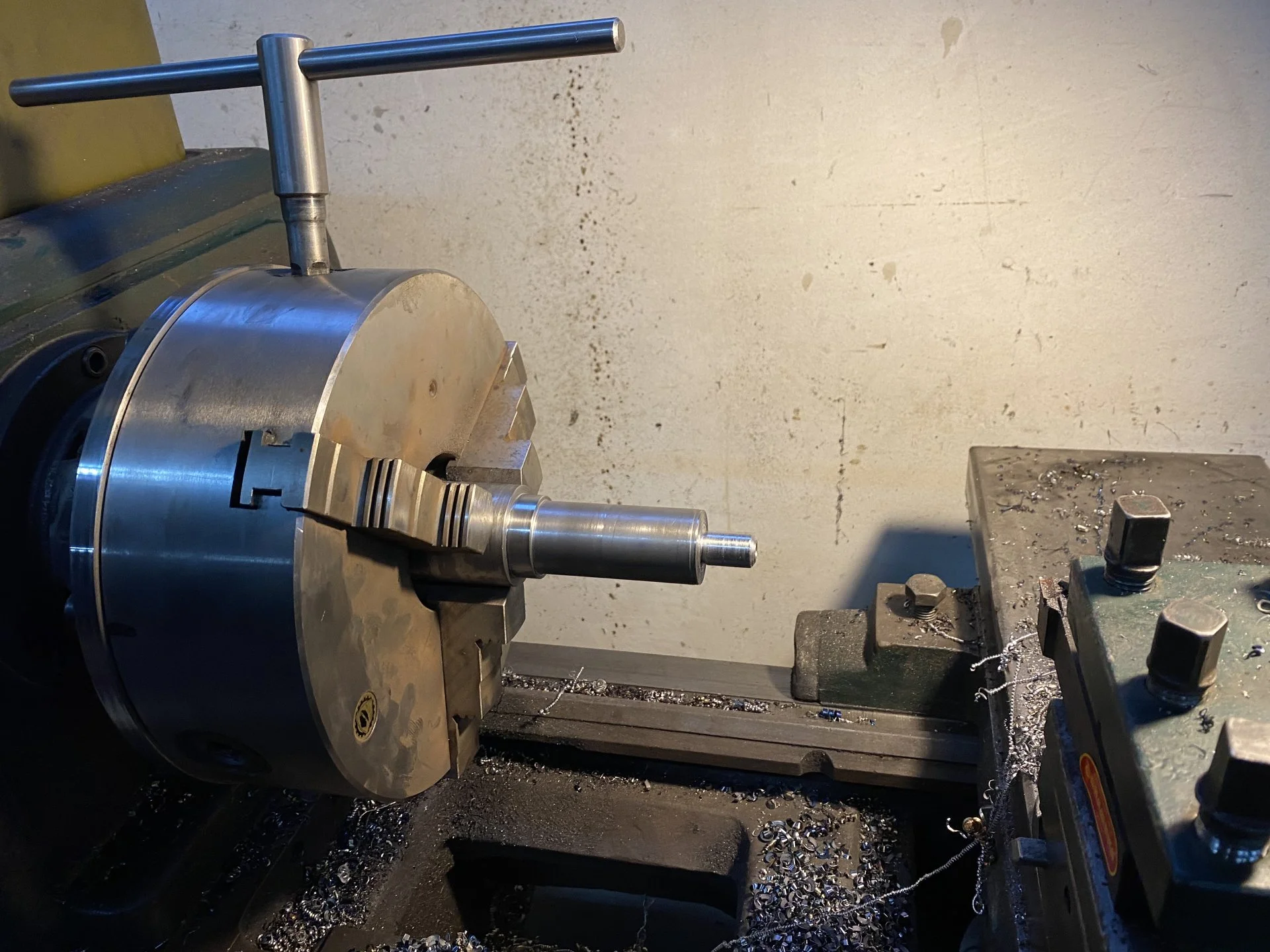

I started learning to work with the old school lathe
Next is the bearings shell
Up to 40% of the Bulgarian steel imports were from Russia and Ukraine. This is down to zero now. Last Friday generic sheet metal was 2.50BGN/kg. Tuesday it went up to 2.90 and this Friday it was 3.20/kg :( I think I should stockpile on materials for my upcoming projects...

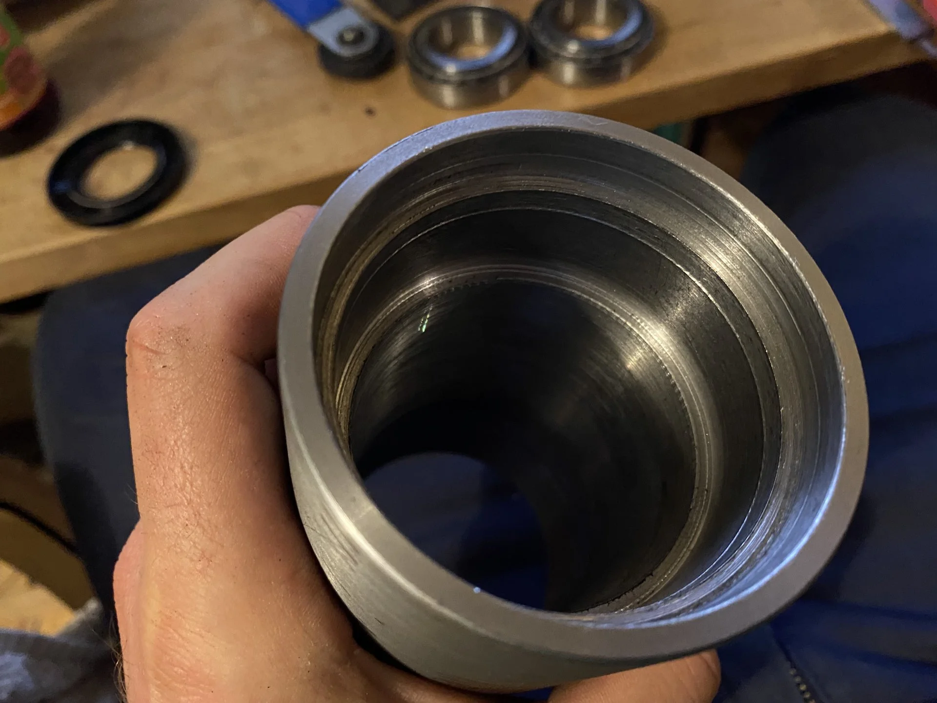

I machined the bearings shell out of 76x16mm piece of tube. 76x10 would have been ideal, but who knows when that would be available.
Not terrible, not great. The larger groove is for the oil seal at the bottom, the smaller one for the bearing race.
Made a mistake when writing the dimensions down on paper and had to re-machine the spindle so that the shell will sit a little bit lower.
My welds are improving. I used to weld like a second grader, now I have advanced at least to a third grader 😂 The only things I have ever welded were stuff for the car - rock sliders, underbody armor, winch plate, etc.
Test fitment looks good
Now that this is finally done and I can measure the true distances, the only thing left is to bend the tubes for the carrier itself. I am thinking to leave 40-45mm (~1.6") between the carrier and the rear hatch. Should I make the gap larger or would that be enough?
I am also wondering if I should make two carriers or just one? A second tyre will add ~120lb and it will be a real headache with lights visibility. On the other hand with only one spare, once you use it you have no spares...

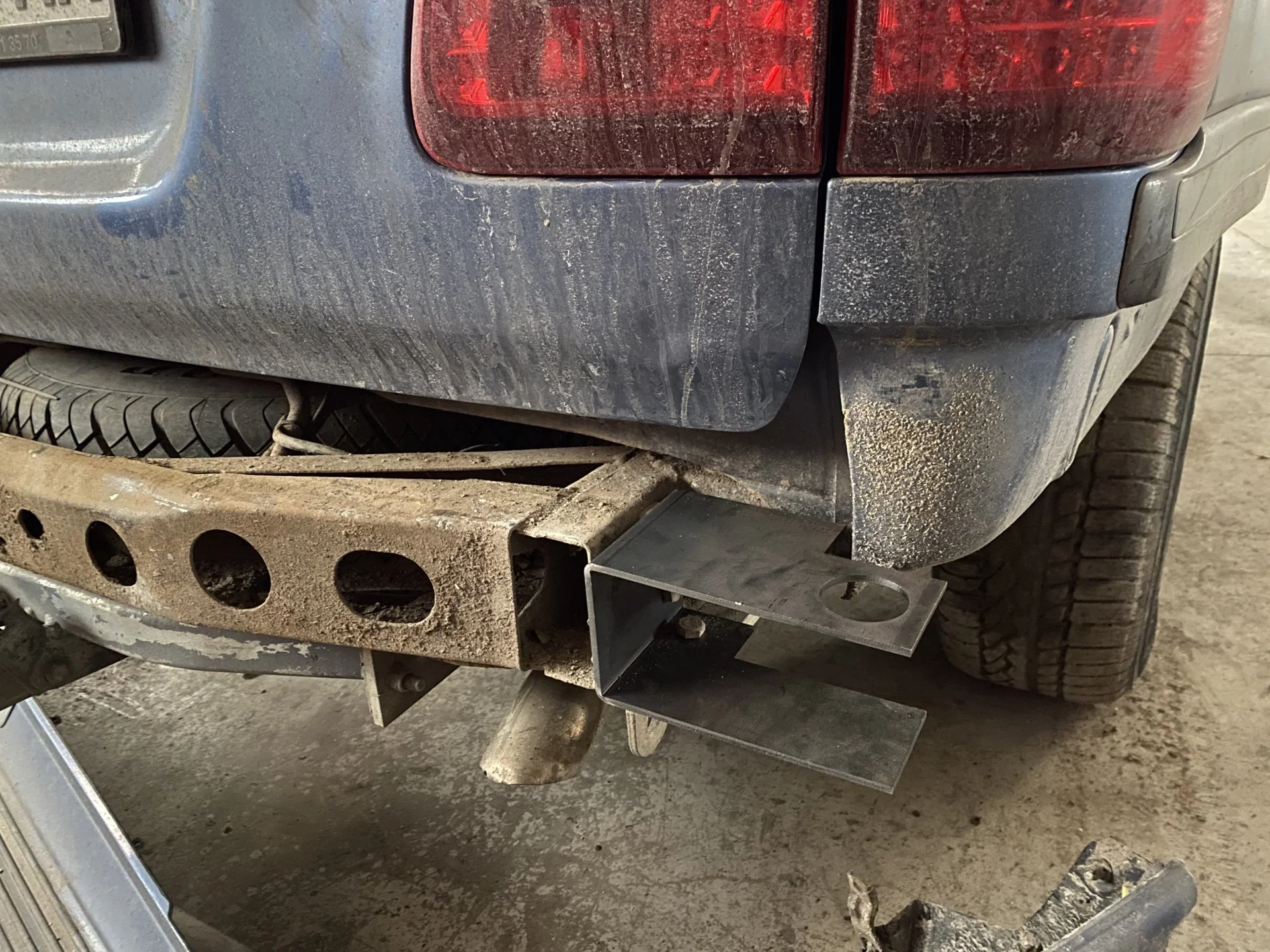

I think you're probably going to find that flexes quite a lot once you put an arm on it. It looks like it's just bolted to the side wall of the chassis? I think the design you were inspired by had gussets to a sturdy tow bar mount on the underside of the chassis as well which would stiffen it up a lot.
There is a sturdy 8mm tow bar bracket that is protruding horizontally underneath the chassis. My bracket rests on top of it and is bolted to it in addition to being bolted to the side of the chassis. I believe this will prevent any flex.

This is the European towbar brackets design
And the carrier sits like this. I will have to add a small piece between the bracket and the frame.

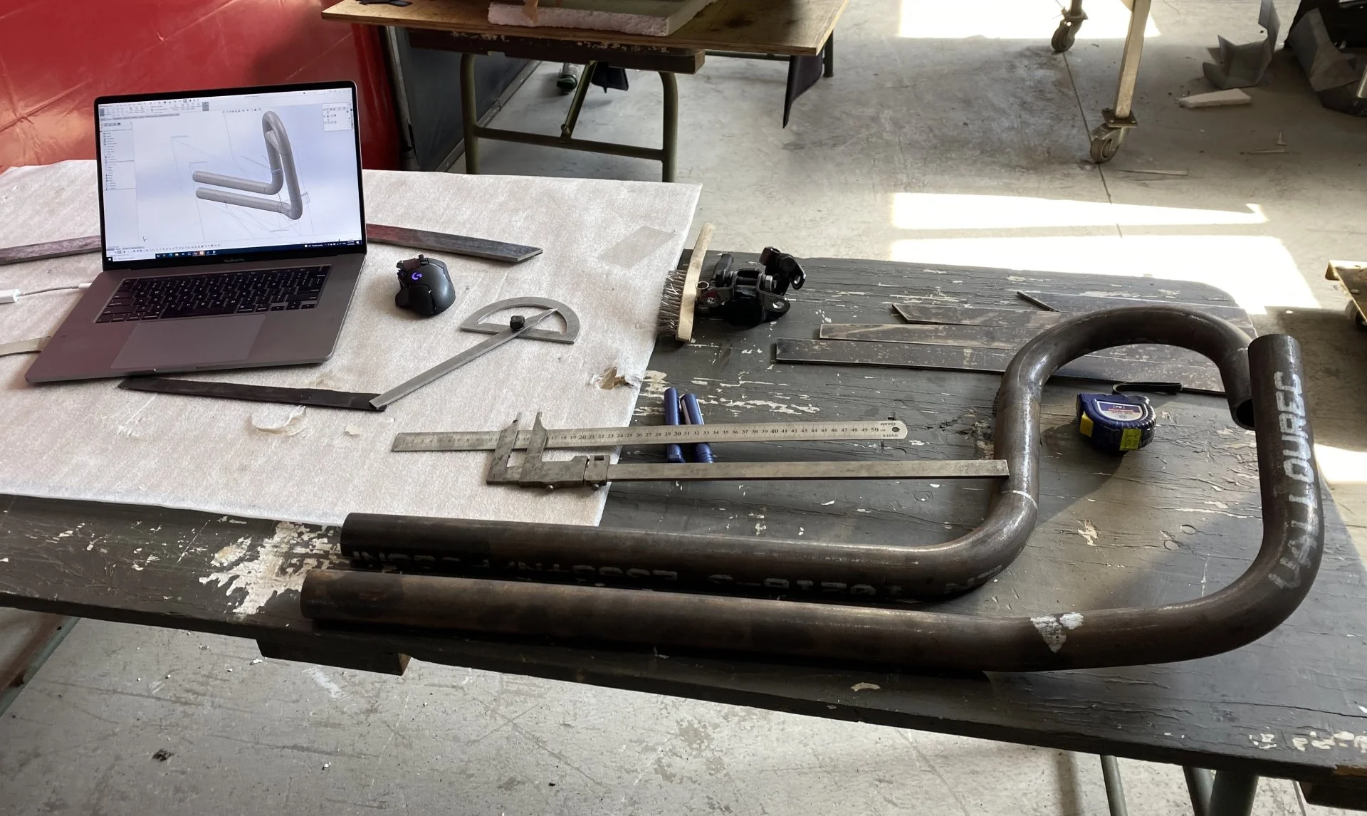

Ukrainian steel. Testing the spring back of the thicker tubing I was forced to use, due to availability here. Steel is getting harder to come by here, most yards are not publishing prices and quantities any more, as it is hard for them to keep them up to date.

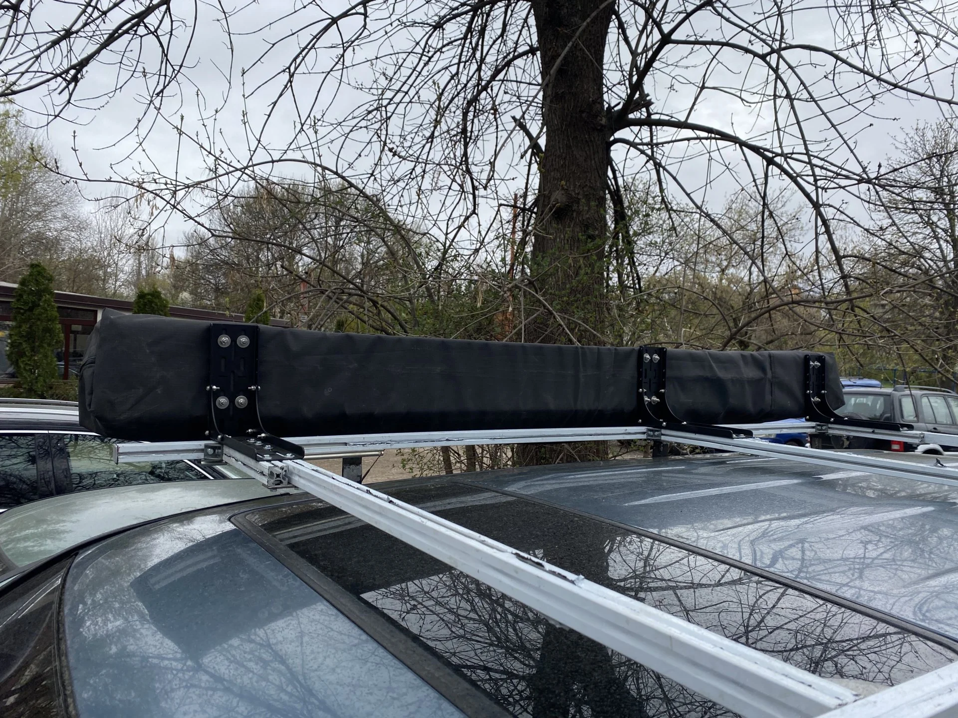

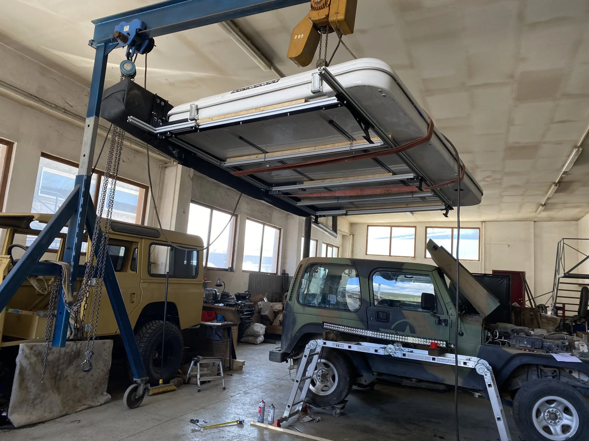

I built a new roof rack and installed the awning. It's absolutely massive! 12 sq m - 129 sq ft
I went with 30x30 mm extruded aluminium (8020). I will also finally be able to install the LED bar.
In hindsight, I should have gone with 35x35 or even 40x40, but that would have been 2x heavier and 2x more expensive.

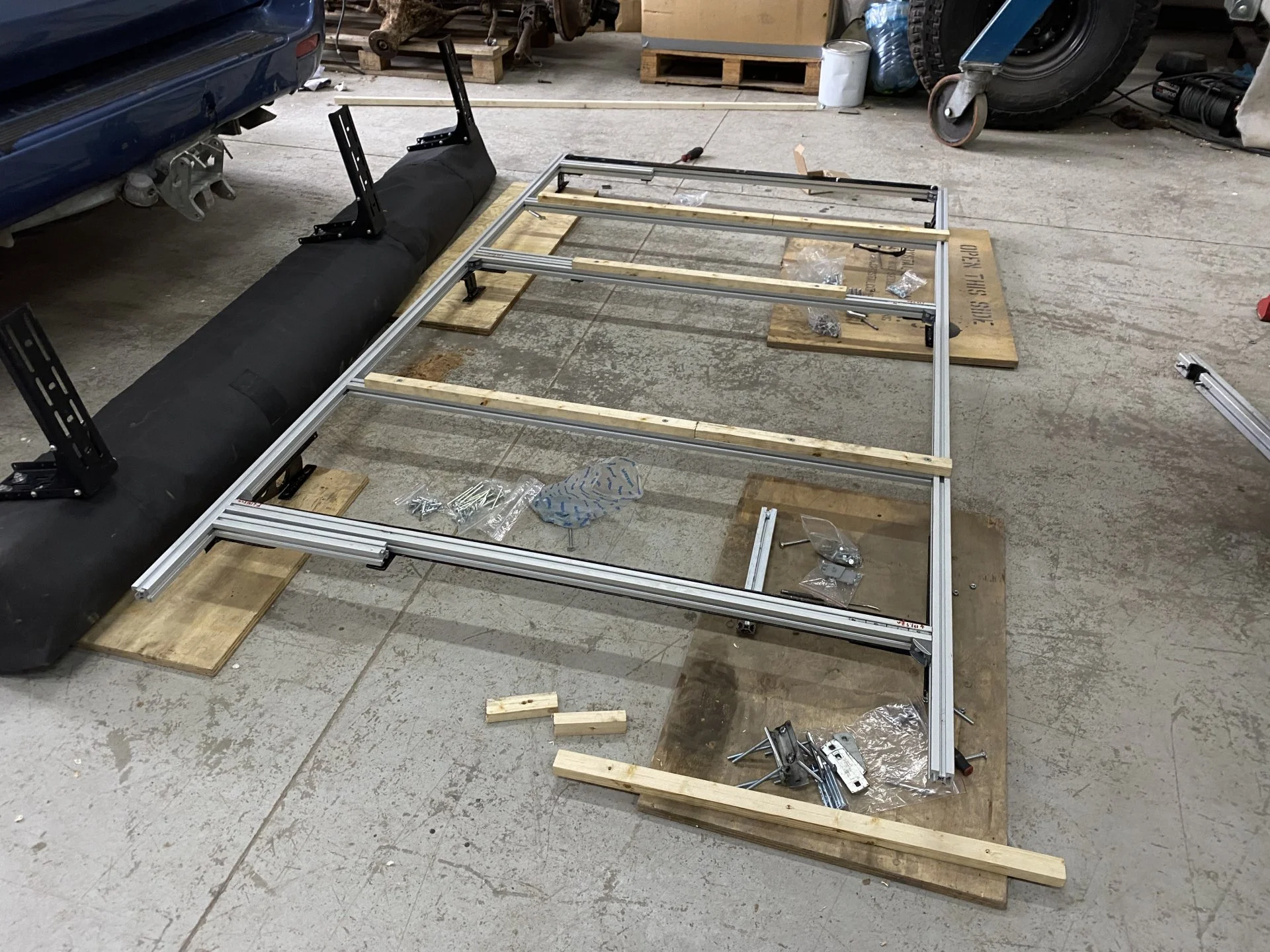

The roof and gutters are very curved. I hate building around curves. The gutters are sloped outwards of the car, the middle, behind the sunroof they are higher than the ends and they are not parallel - the front is 7cm wider than the rear...
I wanted the rack to be as wide as the middle part. Front of the body is wider and rear is narrower. I tried to align it with a laser, but wasn't really successful. It's very hard to get the laser mounted to a high enough point and aligned correctly with the car. All the curves do not help either.
Eventually I did it by measuring the offset between the rack and 3 points that are mirrored in both gutters - bolts and a bulge and made sure they are the same. I am using the calipers just as a probe.
Using a piece of profile I distanced it at 30mm from the highest point on the roof. Cars experience very dynamic forces and weight distributions, but there should be a reference level position
I could tweak the AHC until I got it perfect, but instead I just inflated and deflated tires until the front wheel arches were equal distance from the ground and the rear were equal, while also about 20mm higher than the front, which took me all of about 90 seconds 😃 This should be the default rake and a good reference position.
I wanted to place the 3 main beams on top of or as close, as possible to body attachment points for maximum support. The awning brackets will mount to the beams.
The CNC plasma is not working and workshops around are swamped with work, so I manually cut all brackets from scrap metal with a grinder and band saw.
Used 5mm for the bracket attaching to the rack.
Made some adjustable brackets with a slot to conform to all curves and slopes.
I should have used way thinner metal just to prototype this, instead once I have adjusted everything, I welded them together and filled in the slot with more weld 😅

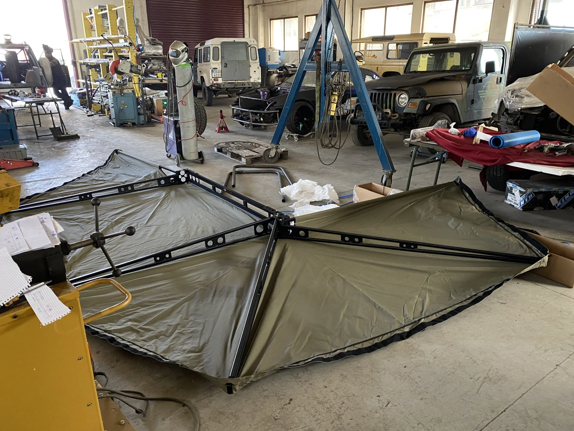

The awning brackets are pretty wide, so I added additional pieces, braced to the main beams
Load bearing test

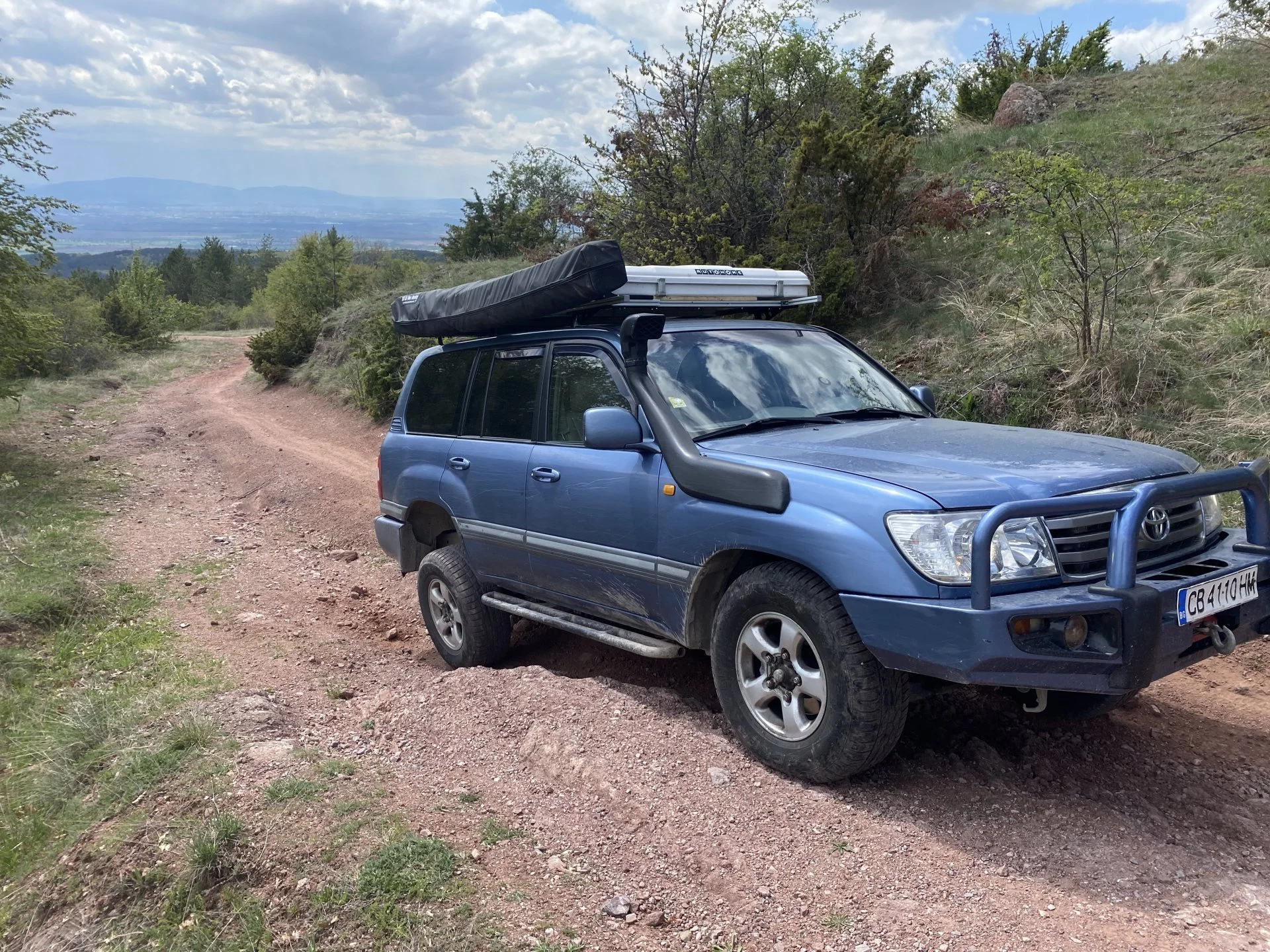

This awning is just gigantic. I should lower it to the level of the roof.
Next - painting the brackets and mounting the tent next to it. As mentioned, I wish I went with thicker aluminium, at least for the cross beams. When I pull on the end of the awning arms, the rack beams bend to a bow shape, especially the front one, as it is pretty far from the body bracket. The tent weight should probably offset that a bit, but I think I will bolt a piece of steel L bracket for stiffness there.
The roof is mostly done.

It's good for prototyping and if you don't have the option to weld aluminium or steel is too heavy. Dealing with all the 1 million fasteners (+/- a hundred thousand or so) is not fun. If you find out that you have to add a nut to the middle of a section you have to take everything apart. There are small nuts that can go through the channel, but they are tiny (the silver ones top left) and not suitable for heavy loads.
I would git gud with welding aluminium, rather than deal with this again.
This is the final construction. The awning brackets are wide, so there is a second piece of aluminium braced to the cross beam. The bracket is 20mm (18-19mm actual) high, so I had to lift the tent 20mm. Went with spruce planks that I cut & oiled with some cooking board oil that I had lying around. That way the tent aso sits on a softer surface, instead of on metal.
I have left some horns in front while I figure out the LED bar attachment.
I also added 3mm steel L angle on the first and last crossbeam, where all the force from the awning beams is directly transferred. They were flexing a lot. 40mm aluminium bars would have been a lot stronger, but they are 2x heavier (2kg/m vs 1kg/m). The L angle helped a lot, but did not fully solve it. Resting the tent on top pretty much eliminated it. It also made the awning a lot stiffer.
There is no visible flex in any of the other beams. If aluminium hadn't gotten so damn expensive (290-310% compared to 2021 here) I might have replaced the outer 2 beams with 40mm
Final weight - ~20kg (44lb) - 10.5kg aluminium, 4kg steel angles, ~1kg fasteners, 3-4kg brackets. ??kg wood
The awning brackets go under the tent, which is attached to the bottom of the roof rack, which makes it one unit. 0 points for practicality :)
I also added plastic caps for the channels. Can't say I noticed any sound difference with the tent and awning on, but it will keep the dirt out.
Lots of wind noise with the sunroof opened, but the tent covers it, so I can't use it anyway. When it's closed it's barely audible. I certainly am glad that I added so much noise absorbing material to the roof, even to the sun shade.
Noise picks up a lot more above 120kmph/75mph (87mph legal max), but once I put the 33" M/Ts back on fuel consumption will pick up faster, so it isn't too much of a concern :D
Pretty cool though
