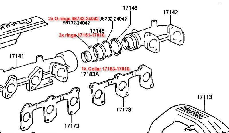

my exhaust manifold has a bit of a leak where the two halves join
the fsm shows "manifold rings"
is this something that can be fixed? or do I need new manifold rings? 'cuz I don't know if can get those and don't want to be stuck with the manifold apart.
put differently: how the heck do I fix an exhaust leak that starts at the junction to the 2 parts of the manifold?
side note: Why the heck did Mr. T do a 2-part manifold?!? seems like a totally un-necessary added complication.
Here are the part numbers. They are available, have replaced many when we have manifolds ceramic coated.
No idea why Toyota made a 2 piece set up. 12H-T has 2 piece manifold too.
If your local Toyota can't get em in I would check with Dave at japan4x4.com
Or even Ens Lexus Toyota up here in Canada if all else fails.

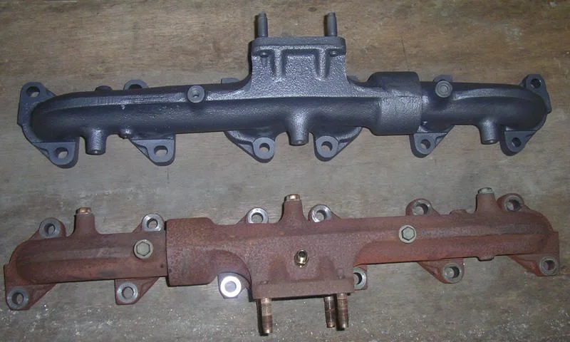

ceramic coating
wish that were an option for me right now
anyone painted an exhaust mani with hi temp paint? I have a can that claims 1500*F
Don't know if it is true, but seems like the cast iron shouldn't ever get that hot- even if your EGTs spike to 1500 for a spell, it takes a while to change the temp of the manifold and it is always surrounded by air that is less than 400* in the engine compartment, and the block should also be less than 500 at all time, right?
thoughts?
Don't waste your time or money on paint.
In my experience ceramic is the only thing that will stay on the exhaust manifold.

I've always assumed the two piece design was to allow the manifold to grow and compress due to heat cycles...
