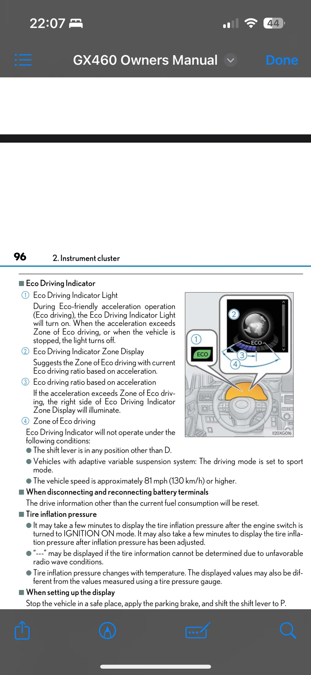

Per my 2022’s owner manual, the light is indeed only there to indicate when you’re driving “economically”. There’s no real eco mode, so no throttle or shift changes. The only way to really have a “drive mode” is if you have the Luxury trim with the adaptive variable suspension.

Per my 2022’s owner manual, the light is indeed only there to indicate when you’re driving “economically”. There’s no real eco mode, so no throttle or shift changes. The only way to really have a “drive mode” is if you have the Luxury trim with the adaptive variable suspension.View attachment 3736266
My manual, as i mentioned earlier, "SAYS" the same thing. In practice NONE of that happens. Not only does the light NOT shut off/turn on according to how I drive (stays only always, and I am always punching it), but more importantly, regards of what it says, I'm relaying real world experience. I personally felt the truck become much more responsive to throttle input
