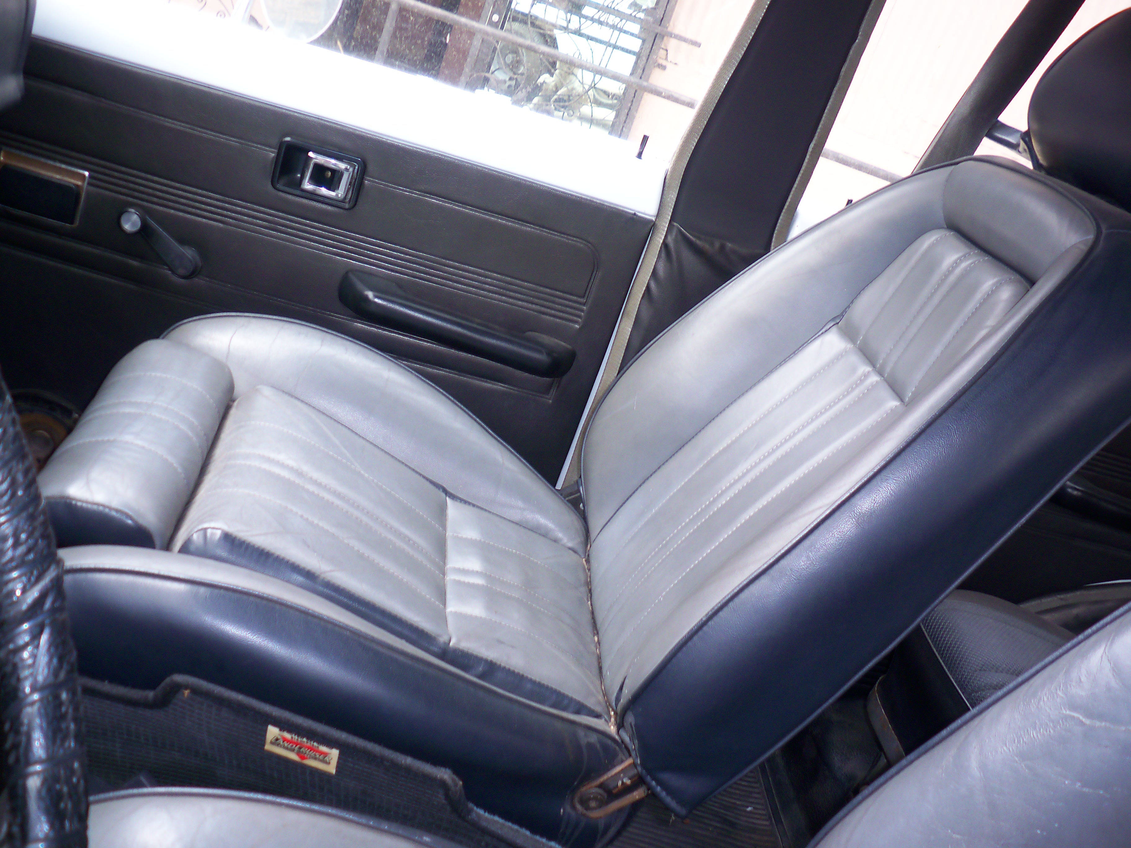

The buckets that were in my Pig when I bought it. To be replaced in the near future... don't know if these will help or not but thought i would offer.

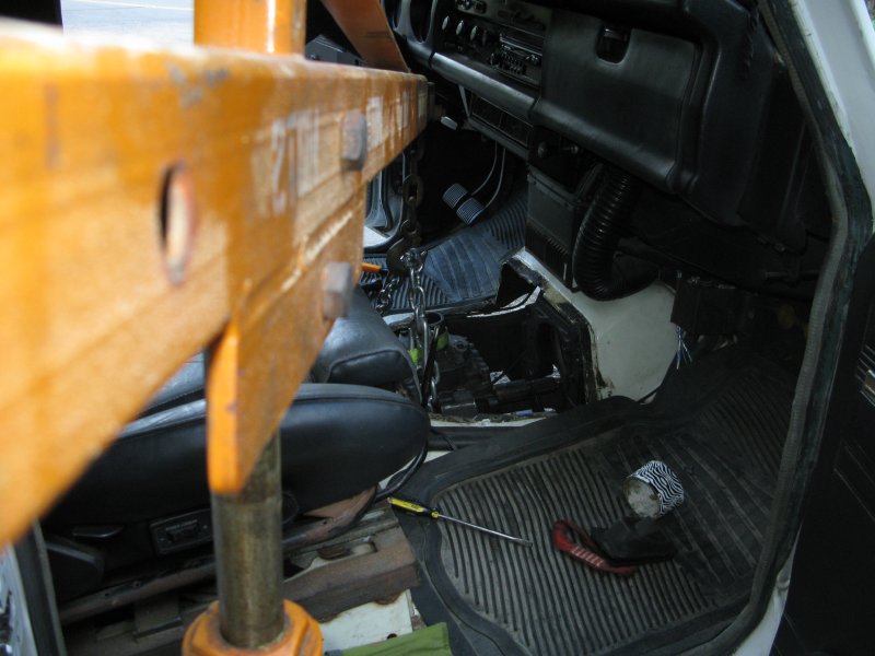

Hey snowpig... I like the seats and I might be interested, but more importantly, were you changing a clutch? If so, does the engine hoist through the tranny shifter cover area work well?
I need to replace as throwout bearing and that method was suggested. Does it really work???
Thanks,
T
that's the way i've always done it...by far the easiest way
2x- It's a one man/ woman job this way. Replace each bolt that holds the trans to the bh with a dowel, and slide it right off and back on.
How many bolts hold tranny to bellhousing, and how do i best access them.

do they make dowels that long? here's my sst
The bolts that hold a steering box on a 60, work great as dowels. I simply cut the bolt head off and make a notch in the top that allows a flat head screw driver to screw it in and out.
