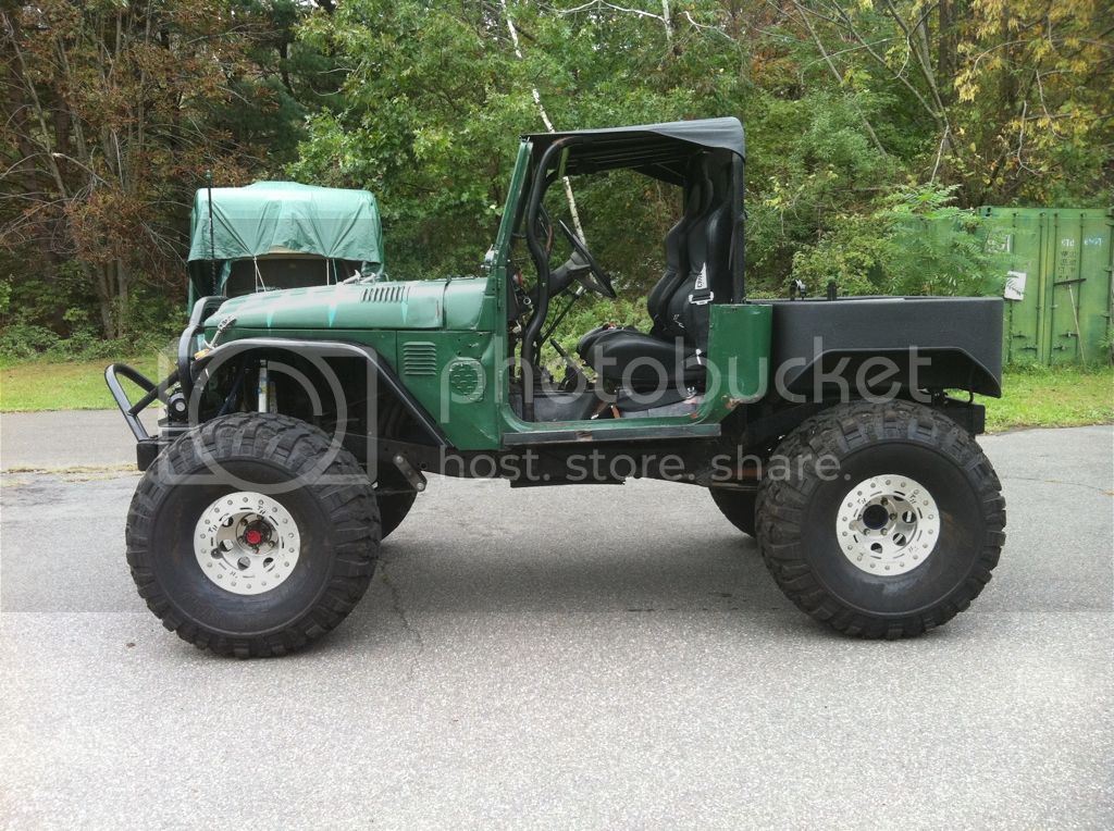

I bought two new 40 springs, cut off the front hangers, fabbed up some new hangers, moved the hanger up 3in. ,flipped the springs to get 3 more in.ordered ford shock towers from ford, ordered bistein 5125 14" travel shocks, after fitment going to see how long i need my shackles to be. should be at 103in when complete, prolly wont be finished by sunday

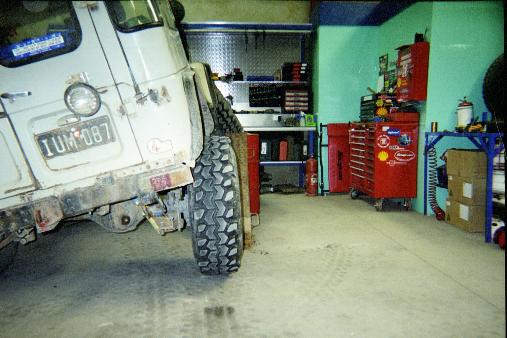

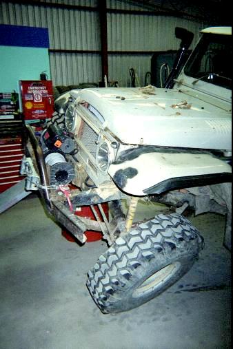

Back in 99 I used 60 springs and redrilled the centre bolt holes to get 98" wb. We cut and tubbed the rear with no body lift, and lifted and made the fronts from 2 fenders to cover 38" tyres with 3" lift.
swapped the shackles on the front using rear of front hangers to the front, and turned up bushes that I welded into the chassis so it was like a hilux on the rear shackle of the front springs.
On the rear I used later big bush 40 shackle fittings rotating the rears 180 degree, and moved the rear upper shock mounts to the rear of the round crossmember.

yep did the shackle reversal and moved the spring hangers forward two inches and measured and got 102 " center to center, nice

Well heres the first pict, Came out good but when i flipped the springs and moved the axle forward the pin is on the upward side of the spring and the diff is now pointed down more than i like, I might have to do a cut and turn again, Ill get some picts of this tomorrow
