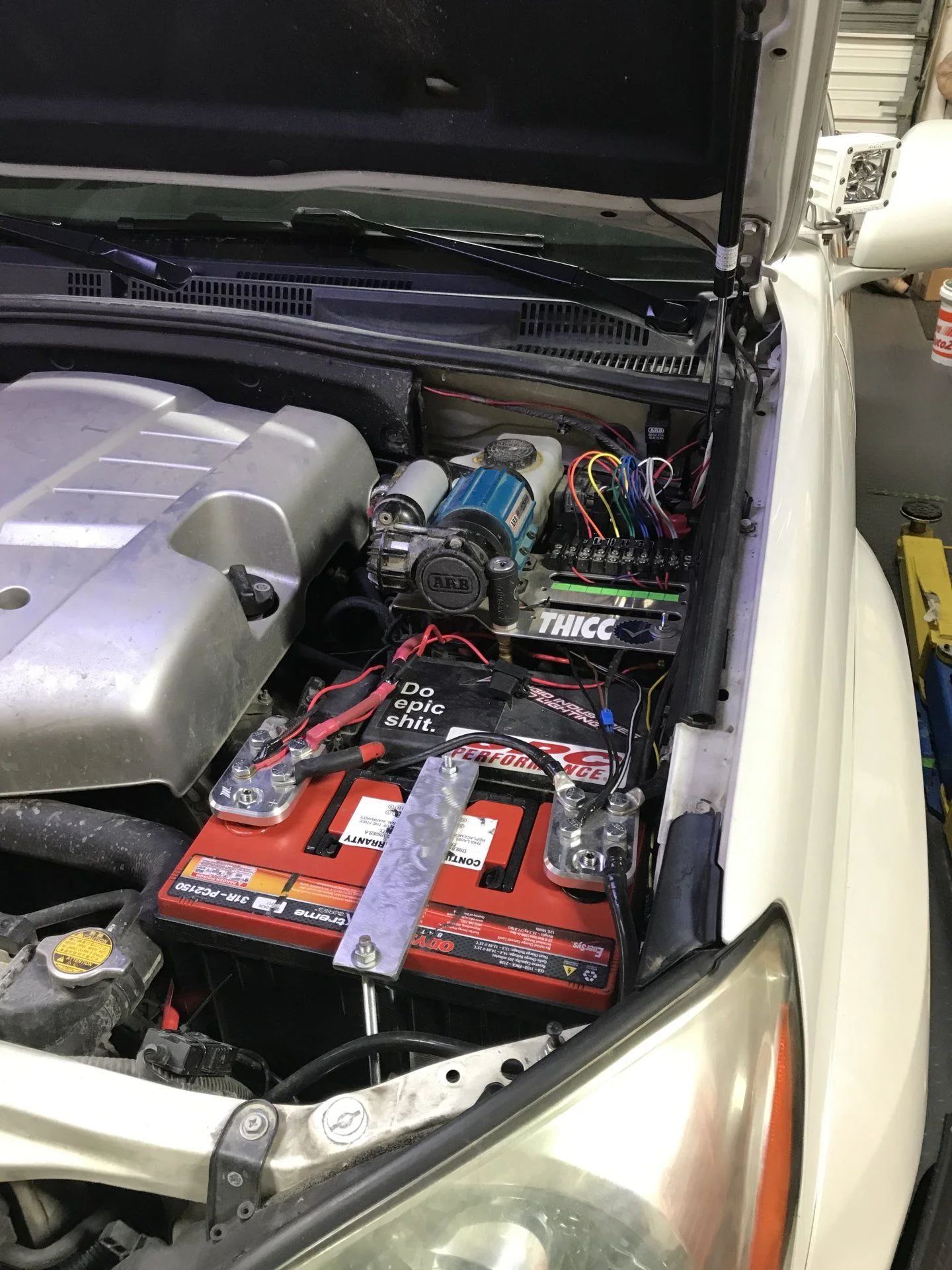

I was able to fit a Die Hard Platinum in there. Tight fight but I'd rather do that than a dual battery set up

Did you have to modify the bracket at all or just squeeze it in?
I just squeezed 'er in. If I remember right, I had to get a longer J bolt to hold it one side down.

You’ll need to fab or buy a different battery tie down but it fits good enough.

I used a BATTERIES PLUS X2 Power, deep cycle, off road battery. It has 960 CCA and a 5 year warranty. Pricey but I am very happy with it. Also, it's very heavy... possibly over 60lbs.
FYI: I only went from the stock 24 up to the larger 27 and it was also tight but slipped in without any modifications to the box or J brackets. So not a 31 as discussed in this thread but I am sure they carry in a Group 31..
