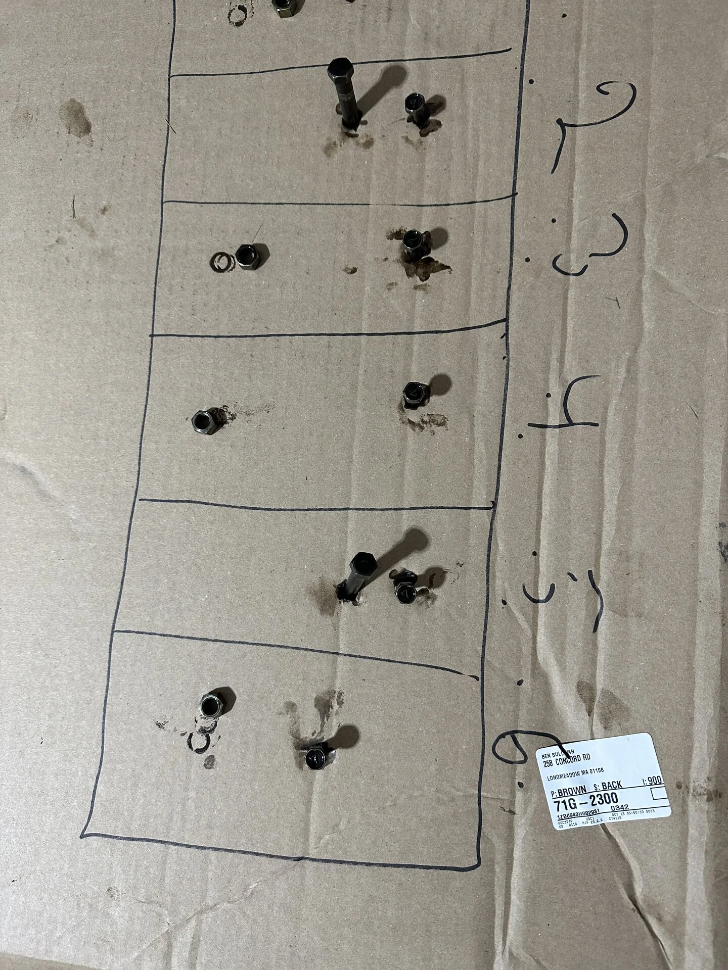

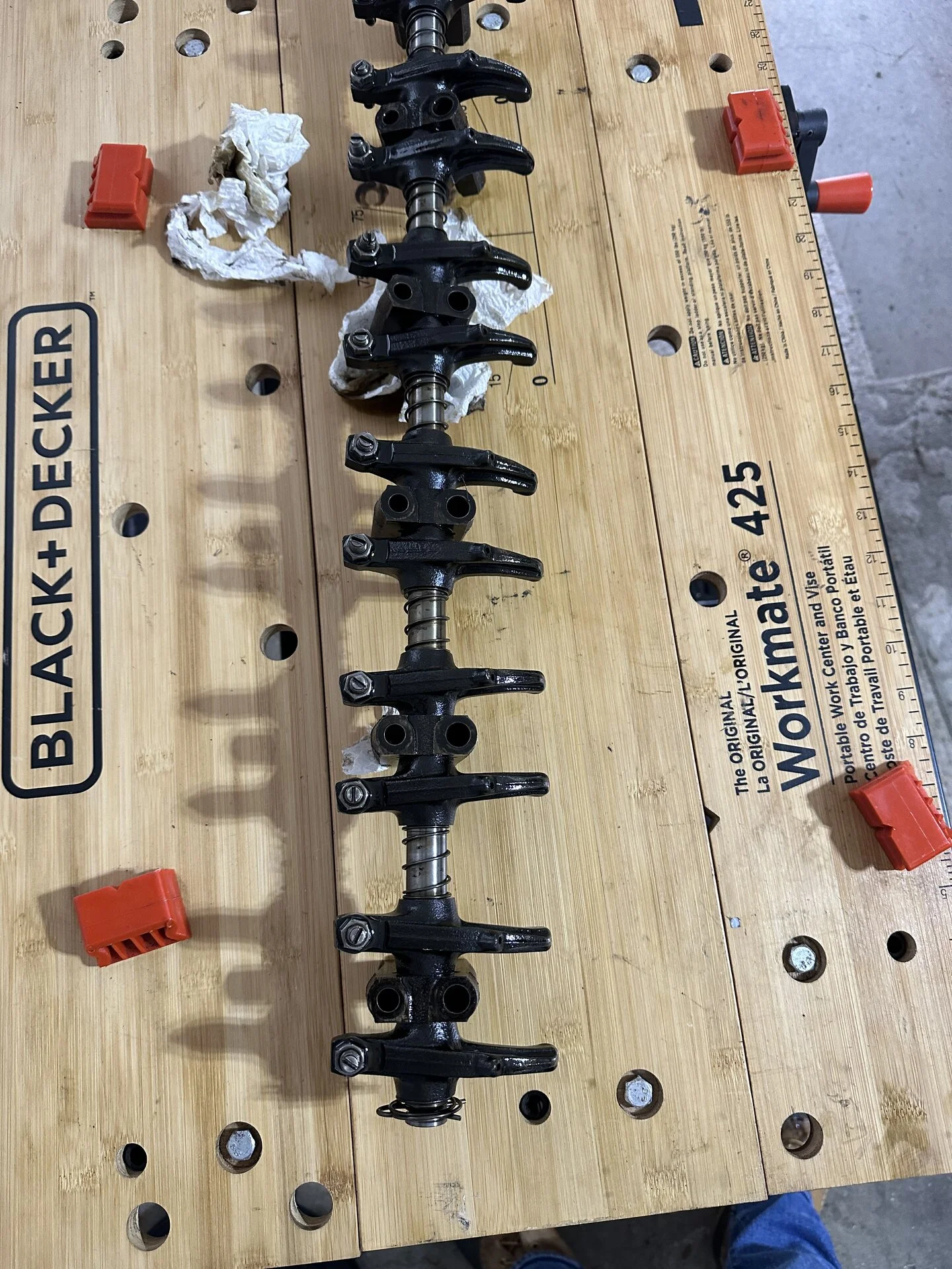

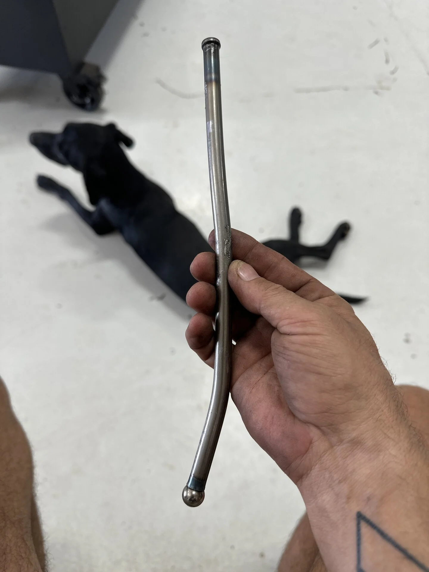

Ok - the tick is gone.
pulled the valve rocker assembly and pulled/replaced the push rods. One “might” have had a slight wobble or I was looking for bending wobble and saw it.
I also tries something I had previously not done…..cold adjusted the valves(0.010/0.016). Took all the time I needed, adjusted, rotsted 360, adjusted, rotated 360…..
Took it for a long drive and its better than I’ve ever had it set previously.
Was it push rod, was it valve…..who the hell knows. It’s gone and I’m happy.
thanks for the advice given above.
PS - i will go back and warm adjust valves but if I don’t get out and rake the leaves my wife will set the Cruiser on fire.
Adding a beauty shot,.
Also, if your ever pull your valve rocker assembly, use the larger bolt at #2 cylinder to align the shaft oil passage otherwise it wont seat properly…..you will realize if it isn’t aligned if it won’t seat but it took be a bit to realize why it was stuck and not dropping down
