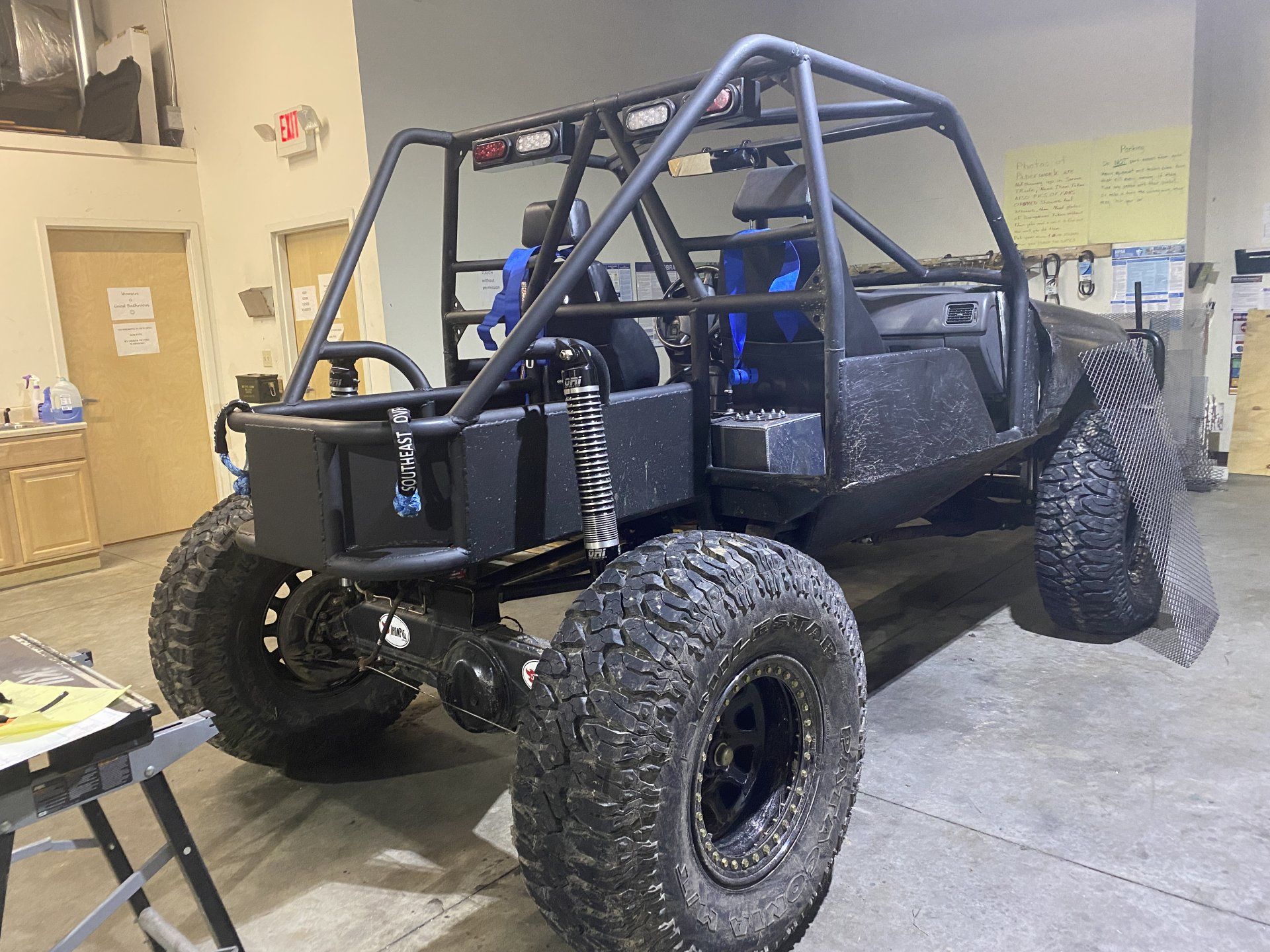

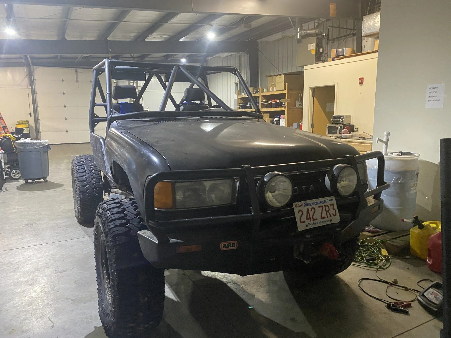

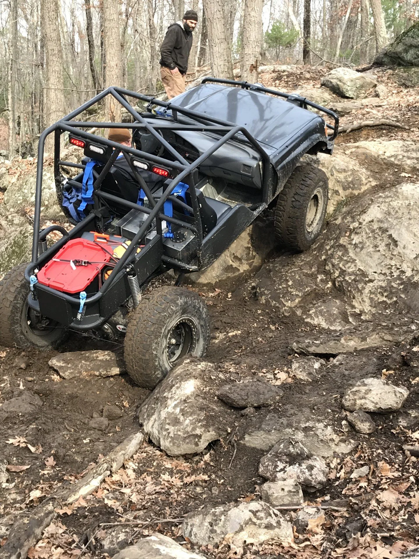

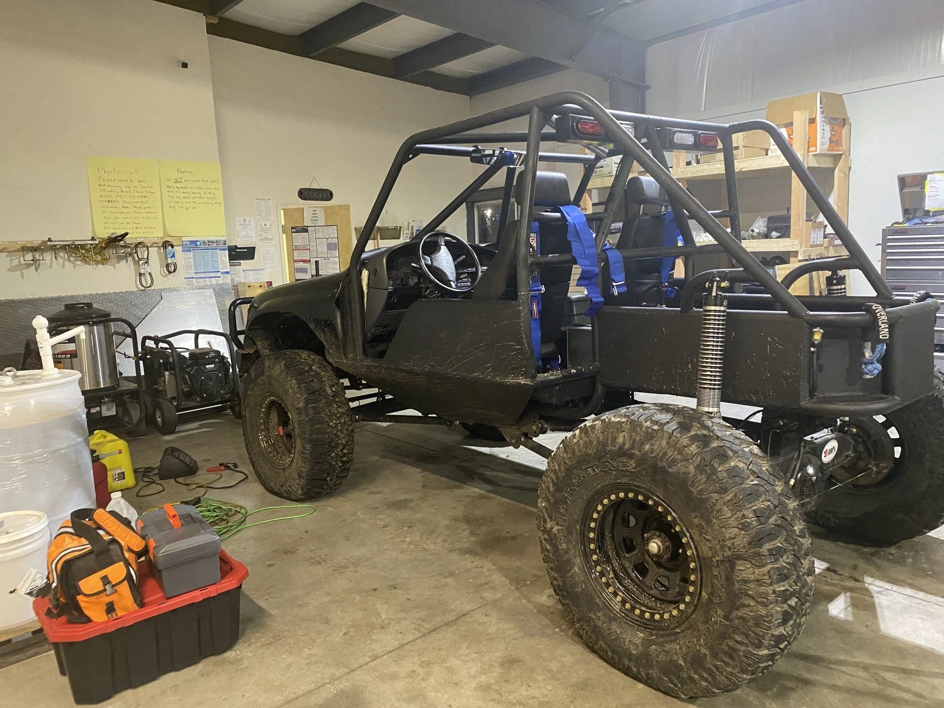

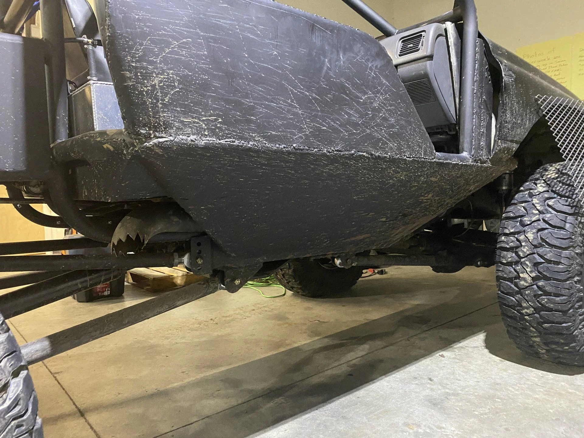

Here are a couple of pictures. Most of the fab work was done by me at Iron Pig Off Road. I am good friends with Lance. We built this in 25 days off and on over last summer. Our goal was to make the Yankee Toys Fall Gathering on Columbus day weekend in October. We made it to the event truck was about 85% don't at that point. I plan on doing a build thread but here are some teasers. Started as a 93 Landcruiser:
Triangulated 4 link in rear
Three linked front.
4.88 with Harrop ELockers
38 black label stickies Patagonias, Build was originally designed for 40's but could not find a set to buy last september.
16" ORI's
