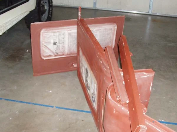

I took apart the top this year to paint it properly and prevent against rust. I sealed the underside where it meets with the tub with bedliner. I primed and sanded the pieces and a friend shot it with Cyngus white. I used Garage door seal for the top cap seal and sealed the seams with 25 year clear silicone caulk. I sealed the gutter really good with paintable silicone caulk and I painted the cap with roll on krylon brilliant high gloss white with a foam roller. It was a bitch getting it all back together but I think it looks great. Kinda wish I would have done the doors at the same time. I am going to paint the whole rig next summer and POR 15 the frame and shoot the wheel wells with bedliner. The paint job for the top cost $175.00 including the paint. The krylon was about $12.00 , The seal was $15.00 and the caulk was $10.00. So for about $212.00 I have a great looking top.

I used a foam roller , the tightest pores I could find. I did three coats and I didn't see any marks. It is kind of a textured finish not completely smooth and glossy. The headliner I went to home depot and got a couple yards of short pile indoor/outdoor carpet without a very heavy backing (less weight)
