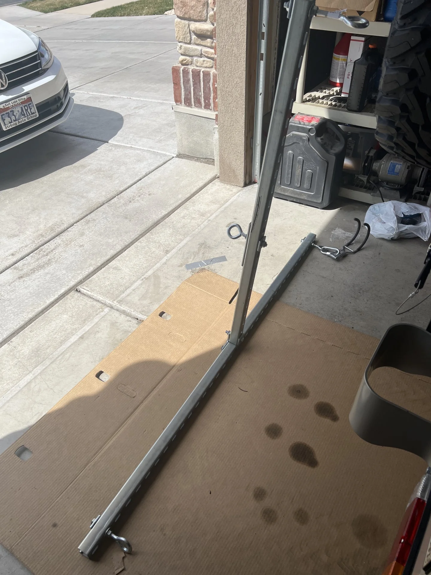

I made the unistrut into a “t” using unistrut hardware. I put 3 Rubbermaid hooks on the “t” attached with an eye bolt, one for the back of the hardtop and 2 for each side. Once I got it balanced correctly on the hoist hook it worked great. I only have one of the hooks on it in this pic as the others are being used for yard tools 😃

This is awesome. I can see how it all comes together. I even have those exact rubber hooks funny enough. Using them you don't have to wrap the unistruts in something some either.
I really appreciate it. I am going to attempt the same.
