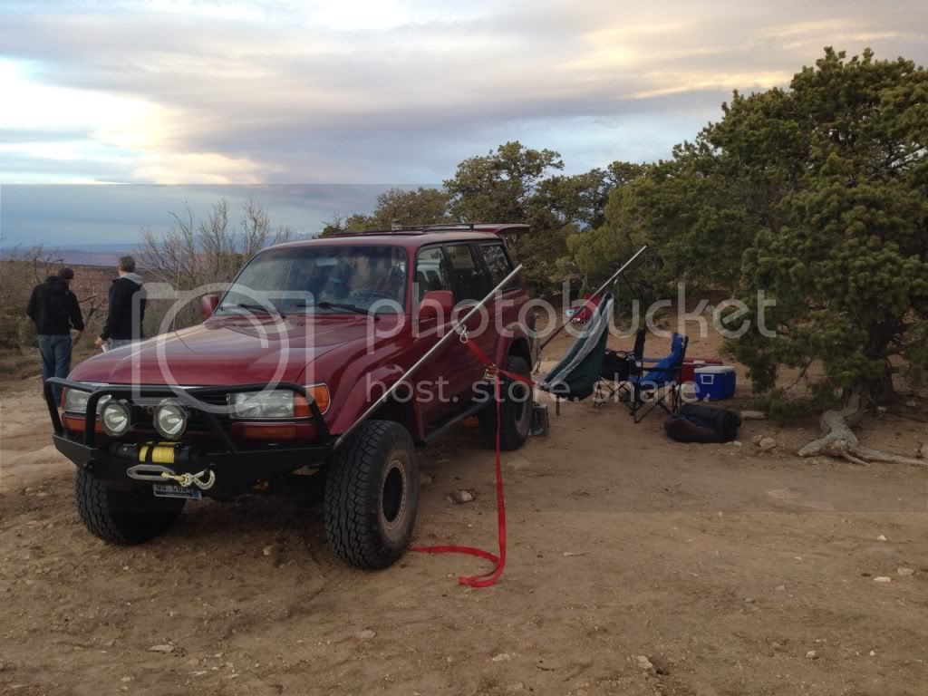

This was what we usually did, however since moving to Utah and having trees has become more rare; we have had to be more creative. I am in the process of fabricating a pull-pal with a couple loops on the top and bottom when its dug in. Then welding a D-ring to the back of a shovel (which will slide down through the pull-pal loops). Adding a couple more D-rings welded to the top/front bar of the ARB should yield a pretty awesome hammock setup anywhere. Couple that with a Kelty Noah's Tarp, and you can be made in the shade where ever you want.
Guess I better jump in here...
Trees? We don't need no stinking trees!
I spent 8 of the 10 nights in my hammock in Baja, it was kick a$$!
On the 80 I had them built into the custom bumpers.

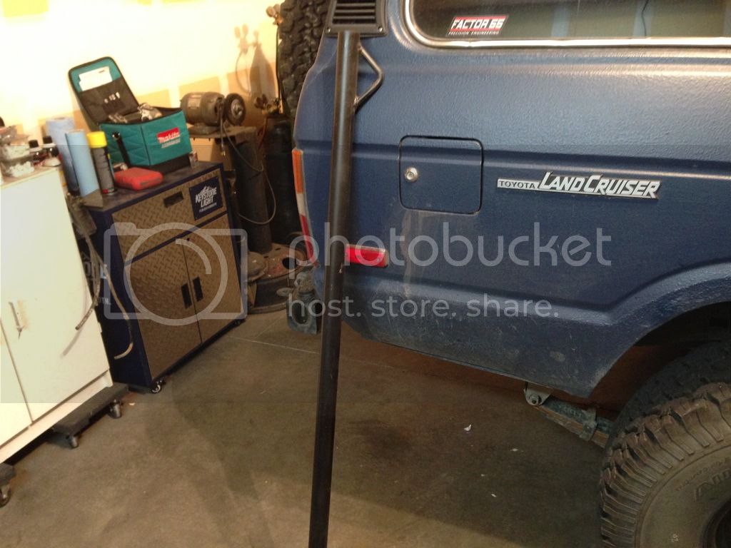

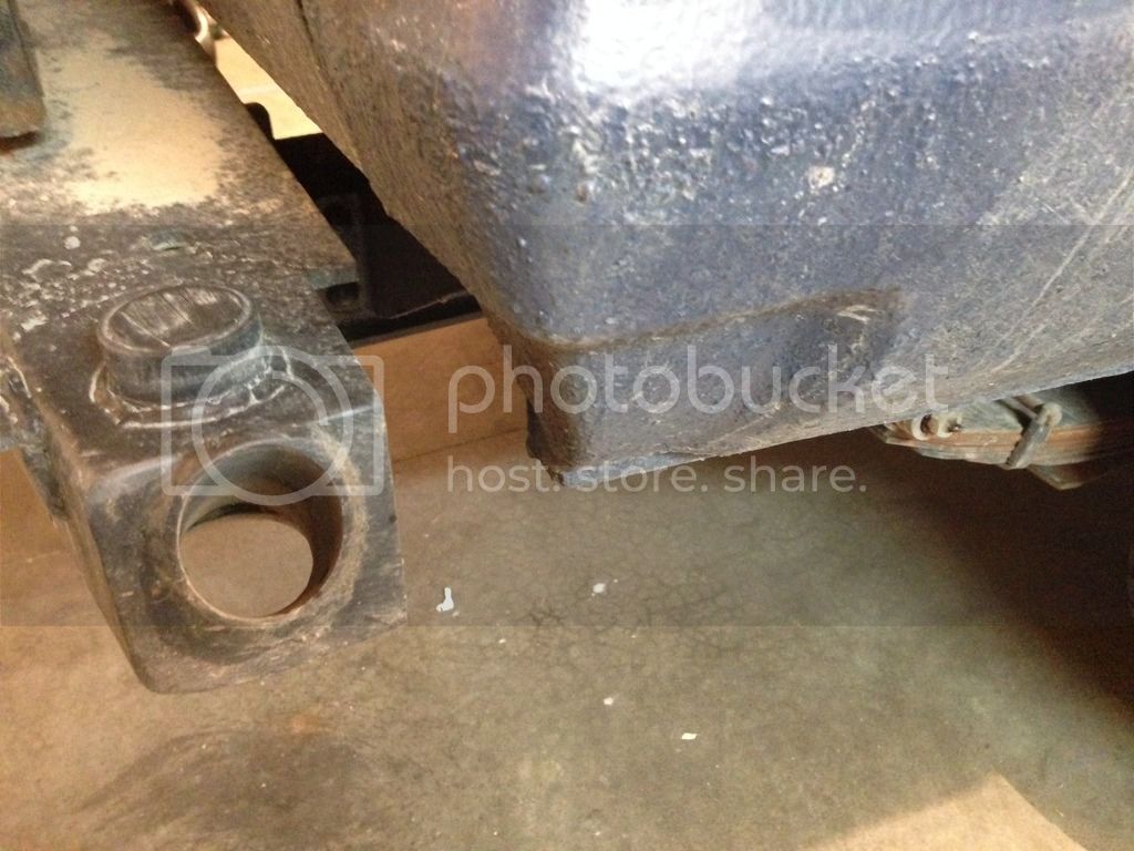

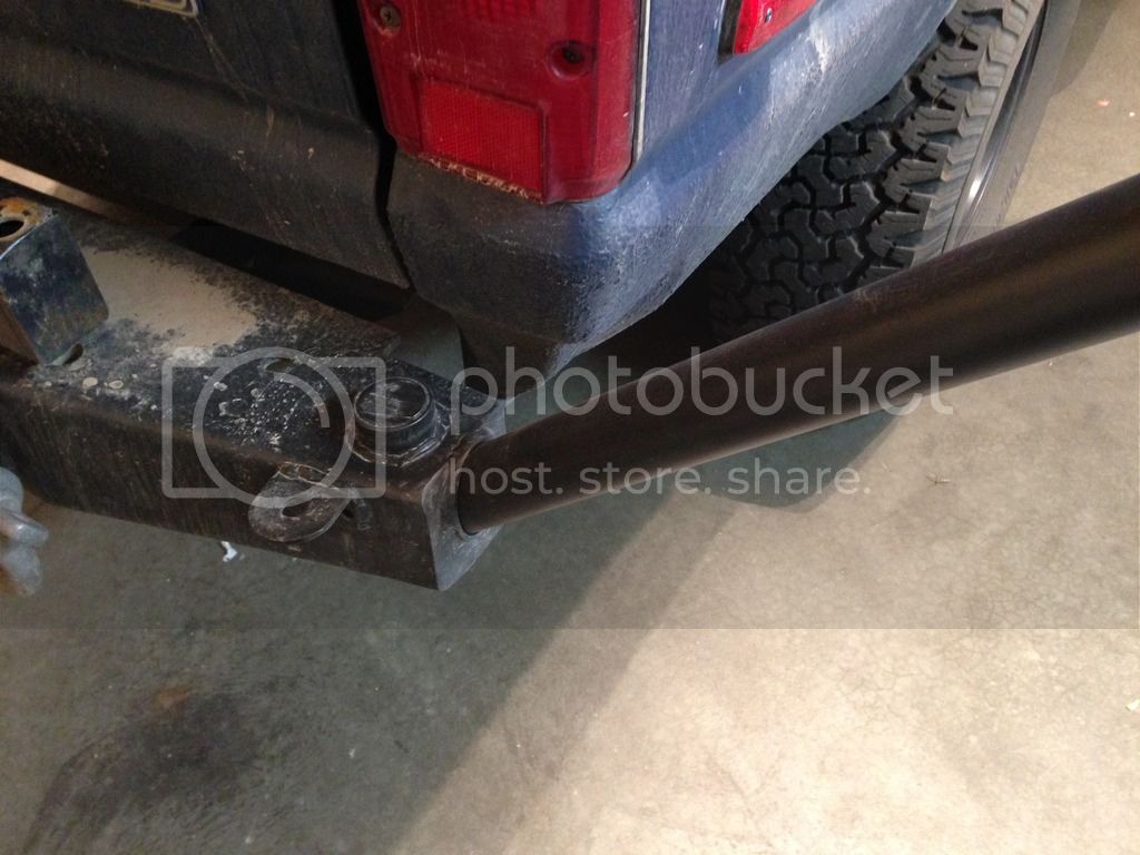

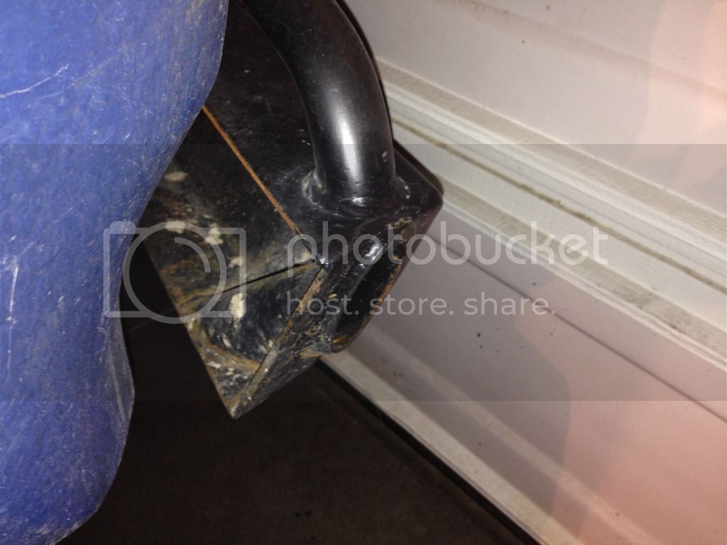

On my 60 I took a small piece of 1.75" DOM and sliced it into my bumpers at roughly a 45* angle then made some poles out of 1.5" DOM that slide in perfectly, works like a charm. I store the poles on the roof rack with some Quick Fist Clamps, Takes about 3 minutes to set up. I also put a 3" foam pad in the bottom of he Hammock on those cooler nights.
Love it. I wonder if it would be possible to do something similar using stuff already in your trail gear, like a shovel and/or hi-lift jack. The only issue I would have is I usually have my wife with me, and she would be less impressed sleeping on the other side of the truck. I am all about this 80 Series hammock thread, and that setup is killer. Just need a cupholder on your sliders for a beer.

That is awesome. Is that an original idea?
