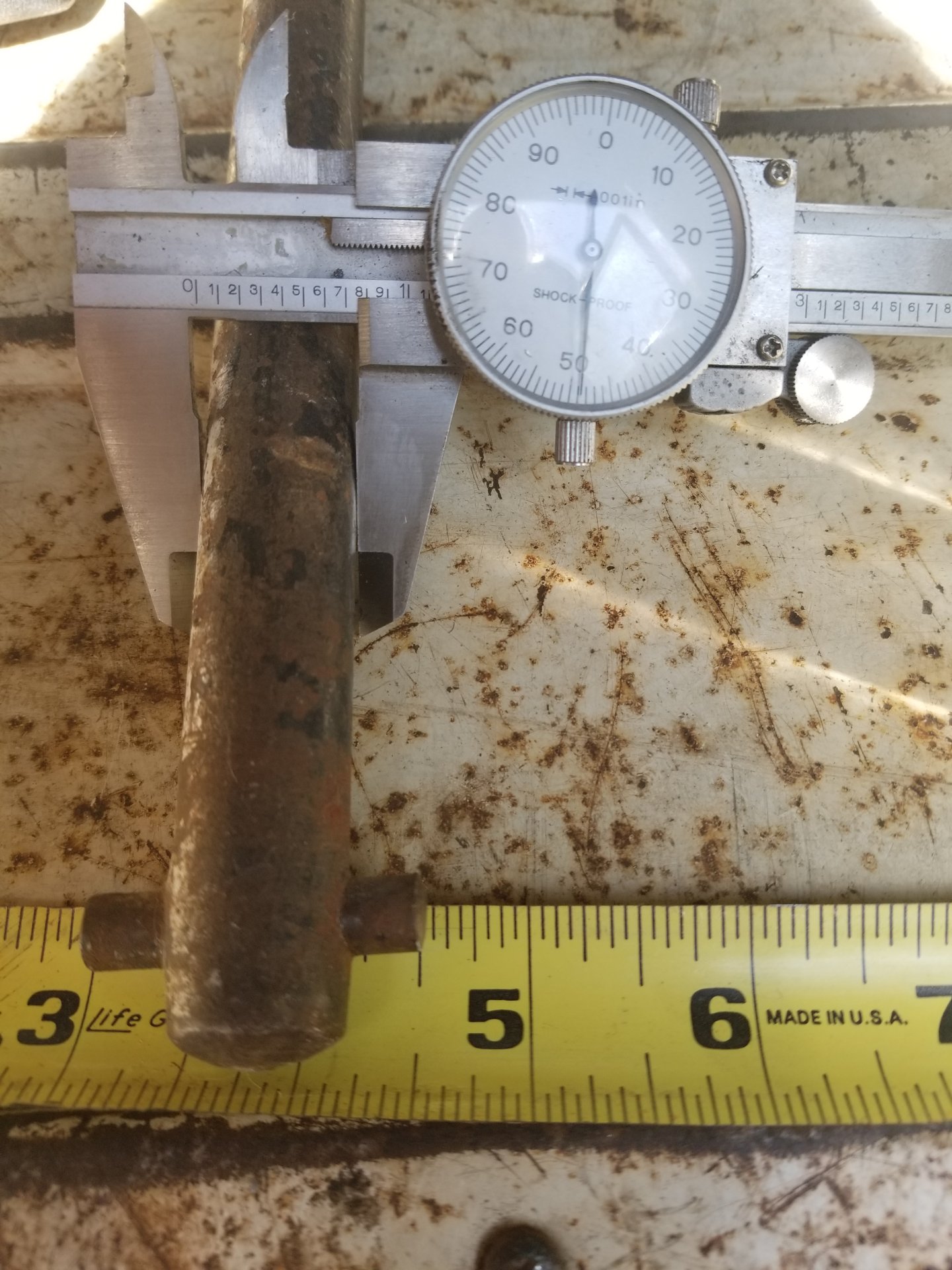

Does anyone out there have an FJ engine hand crank for sale or have one I can get dimensions to fabricate my own?

There are two lengths of this rod. Bought a 1005 MM one back in the nineties when there were still available. Early one is 850 MM. Scored a second one out of a wrecked 84 HJ47RV. Both of these were for lower the spare tire underneath the back. The guide on the bumper wasn't available turn the 2H engine over for obvious reasons. I have a water key used two turn water off at the meter. Never checked the size but think the diameter is close to the OEM rod. Good vise and a torch could been one up. Drill a hole and drive a pipe and your set. Believe some other Japanese auto maker used one that was close in their SUVs that might locate in a wrecking yard. Search on mud might bring up the thread.

I located one but the guy wanted $700 for it. I will make my own for that price. What is the diameter of the main shaft?
