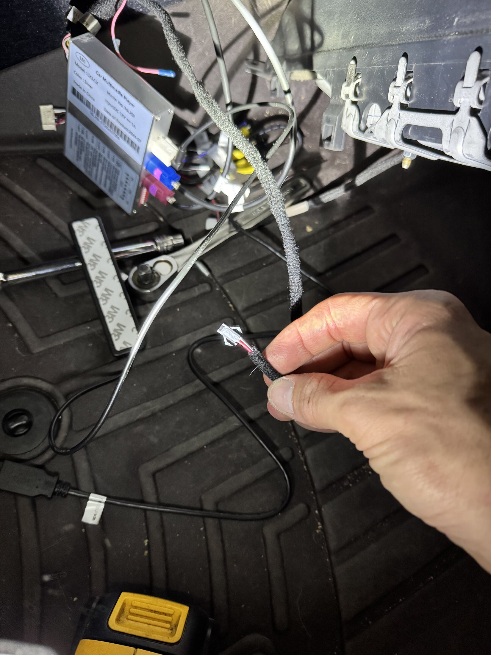

Anyone with a 2016+ lx570 install one? I’m in the middle of it. Everything plugged in comes up on the screen, functions, but no sound at all. The instructions on their site aren’t very helpful, they show an lc. Guy I spoke with briefly earlier today also wasn’t helpful. Now I’m stuck until Monday to call back. Only thing I’m unsure about as far as wiring is this plug labeled speaker, can’t find anywhere to plug it in. It seems like the obvious solution but where to go with it is the question.
Anyone with a 2016+ lx570 install one? I’m in the middle of it. Everything plugged in comes up on the screen, functions, but no sound at all. The instructions on their site aren’t very helpful, they show an lc. Guy I spoke with briefly earlier today also wasn’t helpful. Now I’m stuck until Monday to call back. Only thing I’m unsure about as far as wiring is this plug labeled speaker, can’t find anywhere to plug it in. It seems like the obvious solution but where to go with it is the question.View attachment 3742123
Did you select AUX input?
Was this picture taken before you fully connected everything because I see a white plug in the background that looks like it should be plugged into the box.
I don't believe the little round speaker is used in our installations.
Aux input is on the Toyota side of the screen inputs. Under audio select aux as your audio source. This is what most CarPlay units tap into.
Got it, I’ll give that a try. Figured it was something simple that I missed. Thanks for the help.
The white plug you’re referring to in the top left of the picture is for the usb. I tried it with it plugged in and my phone connected to see if it changed anything. I must’ve just unplugged it before taking the picture. Wasn’t certain that black speaker plug went anywhere. Thanks for clarifying.
