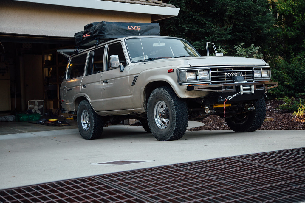

This weekend I finally took the cruiser on a camping trip, it has been long over due but it finally happened. My girlfriend and I and a bunch of our friends went up the Yuba river to hangout and cool off for the day Saturday and then planned to head to Watson Peak up in Tahoe for a night of camping. The river was great to cool off in with it being so damn hot in the Sacramento area as of late. On our way up to Tahoe we were on Highway 20 and were turned around about 2 miles from the highway 80 on ramp due to a fatal accident on the road. The detour added almost 2 hours to the schedule but we made it up to Northstar for some dinner and then headed up the hill to setup camp.
My dad and I got the roof top tent on the cruiser pretty easily, I was wondering if it would be hard or not but it worked out pretty easily. I'm used to just setting it about chest height on my truck bed.

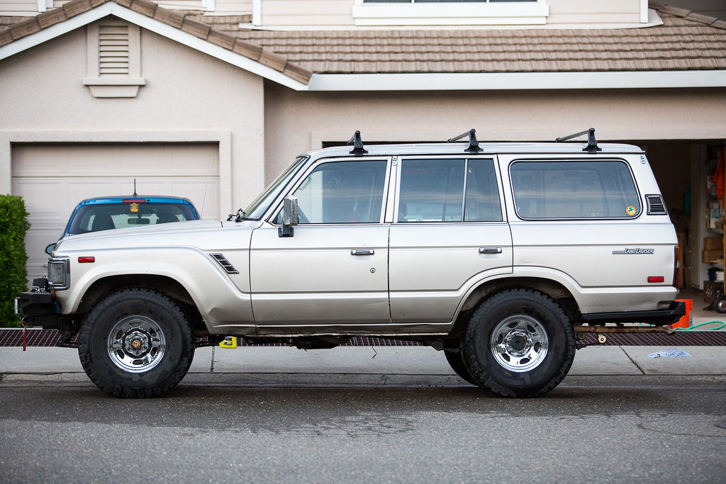

Still psyched I finally took it camping, so here's another pic of the cruiser all setup

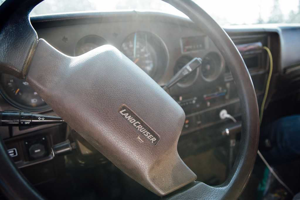

Can't beat that logo

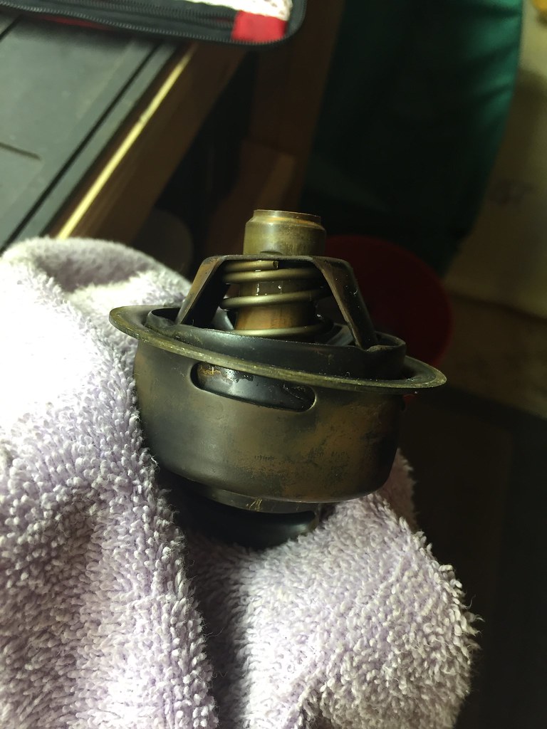

With the cruiser staying at home while I'm at school, my dad now has a fun project for himself! We pulled the thermostat right before I left and I got the gaskets and bolts ordered to at least check off one potential culprit for the engine. I have a long list of things I need to do to the engine to just get it back up to date on maintenance along with solving the running issue, but thats all apart of the fun. I'm waiting for a free weekend to head home and give it the attention it needs. Once the engine issue is resolved, a front axle rebuild will be done.

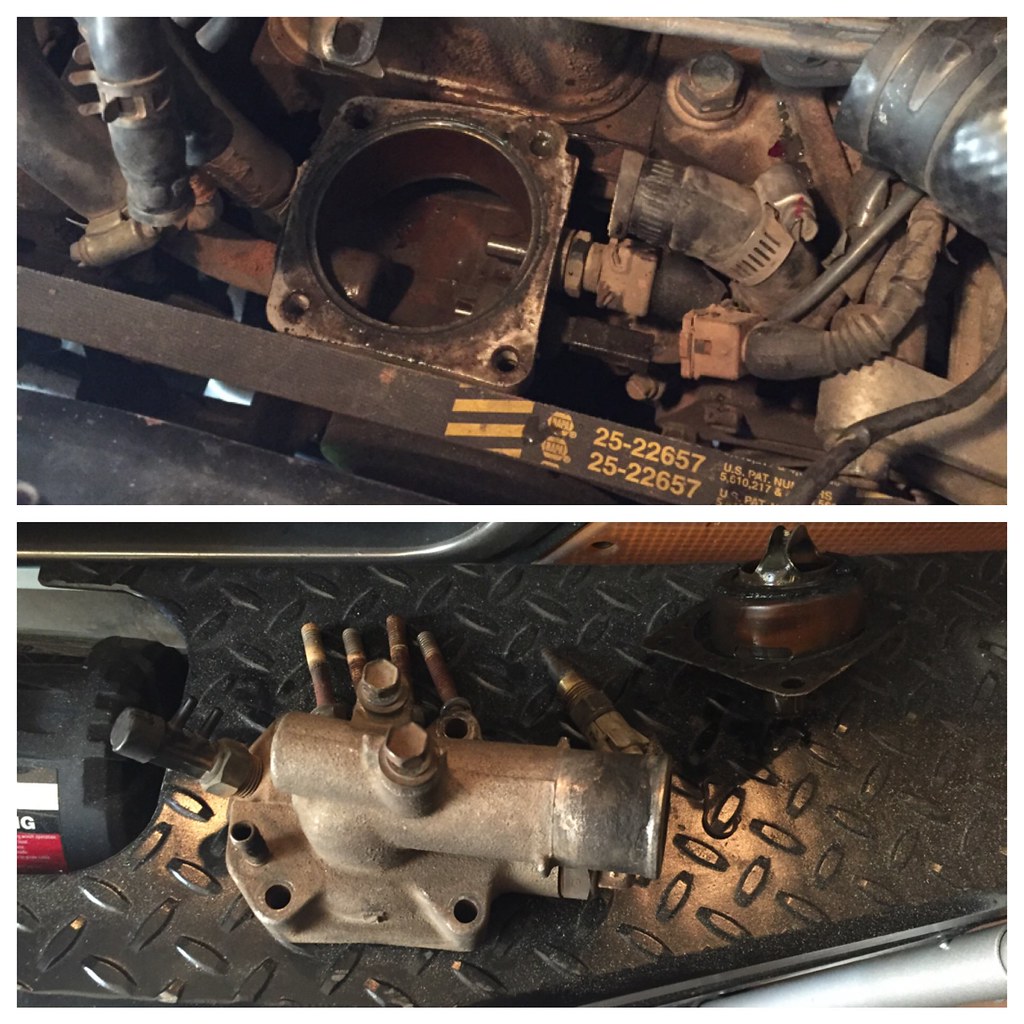

My dad sent me a few photos from pulling the thermostat and a repair manual he picked up on eBay, so here's a few pics!
IMG_1751 by Zach Youngberg, on Flickr
IMG_1750 by Zach Youngberg, on Flickr
IMG_1749 by Zach Youngberg, on Flickr
Just a reminder that you can install that thermostat upside down make sure you get all the gaskets and the proper orientation when you install.

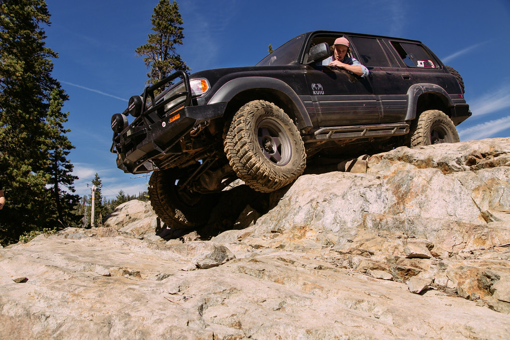

Yesterday my roommate @gneisscruiser our friend Brett and I met up with one of my buddies and his friends for a little trail run out at Gold Lakes in Northern California. Unfortunately we didn't have a ton of time to run the trail but we got through a small portion heading up towards Snake Lake and it was pretty fun! We had a total of 11 rigs I believe which included @gneisscruiser in his 80 and another guy in an 80, my tacoma and another taco, 4 Monteros (which are pretty damn cool!) two 4runners and an Exterra. It was interesting running with a group this big but I enjoyed it, its definitely interesting seeing how differently other people operate on a trail. Here's a few photos from the day!
This guy to a stab at this big rock slab on the Summit Lake trail on our way up to Snake Lake trail, he couldn't quite get up it but it was a solid attempt.
LR4A7426 by Zach Youngberg, on Flickr
@gneisscruiser was next up at the climb and didn't have a problem besides having to make a 24,000 point turn at the top to get lined up to go down the other face of it.

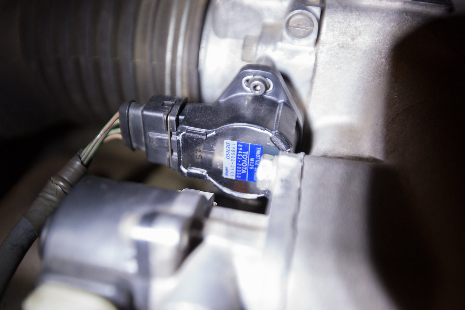

Over thanksgiving break I got a few things done on Haikili. My dad ordered a new hood support holder and rubber bushing for it so I threw those on and then I got the new OEM throttle position sensor on and wow! It runs really well now. It had an off brand one on there originally that the previous owner put on and the engine had a really weird sputter when driving randomly. We adjusted the off brand one a few times and it would work but never lasted very long. Fast forward to putting the OEM one on and it runs really well. I feel like the throttle is much more progressive whereas the old one felt like there were three or four throttle positions and that was it.

Old vs. new
LR4A2489 by Zach Youngberg, on Flickr
LR4A2499 by Zach Youngberg, on Flickr
New TPS in it's new home
LR4A2503 by Zach Youngberg, on Flickr
