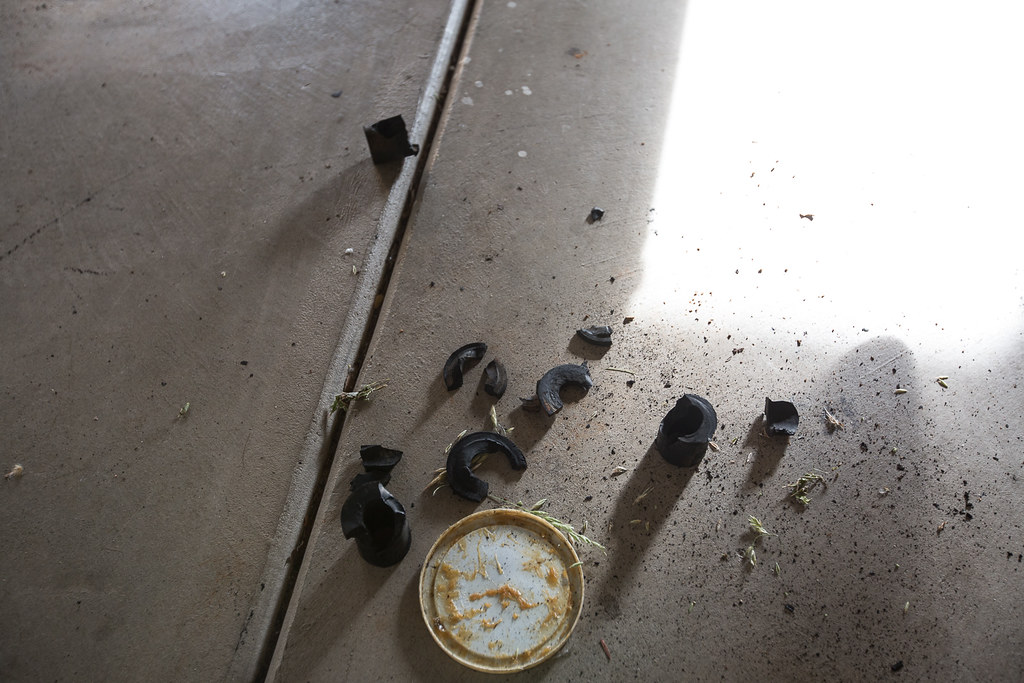

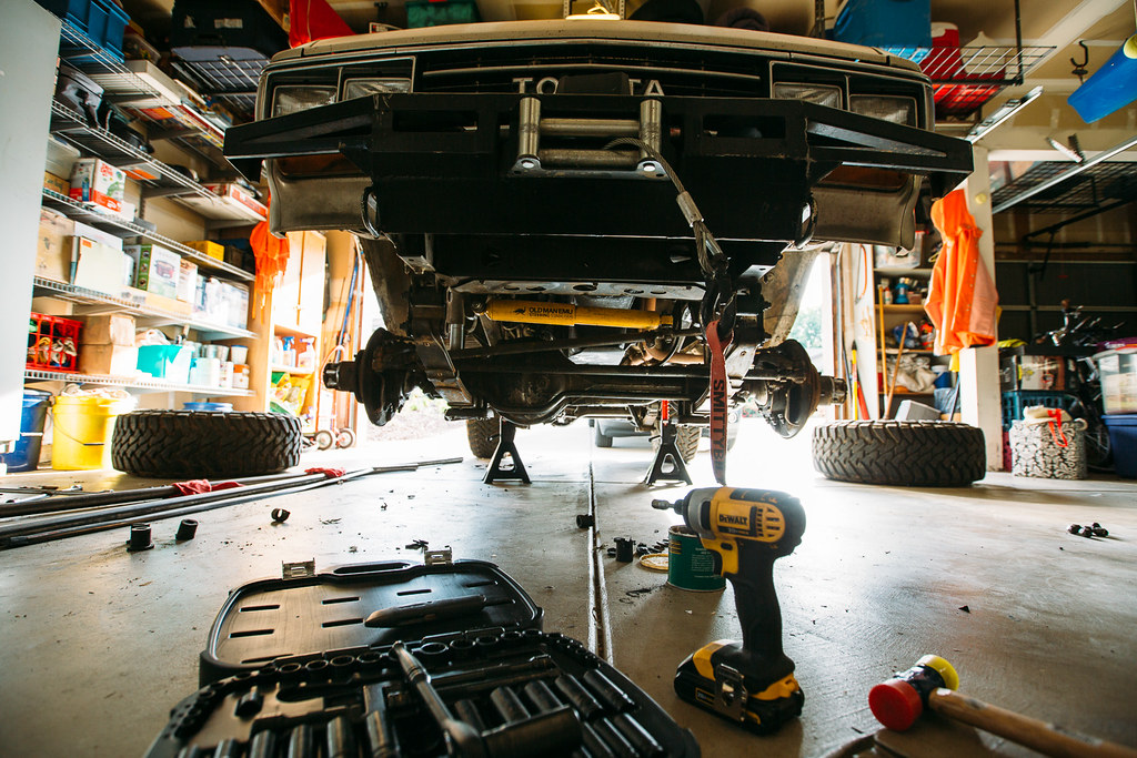

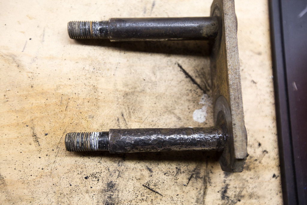

I had plenty of time this week to work on the cruiser and I got the shackles all pulled and swapped in all the new bushings. Everything came apart really easily, no burning out bushings or trying to loosen the hanger bolts for a week. Unfortunately, the shackle pins are in really bad shape and I need to get new shackles. Along with that, while I was doing my best to smooth out the corrosion on shackle pins until I can get all new shackles, I buzzed the top of the threads on last one I had to put back on, and ended up wrecking the shackle bolt trying to thread it on. So, until my friends at ARB are back and I can call and get some shackles ordered, Haikili is going to be sitting on the jack stands. I borrowed a friends thread chasing kit but he didn't have the proper size die to try and fix the threads. I figured it isn't worth my time or money to buy a die and try and fix the threads for now and go and get a bolt when I need to replace the shackles as a whole anyways.
I'm bummed that I can't drive it for a week or two, but it could be worse. In the mean time while its immobile, it'll force me to get some of the interior things done that need to get fixed or cleaned up. I finally got around to filling out the whiteboard in the garage with goals, parts lists and other things that need to get accomplished with the rig.

I didn't have much trouble at all getting the bushings out, they were pretty well destroyed and just fell out.
LR4A7722 by Zach Youngberg, on Flickr
Due to the bushings being more than worn out, the elements were able to get to the shackle pin and wear it away.

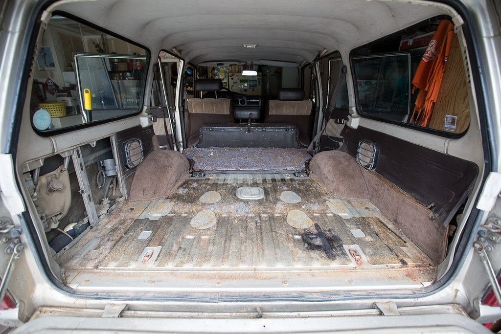

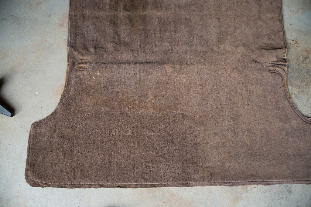

This afternoon I went ahead and pulled the rear carpet out along with the driver side rear interior panel. I'm going to be rebuilding the rear interior panels, I just haven't decided how I want to go about that yet. The carpet is in good shape, I only had a little bit of carpet cleaner left but from what I did get clean, I'm happy with how well it cleaned up.
The interior was re done by one of the previous owners, and they did a rather good job with it. I did however find the rear cargo hooks rusted underneath the carpet when I pulled it up. They never slit the carpet for them to pop through and just left it as is. I'll either try sand blasting them or just get new ones, not sure which one yet.

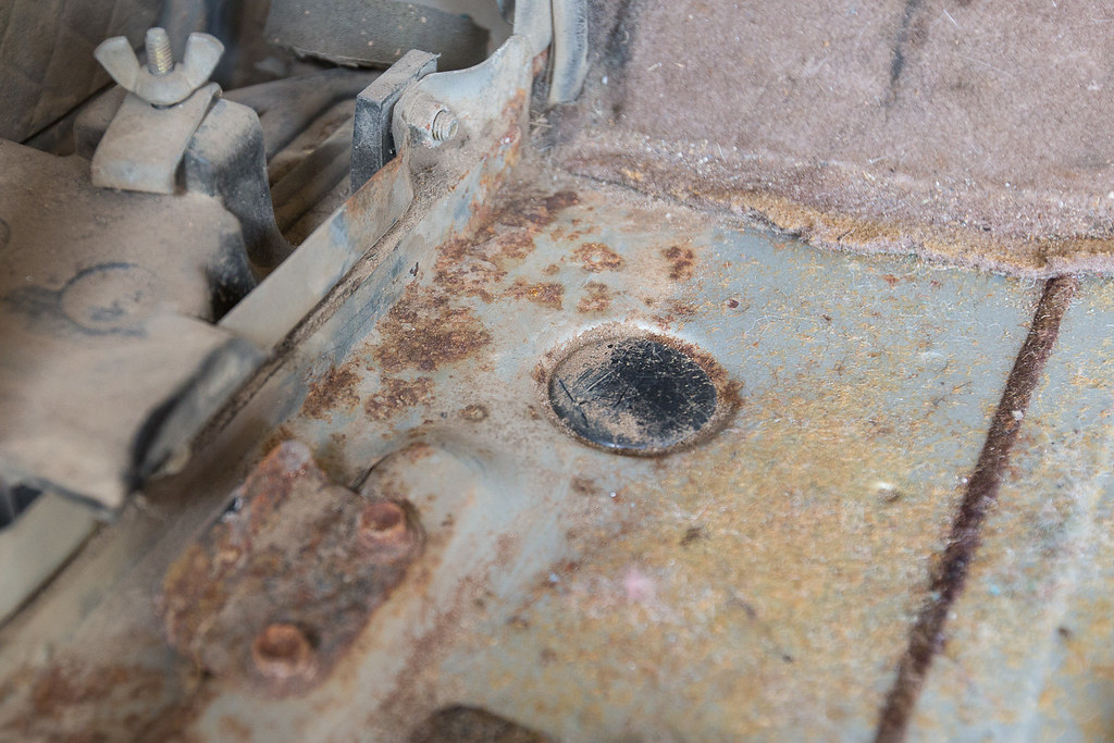

I do need to clean up a few spots of surface rust that I found underneath the carpet. I'm going to pickup a wire wheel this week to get rid of it and then I'll decide how I want to seal it up. I have been thinking about getting the floor line x'd to get it all sealed up and add some strength to it but thats probably overkill and I do like having carpet back there. I need to pickup some new speakers for the rear as well. The factory enclosures are in relatively good shape. I'm going to clean up and re-paint the cages that go over the speakers and it should be good to go.
I'll swing by home depot either tomorrow or Tuesday and hopefully find material to build some new interior panels out of. If anybody has any suggestions, feel free to chime in.

LR4A7728 by Zach Youngberg, on Flickr
The bottom left corner of the carpet is what has been cleaned, kind of hard to tell in the photo but it's definitely an improvement

These are the two worst spots of surface rust. Some time with a wire wheel sanding and some paint to seal it up and it should do just fine for me
LR4A7735 by Zach Youngberg, on Flickr
LR4A7737 by Zach Youngberg, on Flickr

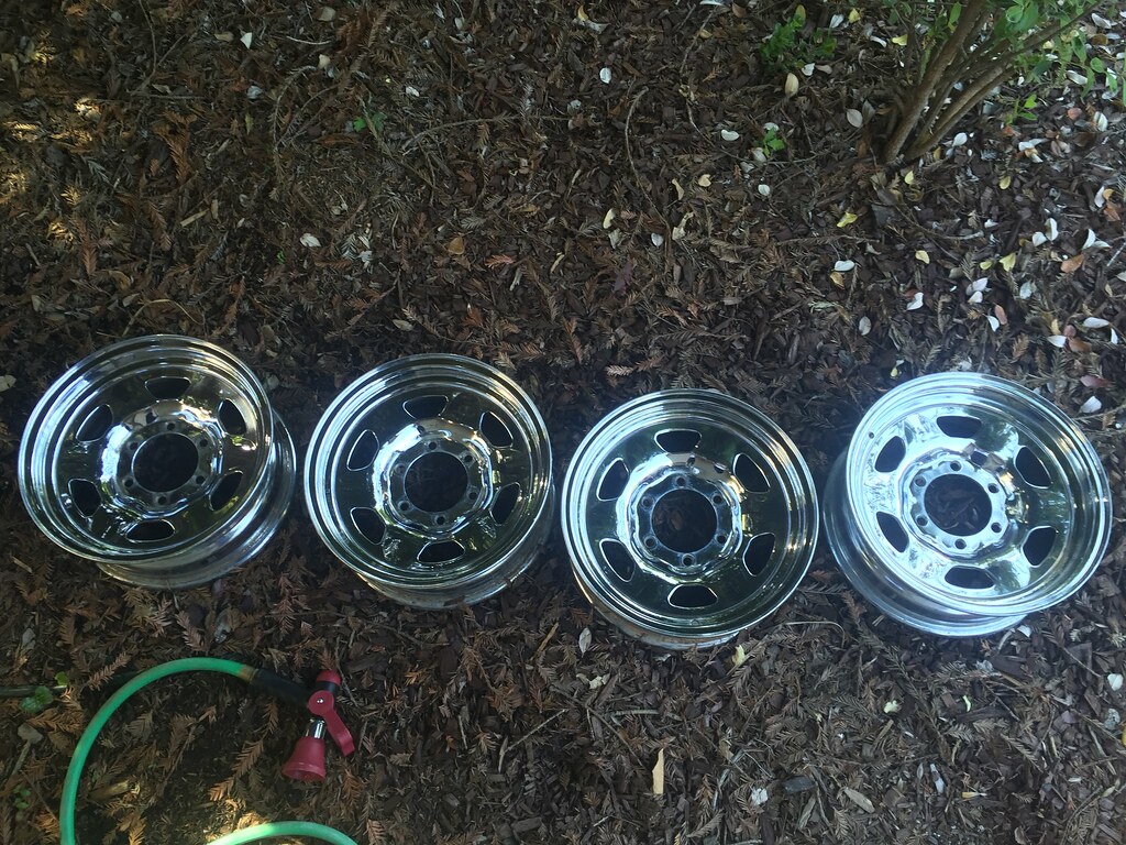

Heres the wheels after I cleaned them up, they have some rust but they cleaned up extremely well.
