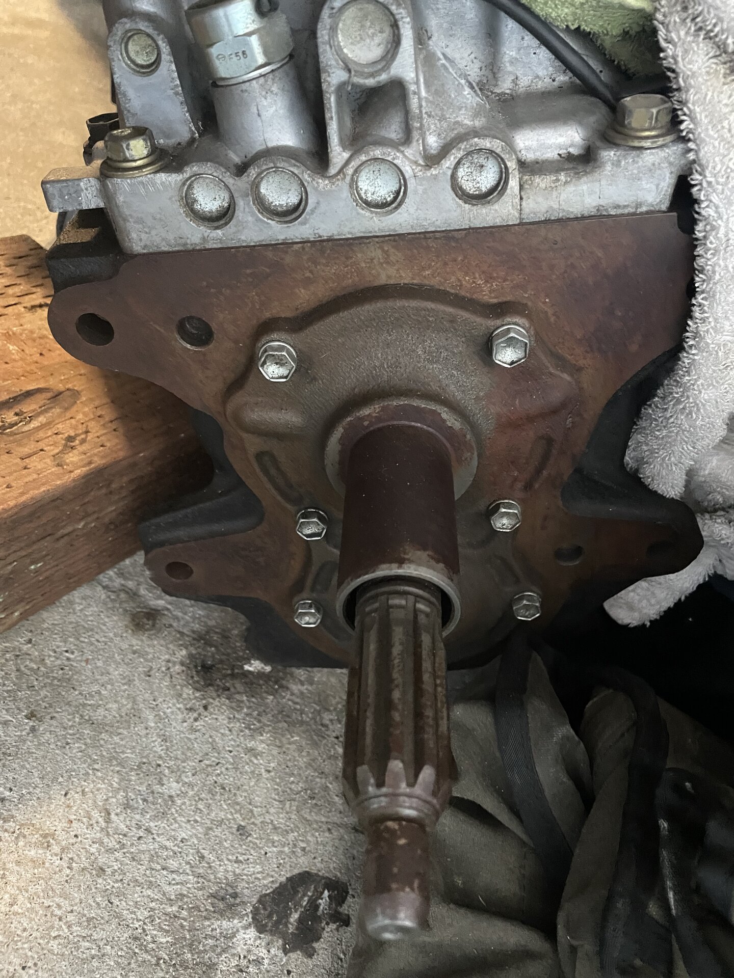

I have a basically new H55f and it’s for a 2f I’m looking for a 3b input shaft (and retainer?) so I can adapt it to my 3b.

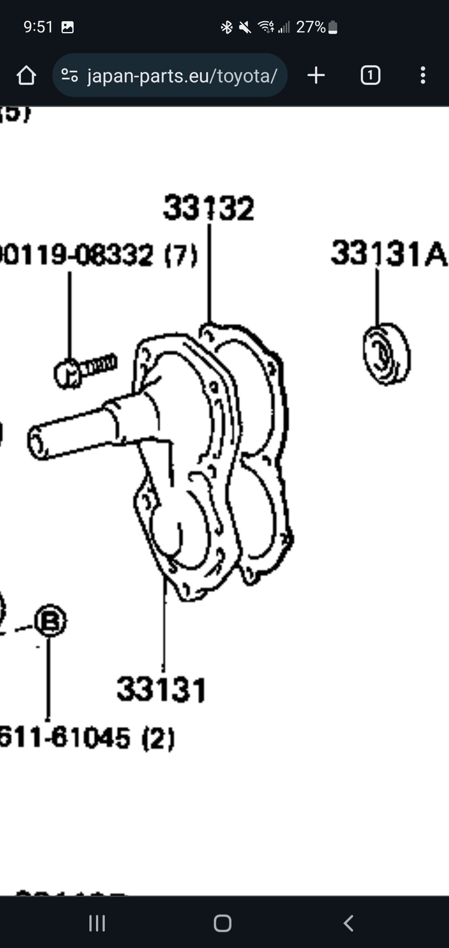

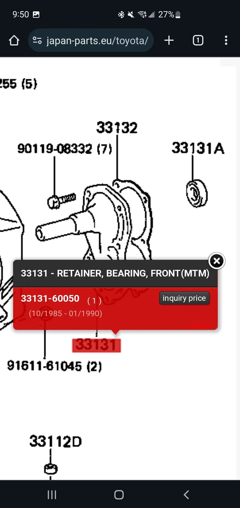

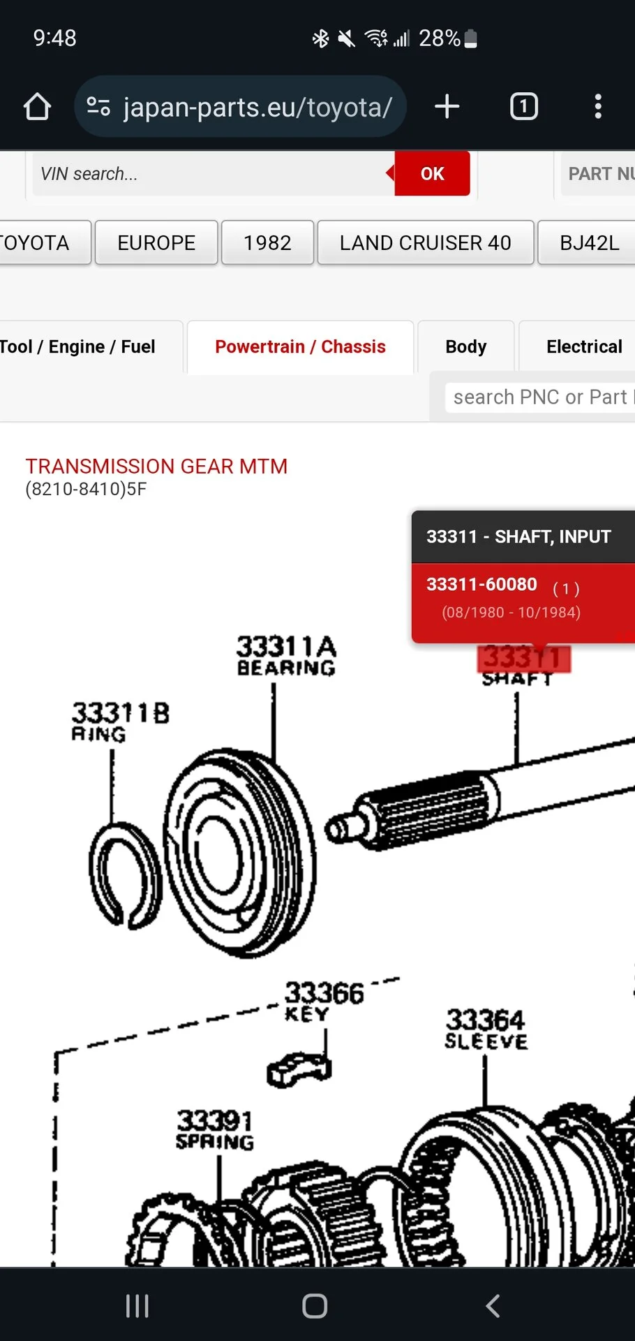

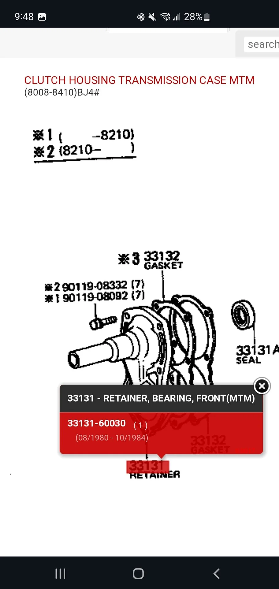

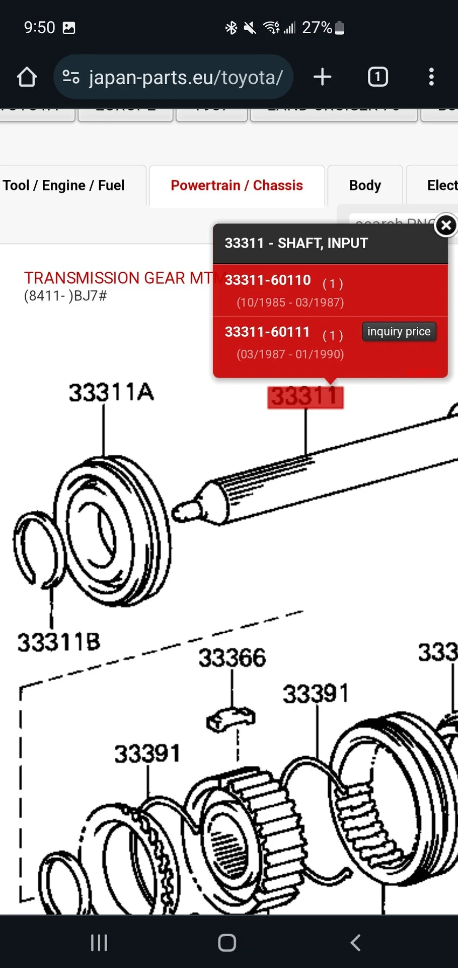

If your new 5speed has ears on the retainer then it's the 85+ design. See the last 3 pictures.
I know one of my 3B 5 speed shaft came off a 85 BJ42 LX out of Netherlands.
Eitherway you have some part numbers to reference.

10/85 is actually the start of the model year in markets like the US that have a model year. That is the date for the input shaft and bearing retainer change.
Would be curious on the build date of the 85 BJ42 LX? I know the long wheel base 40 series were produced and sold in small number up to 4/86. Haven't seen any FJ40 or BJ42 made past 10/84. 11/84 was the start of the 70 series.
