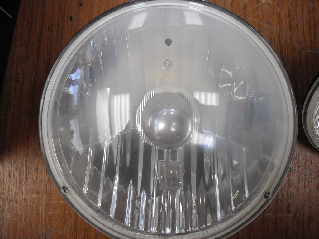

Here are a few pictures. The passenger side is much whiter than the driver side too, on both casings. I replaced the passenger side IPF with a new casing. the driver side isn't too white yet, but it seems to send a blotch scatter of light above the cutoff line, I'll grab a picture in the dark. The IPF casings have a metal back and glass lens, the Peterbilt's have a glass lens and plastic backing.
This is the Peterbilt casing I pulled, when I touched the chrome with my finger it came off as a powder. Even the glass around the top has some whiting on it.
Here is the worst IPF casing I replaced, its tough to see the whiting because of the cutoff lines.

It's odd because I swiped the inside of the casing to see if the chrome would come off, and it was perfectly shiny underneath. I took some hot water and thoroughly rinsed the inside of the casing and almost all the white disappeared, I used my finger on a soft cloth and was able to get the rest of the deposits off. The inside of my casings smelled "salty" as well. Could my bulbs maybe be leaking?
Could it be condensation and due to your salty environment the salt condenses into this white powdery substance?
the heat from the lamp dries the air leaving behind the salt? Maybe try sealing up the back of the bulb housing to see if it helps?
just a shot in the dark... GL!
