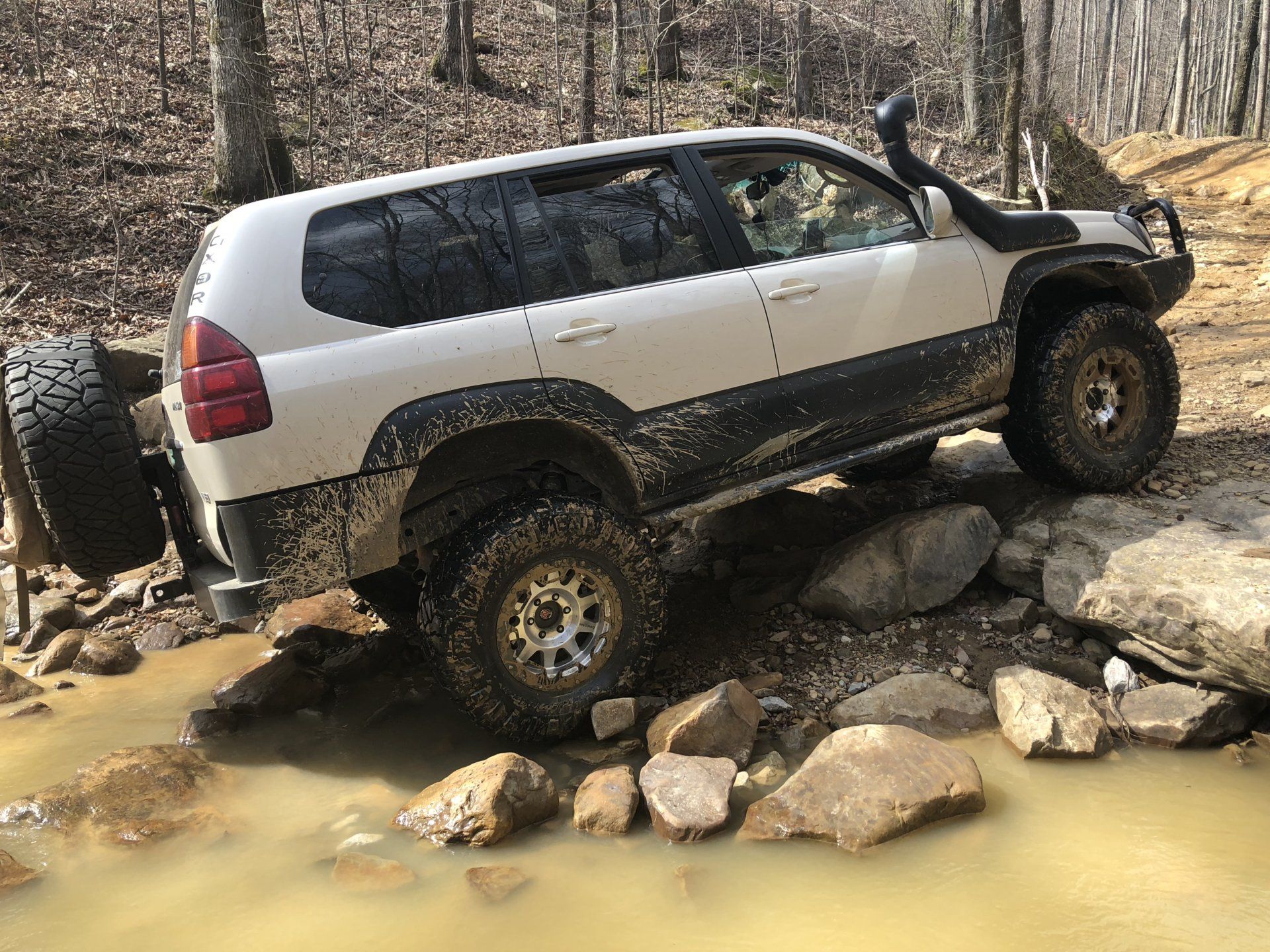

Nomad HD valve body installed and electronic torque converter lockout is installed and functional!
Just waiting for the fuel tank to come in from down under and she will be ready for the Rubithon!
New springs are perfect in the back. Valve body is in and TCC is functional. She's a beaut!
What Brand are the new springs Dan?
Slinky from 4xoverland.com.au via Cruiser Bros. Progressive long travel, 800-1000#, tapered coils with progressive stack. Very impressive. For every set they make they scrap 4 or something like that. If they aren't perfect they go to recycling.
