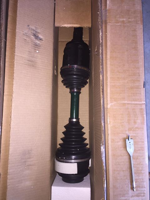

Lotus axles are here, but need to install.

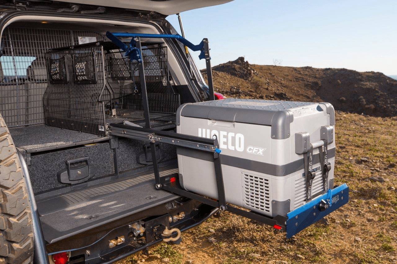

That fridge setup is awesome.
That is a stock photo, but you get the idea. Mine is on a slow boat from Aussie land. The drawers are trickling in.
