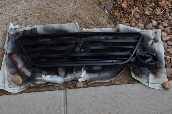

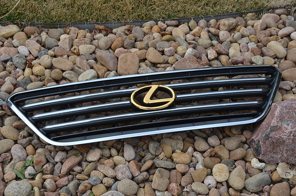

Just acquired my '04 GX470 - Black with gold trim - 151K miles. This is the official build thread. Item 1 ... ditch the gold....
Blacking out the logos
Logo black out continued...

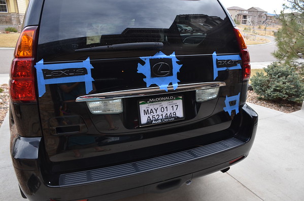

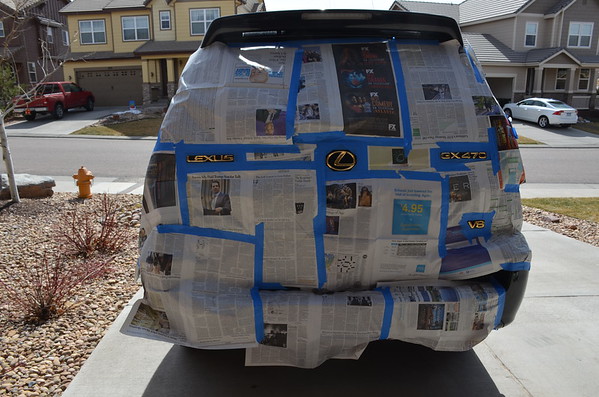

I used plasti dip to black out the logos. Basic procedure:
Mask closely, about 1/8th of an inch, around the logos
cover the area with newspaper
3 coats - 4 hours between each
use a utility knife to cut around the logos and on the inside of the logos
peel the excess around the logos and inside the logos using a toothpick.
Once it dries all of the way it is a very robust coating, it will survive car washes and rocks...
The end result is what you see. If I decide I want a different color later I can just peel it off the logos and redo it. My wife wants me to do a colorful L on the grill as a start...

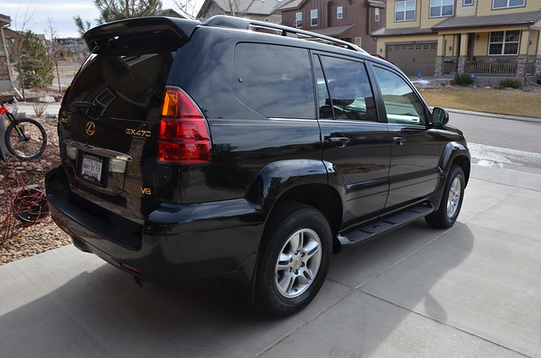

It occurs to me that I should update my build thread....
Current state:
