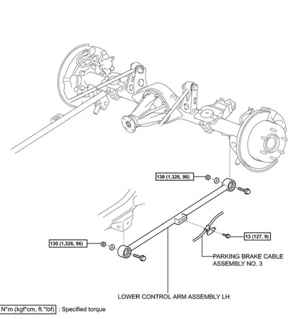

Does anyone have a pic of the KDSS LCA in the rear? I'm curious as to the difference between the two styles.
The Rear LCA is same on KDSS equipped and Non-KDSS equipped trucks, the KDSS swaybar mounts to the axle tubes in the rear.
Awesome pics @bravoleader, thanks. So a HD non KDSS LCA won't work in a KDSS ride due to space constraints? I'm squinting my eyes on the lower picture, at the very bottom left corner and I see the LCA mount but don't see any reason why a HD non KDSS LCA wouldn't fit in that space?
If you keep KDSS you have to get KDSS lower front arms. Rear is non-issue.
