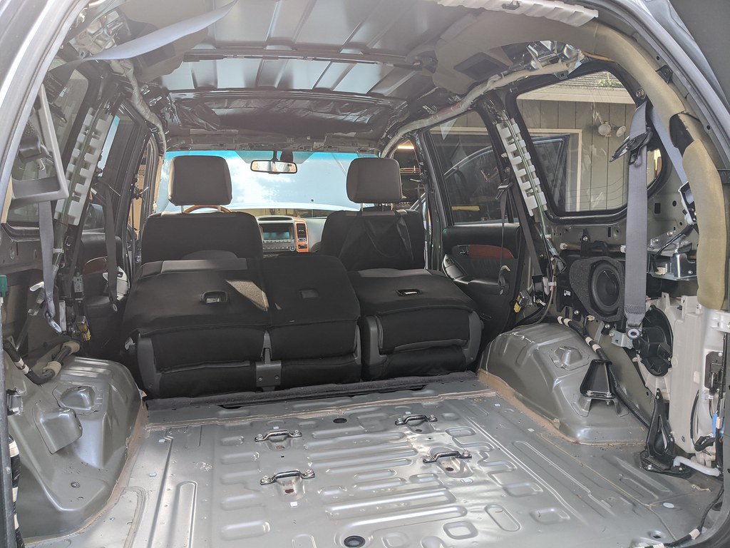

Pics of it without the headliner? I’ve always wondered about pulling it down to soundproof the roof.
I do, I'll get them uploaded tonight. While Toyota crammed things into everything nook and cranny possible the roof is surprisingly bare apart from the sunroof and rear DVD player.

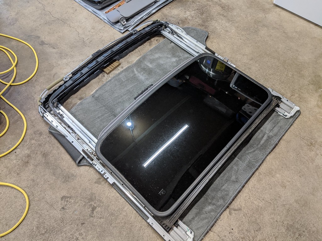

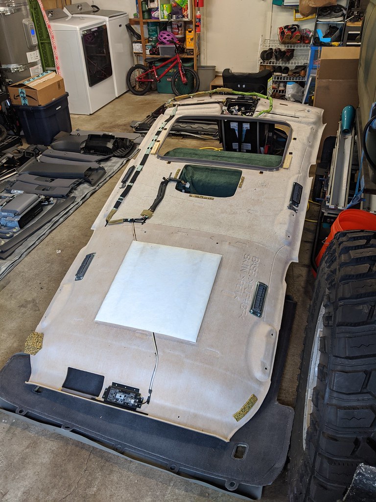

That's everything that came out just to get the sunroof mechanism out. The roof is pretty bare inside.
Now the truck is all sad looking, in typical PNW fashion it's going to rain again.

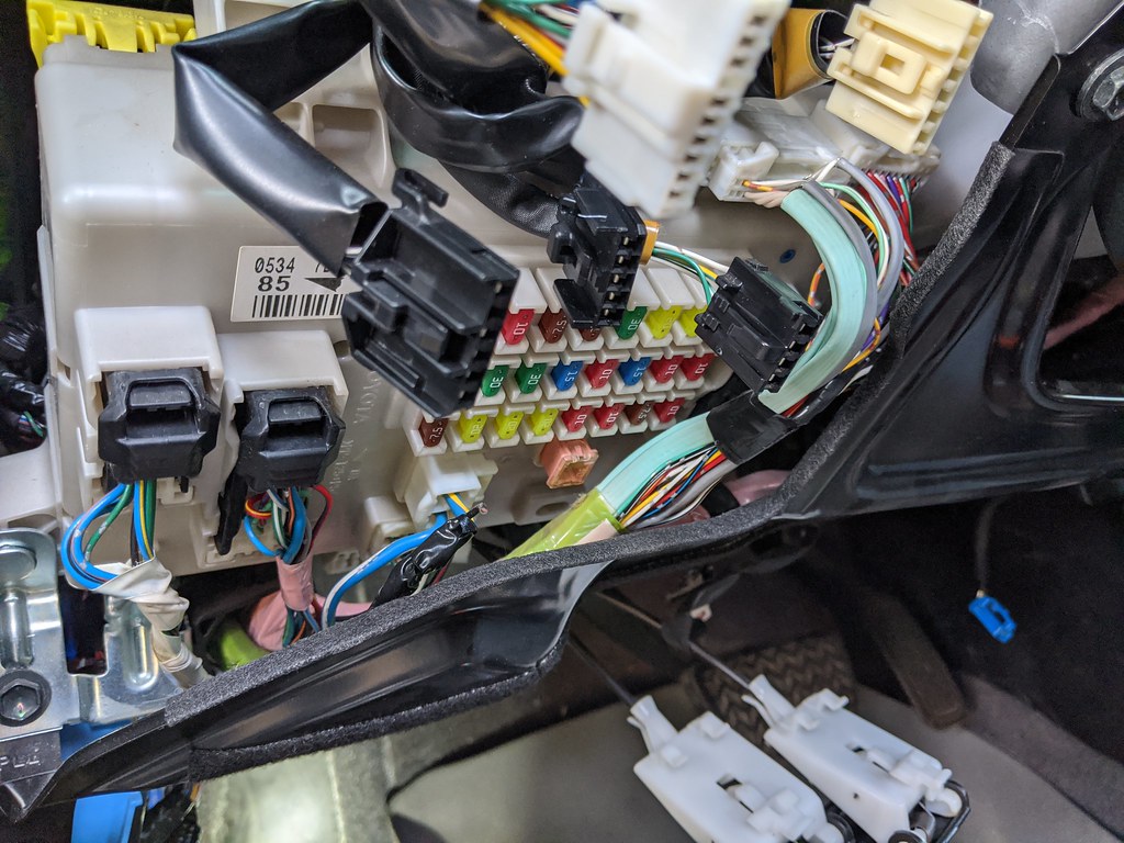

And a tip for anyone who finds this thread: don't pull the yellow wiring harness off the headliner, unclip it from the chassis and unplug it from the fuse block then carefully snake it out. It's only another 15min or so of work and you won't have to re-tape it. You can see it still attached in the headliner pic a few pics up.

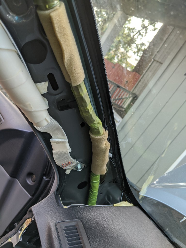

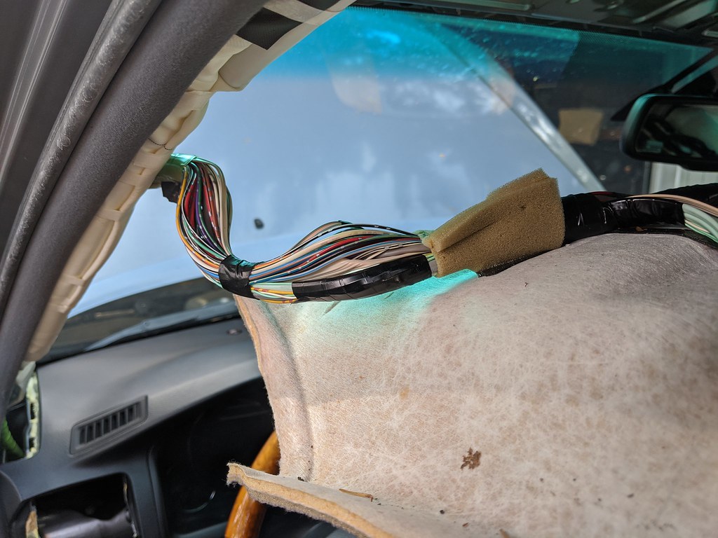

So it looks like the DVD player wires run to the DS A pillar?
Yep! ALL the wires for everything electronic that's on the roof goes down the DS A pillar in that yellow wire harness. Sunroof, DVD, LexusLink, Homelink, Mirror, rain sensor, and lights.
