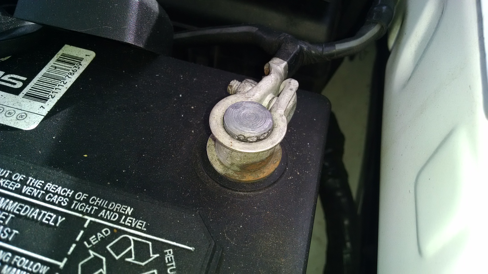

Well, turns out the problem was immediately obvious. We've only had this car for a month and a half. The battery was installed by Lexus dealership just before it was traded in and we bought it.
It's been that way for a while too, a bunch of arcing marks at the top of the post where it's been barely making contact probably since it was 'installed'.
I was thinking maybe I'd keep this one serviced at the dealer for a while but it's obviously not worth it taking it back to the dealer for additional services. How hard is it to install a battery? If you want something done right....
