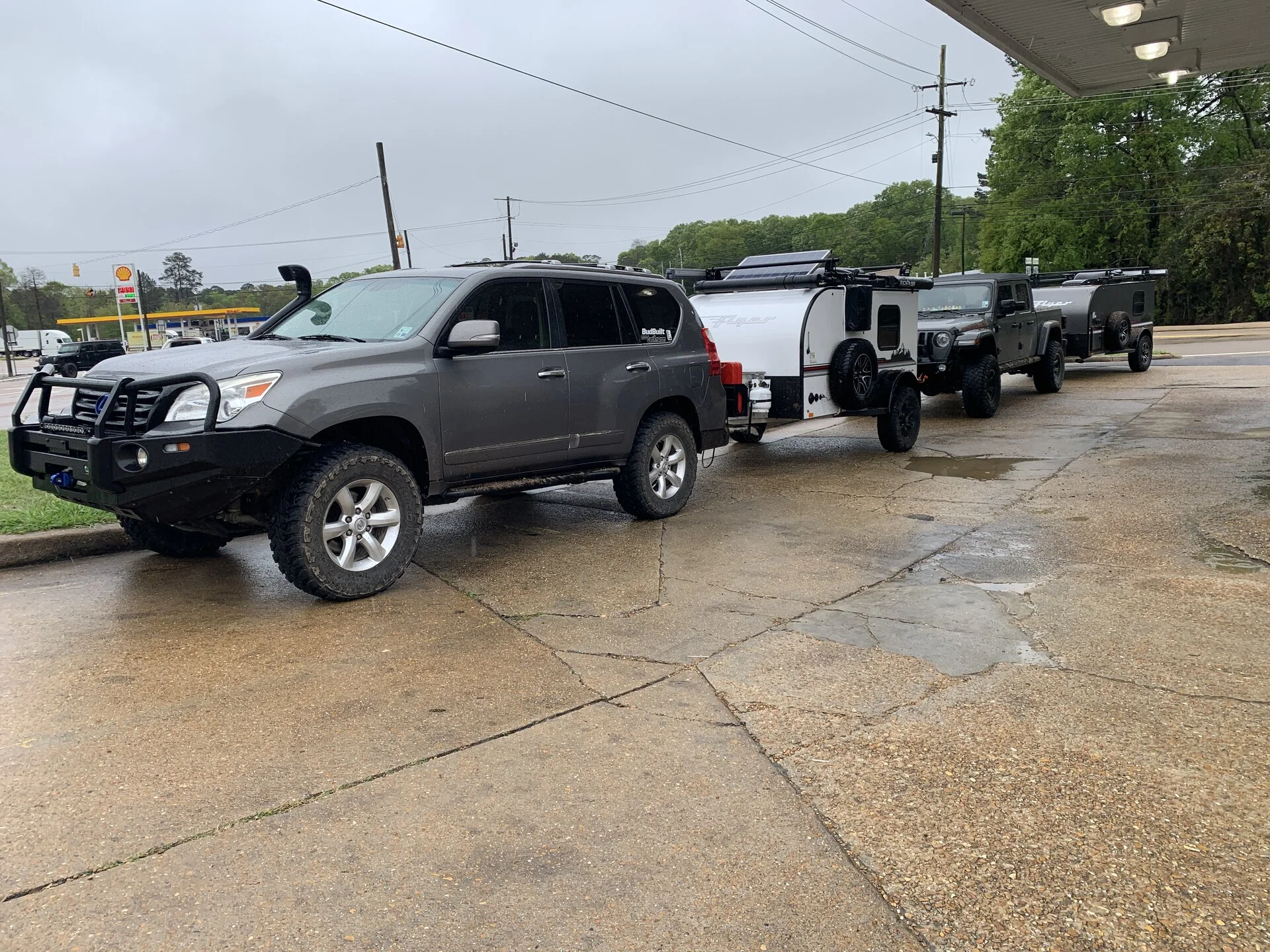

I pull my square drop camper which weighs around what you are pulling and have had no issues. 2013 with 145k miles, lifted on MT’s.

Not to derail the thread, but how's that Gladiator tow compared to 460?
No first-hand experience with the jeep. I met them for the first time during this trip. They didn't seem to have any complaints. Although, we went through a lot of mud on this trip as it rained a good bit. Their square drop was COVERED in mud where mine had about 1/4 of what theirs had. :meh:

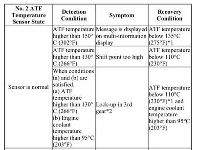

Not sure if this has been asked on this thread yet, but what's a safe range for "Transmission 1" and Transmission 2" temperatures?
I'm running the OBDLink MX+ and for my phone display I have: Engine Temp, and BOTH Trans 1 and Trans 2 temps (along with a couple other gauges).
I notice that Trans 2 is almost always about 5 to 10 degrees hotter than Trans 1.
Also, on our road trips, the average running temps on both Trans 1 & 2 are usually in the high 190° to 220° temps with Trans 2 dipping into high 230° for only a moment or two.
Note my engine temps are always in the low to mid 190° range so no worries there.
There seems to be a lot of debate on this. See the chart below from TCI:
With a good full-synthetic fluid (note that Toyota WS is not a full synthetic fluid), the fluid should be OK at higher temps. Personally I have upgraded and drive my rig so the trans temp never really gets above 200F other than for a couple of minutes towing on crazy grades, a couple of times per year. 170F-185F is normal in the summer.
If you are normally above 200F I'd change the fluid every 30K and upgrade the cooler. Both are cheap and easy.
