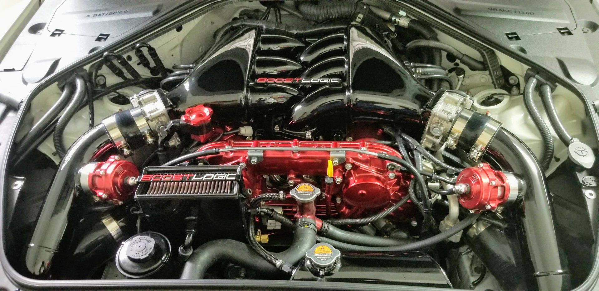

Here is my 14 with Radflo and SCS wheels.View attachment 2029097and the engine bay :)View attachment 2029098
Like to hear about your set up. I have an RCF and I remember the rumors circulating about the possibility of BL adapting a version for the RCF after the LC was released. I’m guessing you work there after noticing you live in Austin. Would love to read/learn about how you made this happen....and of course some dyno numbers.
Sorry for misleading. It was meant as a joke but that is the engine bay to my built GTR which puts out around 1150 hp. I know the guys at Boostlogic but do not work there. I know Zohair over the years and his group does good work and stand behind it.

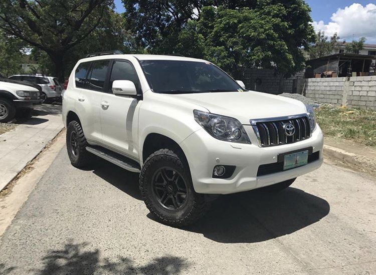

Built this for a client over a year ago.
On stock UCAs
KDSS
1KDFTV engine
Dobinson’s strut and coil springs
285 tires
With 32mm non-hubcentric alum wheel spacers
Jaos Victron rims (super lightweight)

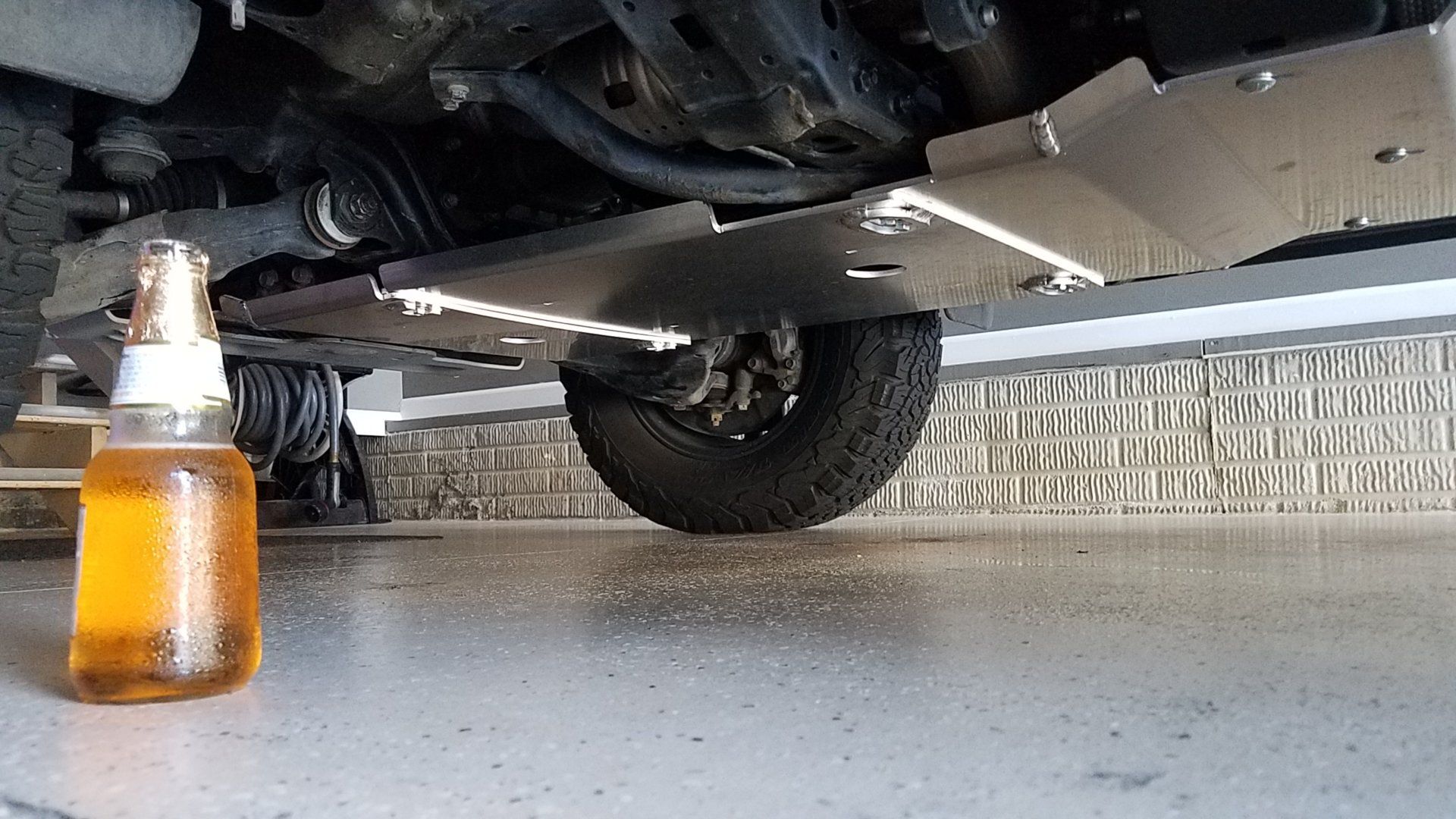

How was the install?
Not bad at all...I will say you need to buy M10 40mm flange bolts to secure the tranny and engine skid plates to the mounts. RCI provided smaller bolts for just the engine only. My buddy had the same problem with his install. Weird thing is I placed order at once so they should've caught that. All in all it took me approx 3.5 hours for the entire install. Trial'n'error is a helluva method.
Plus I watched install videos online from snailtrail4x4 to assist in the process. Guys are spot on...
So I had a couple gents inform me on t4r.org that I improperly installed my transfer case skid plate. Blame it on the late night and beers. Quick 10 min job...smooth as silk.

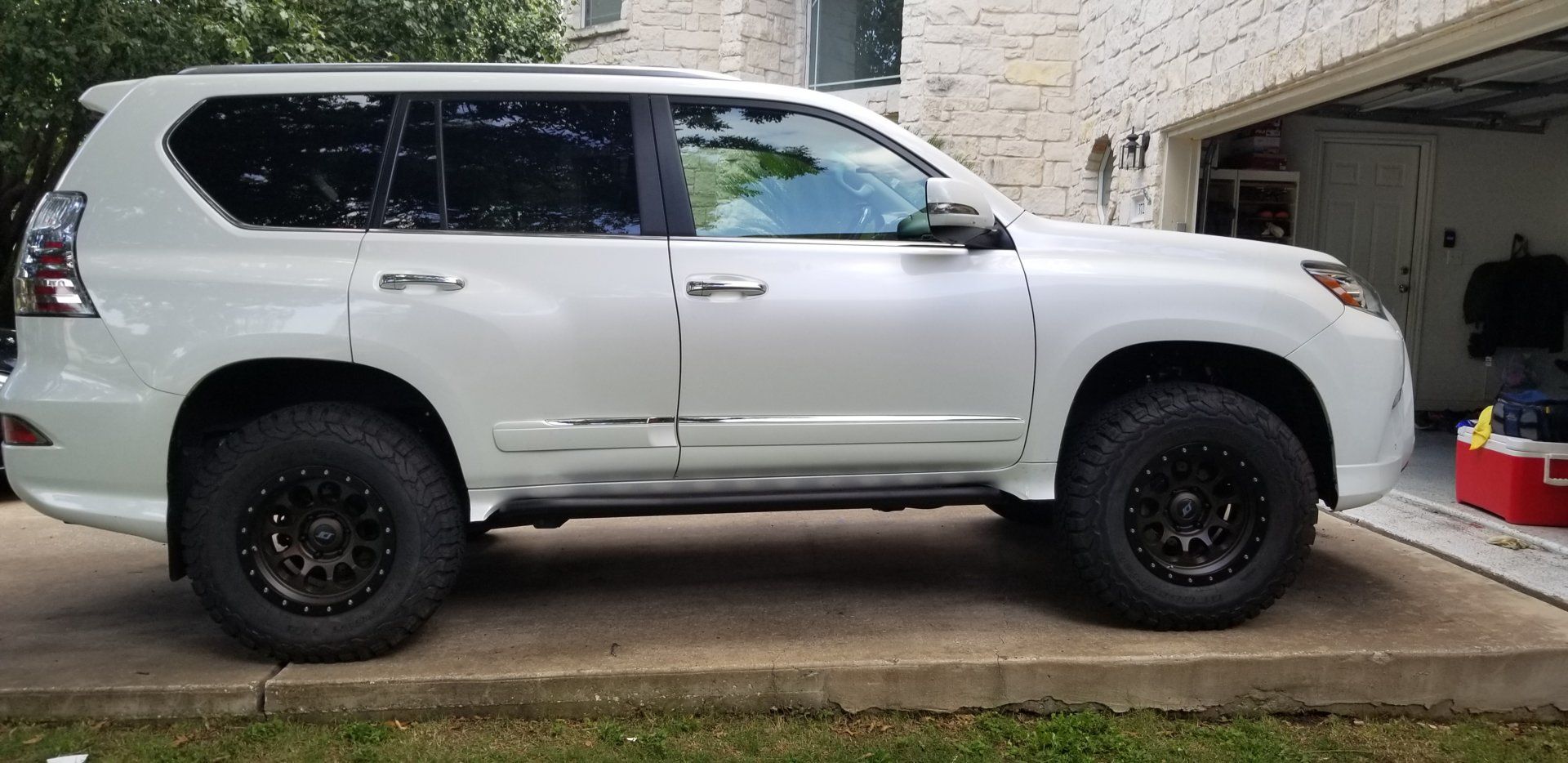

Anyone have a pic of a 460/150 with a 2.5" lift and 265/70/17? Thinking of the smaller tires (might fit in spare tire carrier, less weight, etc)? I am just wondering if the tires will look too small :)
