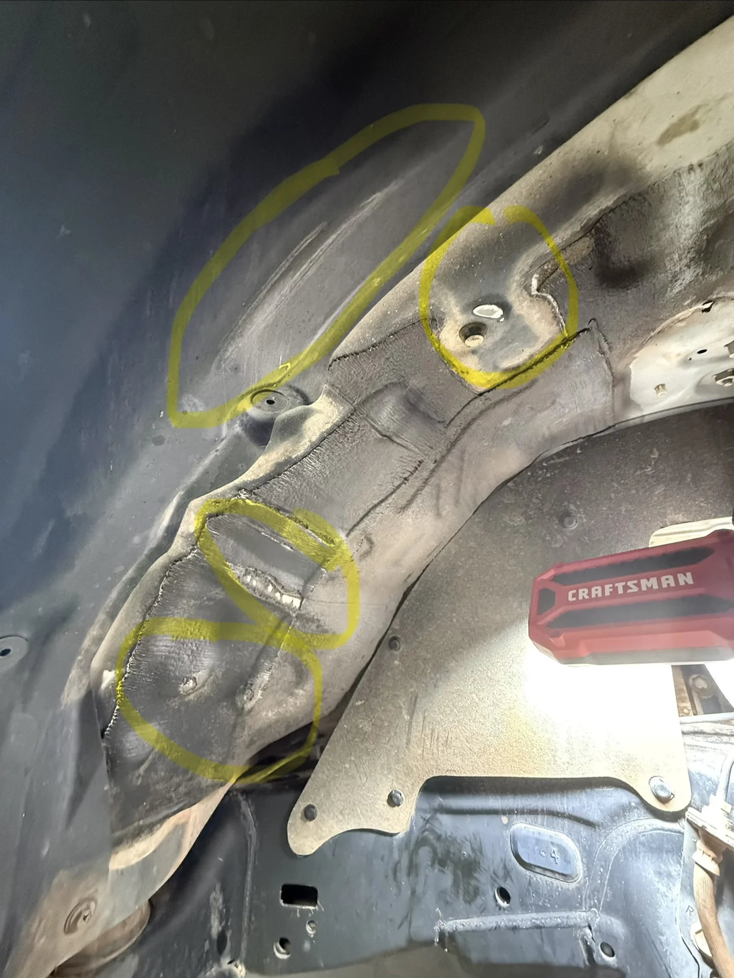

Definitely not enough front spring. You could experiment with more preload in the front or stiffer front springs on the 6112s you already have.
That being said, some bigger remote res shocks to go with some stiffer front springs will probably be worth it since you are doing 8+ hour off road drives. I send it pretty hard on my Dobinson MRR + Perryparts set up and I've never had issues with crashing through the bumpstops or with shock fade and thats with E load 33x12.5 tires.
following up to show the areas where tire is smashing wheel well. i installed the perry extended travel bump stops and +140 lb front weight springs are on the way.

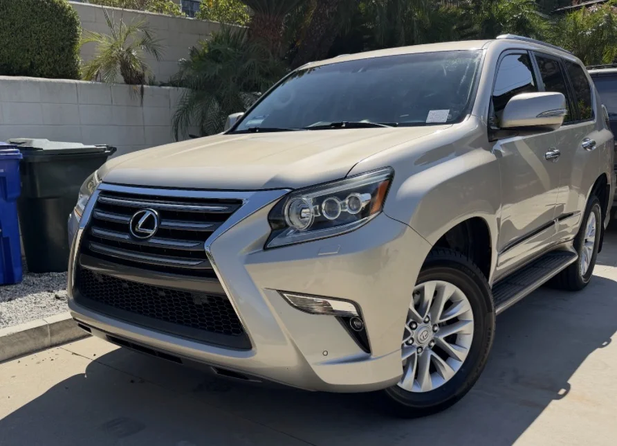

Just picked this up. 2016 Satin Cashmere with Noble Brown interior. Had to search awhile for this one…color very similar to my old 1994 80. Needs lift and tires pronto!
