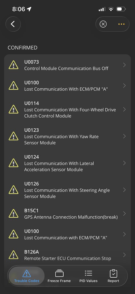

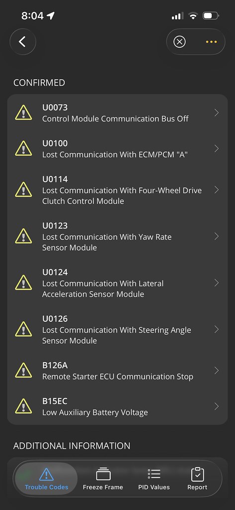

My GX electrical saga continues.
I would loooove some help getting to the bottom of this. Short of driving 1.5 hours to a friend's house to use his Techstream or paying someone to diagnose the issues, I'm at a loss. It's driving me insane (and killing my love of this vehicle). 2018 GX460 base, for context.
Here's the situation in a nutshell:
Occasionally, without seemingly any reason whatsoever, I get a full gauge cluster worth of warning lights. Listed in no particular order, they are:
  • Check Headlight System
  • Transmission Fluid Temperature High
  • ABS
  • BRAKE
  • Traction Control Malfunction/Off
  • KDSS
Additionally, the gauges sweep back and forth then the speedometer stays at 0 MPH and the RPM needle bounces up/down off idle. I also get the thermometer on the gauge cluster saying E*F. The gear indicator will also vanish.
Usually, after a few minutes, everything except the the traction and ABS warnings will disappear. Sometimes everything stays on until I park.
The weird thing is that, most times, the warnings are completely gone when I restart the vehicle a few minutes later. Weirder is that the truck drives perfectly normally even when all of the warnings are present.
There really seems to be no rhyme or reason behind when things come and go. Any pattern I thought was present-- it happening under hard braking, etc-- seems to not hold water. Today's round of warnings did come when driving over a particularly rough surface, for whatever that's worth.

On the bottom of that code list there is a “freeze frame” icon or button. That may tell you what the vehicle was doing when it threw the codes (rpm, speed, voltage, temp, etc). Really could help diagnose certain issues.

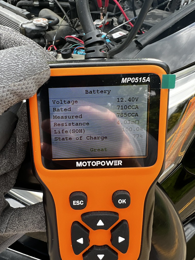

Shouldn't it be cloawe to 13.5-14 volts if its running?
Ah ok I'll check that out later
Battery was tested with the engine off, as per instructions from the tester
My bad
