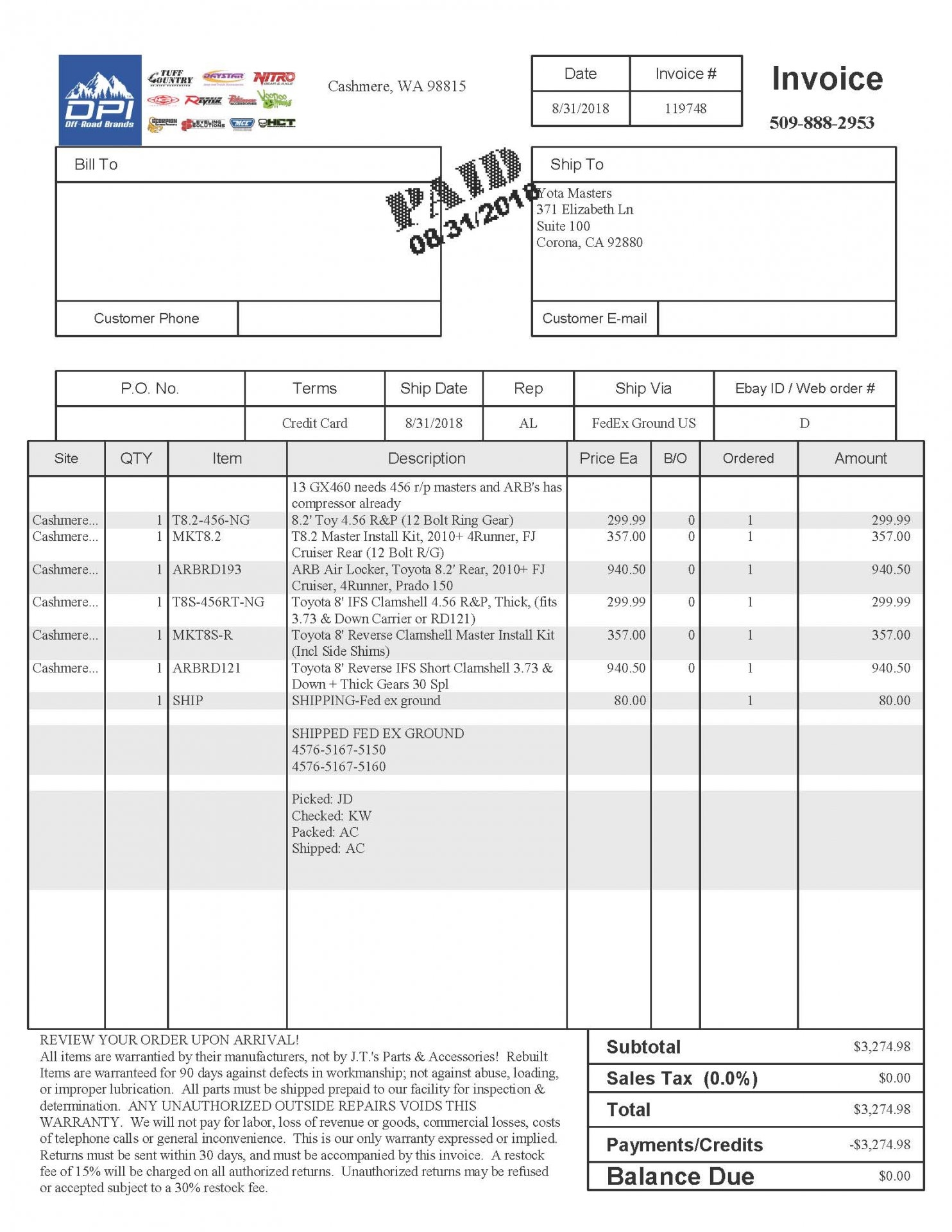

I've got ARB front and rear lockers with the ARB dual air compressor under hood and regeard both diff's for larger tires.
Below will tell you exactly what you need or you can go to my build thread Builds - R²M 2013 GX 460 Overland Build - https://forum.ih8mud.com/threads/r-m-2013-gx-460-overland-build.1104719/.

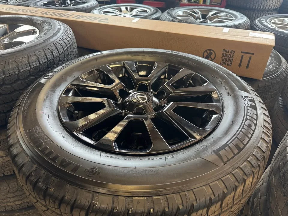

My OEM steelies got some serious rock rash.
Another reason to leave the alloys at home.
