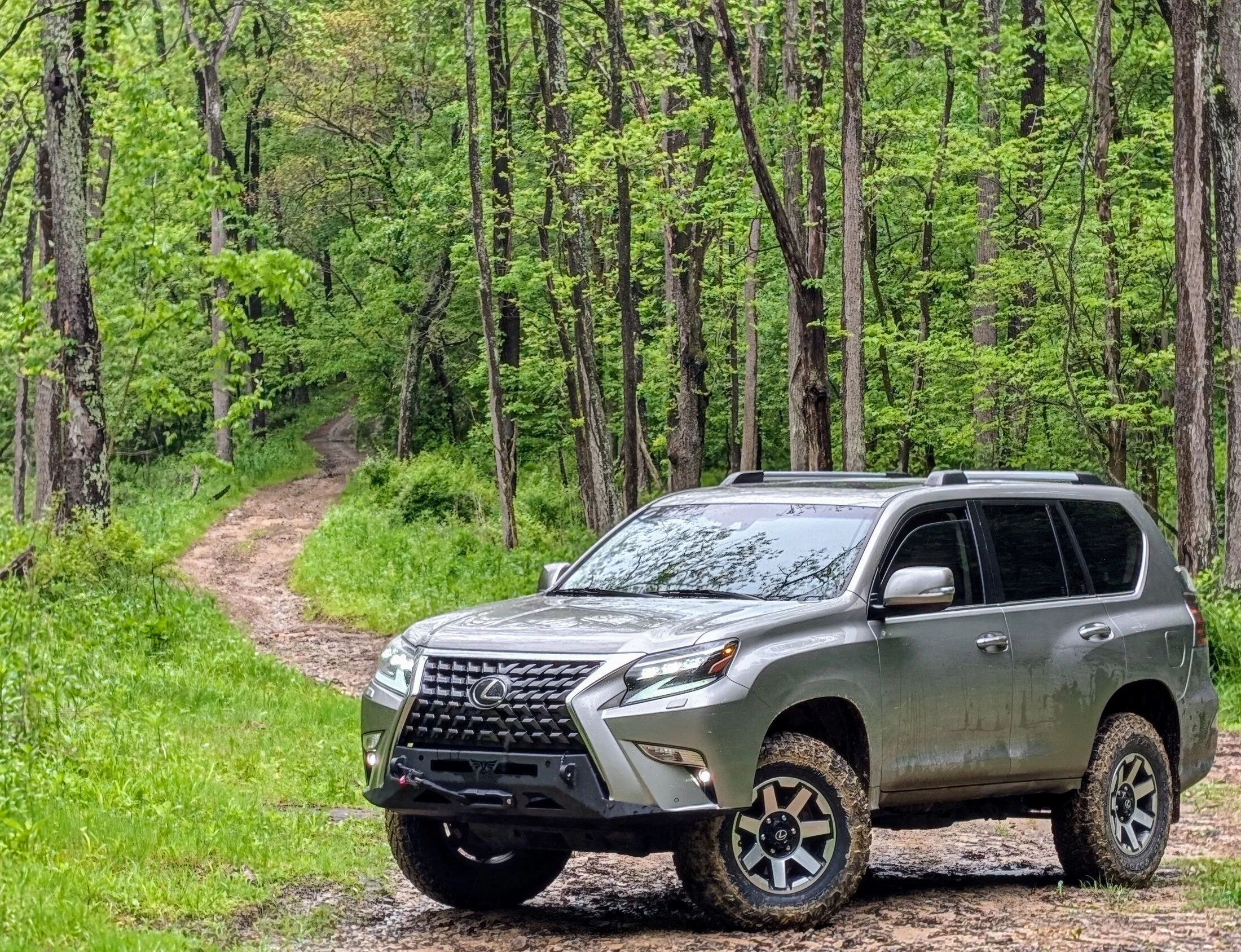

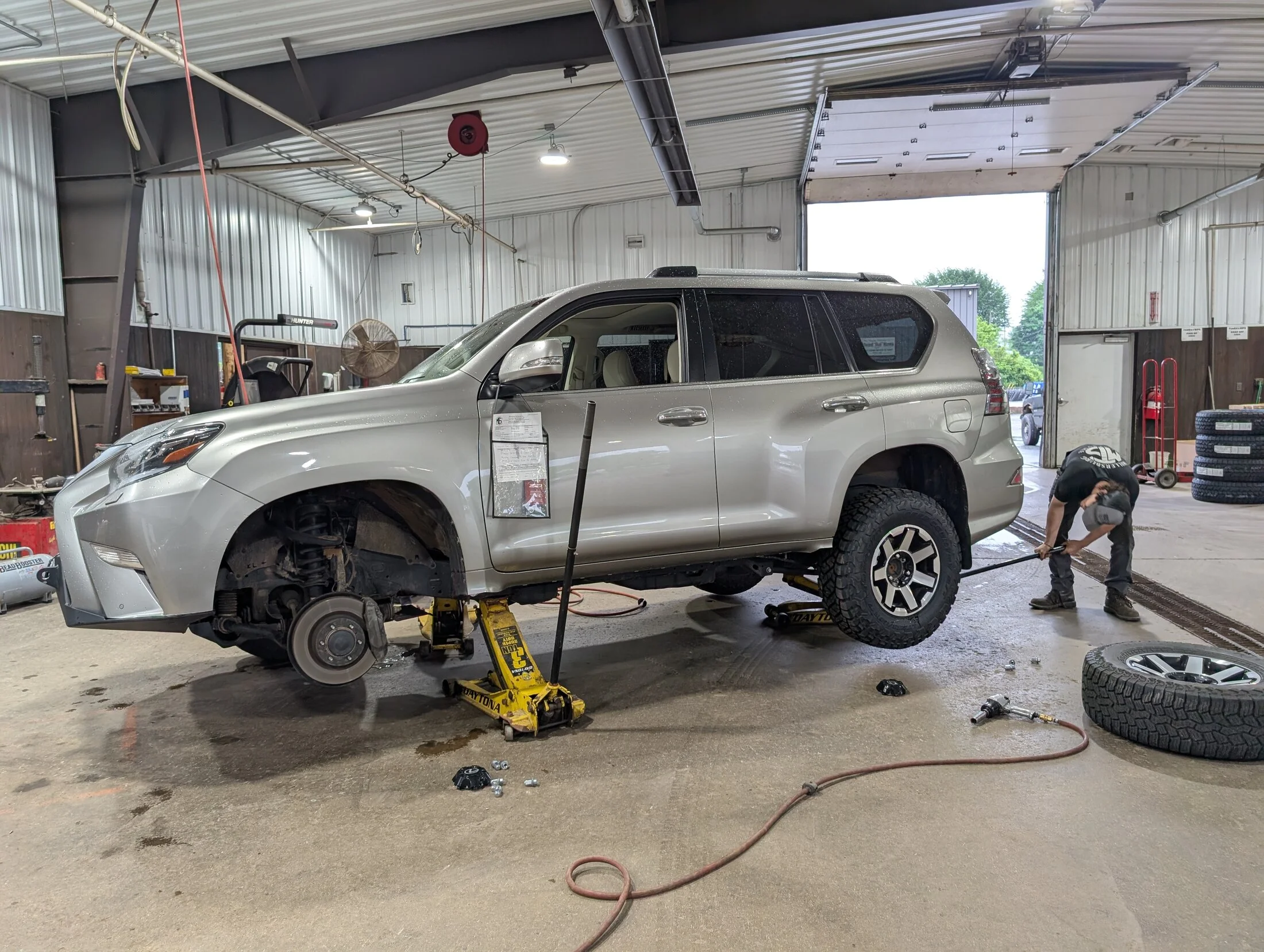

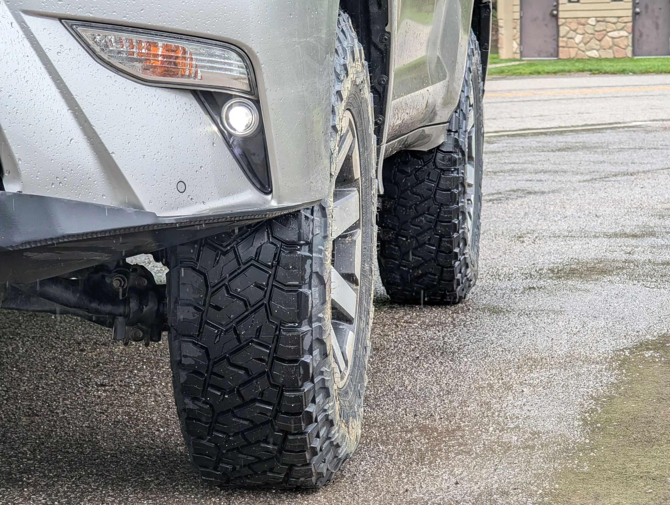

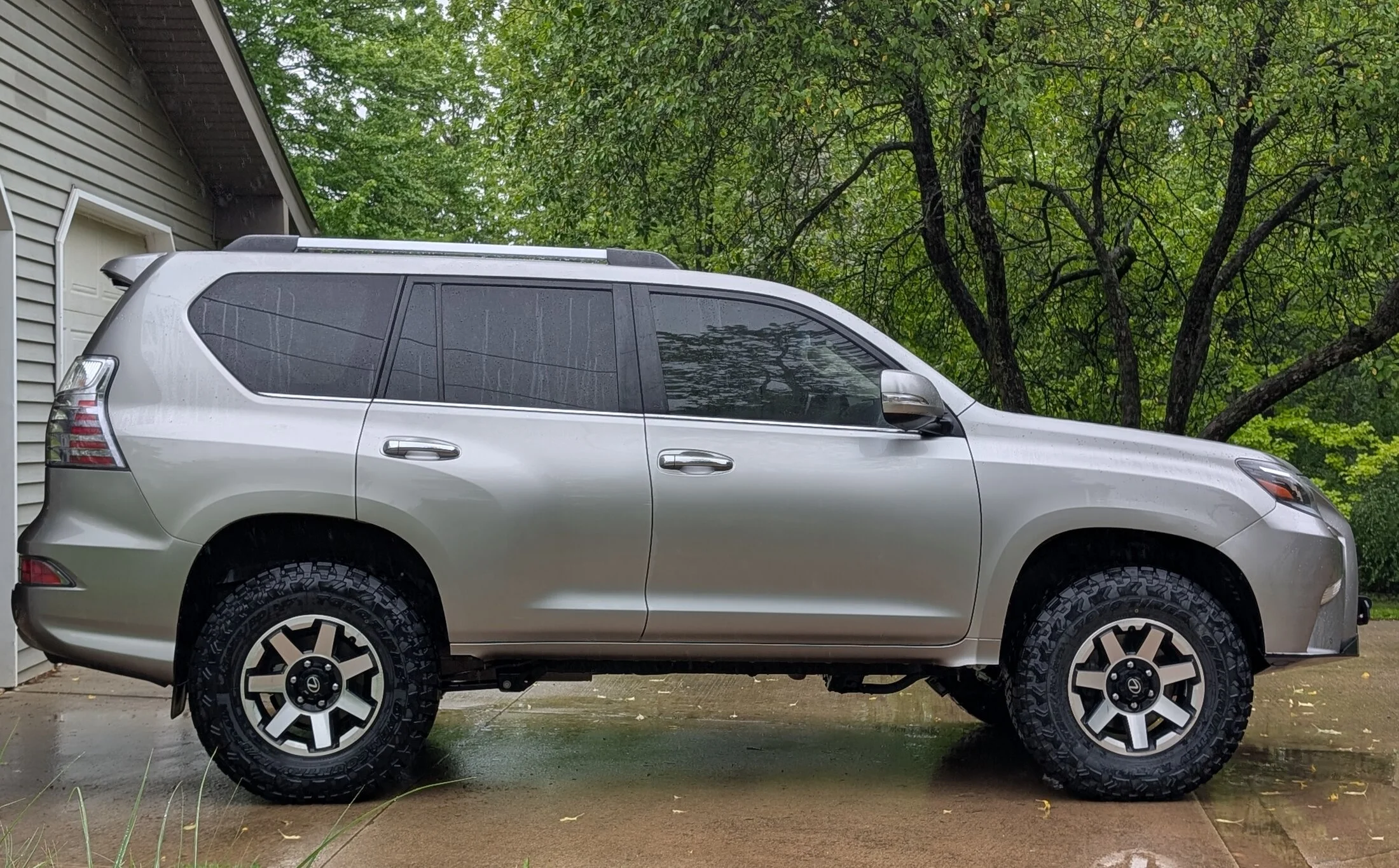

255/80 17 aka 33" pizza cutters follow up --->
Toyo Open Country R/T load E
As I explained in an above post a page or two back, I have a 2020 base w/ 1.5" F / 1.0" R lift, and 4Runner OR wheels (+15 mm offset, 7.5" wide).
I was running Falken Rubitrek tires in 265/70 17 load SL, which I liked very much, but I wanted a bigger tire to fill the well better and maximize my ground clearance.
Size comparisons between stock, 265/70 17, and 255/80 17:
Stock 265/60 18 Dueler H/T: 30.6" diameter, 10.8" wide, 37 pounds
265/70 17 Falken Rubitrek: 31.7" diameter, 10.8" wide, 47 pounds (1.1" larger than stock)
255/80 17 Toyo O C R/T: 33.1" diameter, 10.0" wide, 54 pounds (2.5" larger than stock)
I had the Toyos installed today and the fitment was perfect. I have no rub on full lock turns forward and reverse; and I did some off road with partial articulation and could not detect any rub under articulation. The tire guy was pretty astounded. There was actually a good bit more room especially up front, the tire was nowhere close to anything.
Cost was $800, including a trade in on the Falkens. I did not replace my spare, it is still a new Rubitrek 265/70 17. That is a problem for Future Meef.
Driving on road at 40 psi seems much the same as the Falkens at 33 psi, with the caveat that the steering seems pleasantly lighter now, which makes sense since there's less tread width; although there is more weight. Braking seems the same. Traction / cornering seems the same. Wet pavement performance (it was raining) seems the same. Acceleration seems the same. I did not detect any "trolleying" or tracking in pavement grooves on road. I could not assess fuel economy over the 50 miles, so I will report on that later if warranted (I expect it to be very similar). Road noise is slightly increased but not noticeable unless you are listening for it. Speedo reads 55 but actual speed is 58.
Off road at 40 psi in moderate mud with a rock base under it I felt performance was on par with the Falkens. I did notice that the skinnier tires had a tendency to want to get into ruts, and the side lugs didn't really seem to be working great in keeping me up on the sides of ruts, but there was no drama. Airing down will improve that, I think. As these tires are tucked in just a hair more than the Falkens, there was little mud up the side of my truck, which I simultaneously appreciate and resent (better pictures with that mud, yo!).
Appearance-wise, I think these look significantly better. When I bought this truck bone stock 9 months ago, this is the look I was envisioning. The Falkens got me close but I always thought they were just a hair too small, although their performance was great.
Pics:
Looks good! I was looking at those, but wanted to keep the weight down as much as possible so went with another 33" option (285/70/17).
If only they made a SL-rated pizza cutter tire.....
Yeah. What's the weight on your 285 though? Got to be close to 50 pounds. At that point what's the difference, practically speaking?
48lb, about same as the 32" tires I replaced them for.
Plus my rims are 17x8.5, maybe too wide to fit a pizza cutter?
