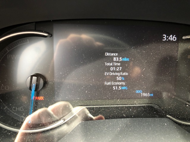

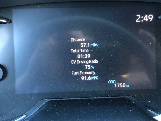

I agree about the last part, I bought both GX's knowing full damn well the fuel economy was s***. It just is what it is. This is one reason why I sold the 470 and bought a RAV4 Prime though, getting 35-90+ MPG week in and week out is starting to save some money with bidenflation's high fuel cost. Almost 3,600 miles in and we are at a lifetime average of just over 40 mpg total. We do a lot of highway miles @65-75 mph so the engine's MPG suffers a bit but still gets more than double the 470 we replaced it with and our 460. Check out these two examples.
Something to consider, higher octane resists knock. Yes the ECU can compensate and that's where the slightly poorer performance and fuel efficiency comes in. Simply put for me personally I'll take the few extra $$ to make 100% sure nothing happens.
Yeah, I had a Ford C-Max Energi PEHV that I used for my city driving. ~80 MPG while I owned it. I'd go for days without the ICE ever starting, because I made so many short trips on electric only.
