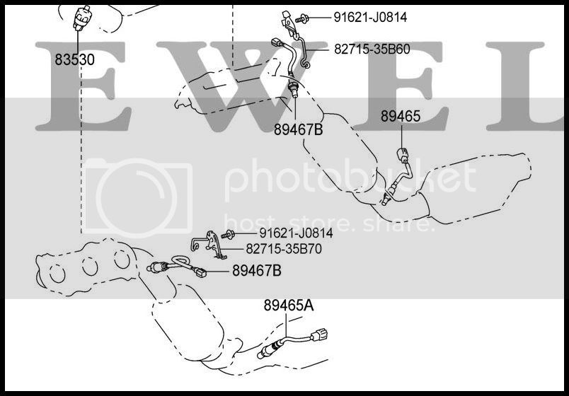

Im not getting any codes but I'll swap the O2 sensors out just to see if that helps. I checked on Sewells site but Im a little confused. Theres only one sensor upstream and one down but Lexus is showing O2 sensors with 2 different part numbers with different pricing, which is correct or are they both the same?
89465 and 89465A
2005 GX470: OEM Electrical (SWITCH & RELAY) Replacement Parts
http://i140.photobucket.com/albums/r34/rrcompton/Lexus GX470/sensors.jpg
I just called up Sewell and they said the correct part number is the 89465A, the other part number is old and they didnt take it off of their catalog. I told them I knew I wasnt crazy, theres only 1 sensor downstream per side. LOL
