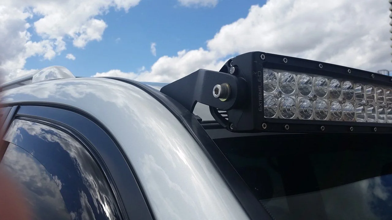

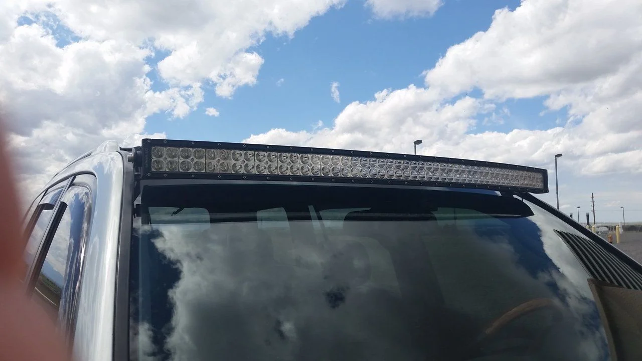

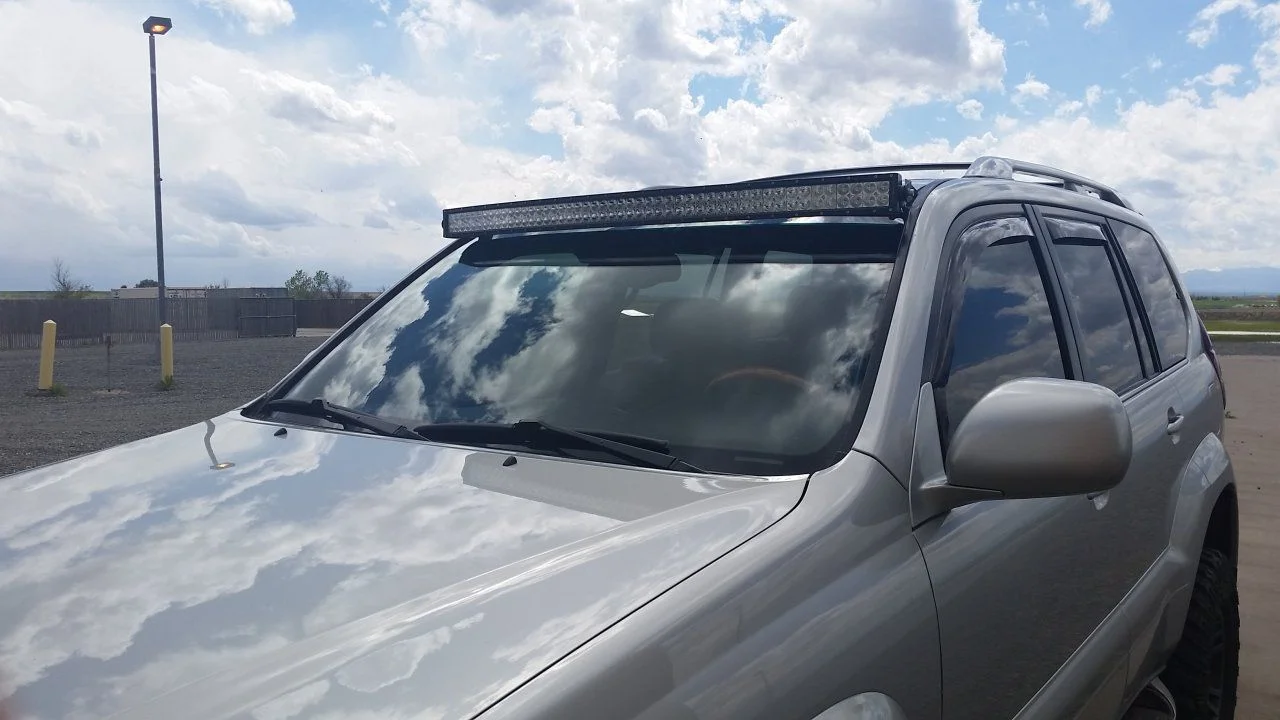

I added a 50" curved LED light bar from ExtremeLED, the mounts were custom fabbed working with Insane Fabrications Home He will have them available shortly. I wanted it close to the windshield and so far after two weeks I have no vibration or wind noise from the bar.
I have a relay near the fusebox under the hood with a switch under the steering column. The light is grounded to the mount and the Hot wire runs along side the glass under the windshield trim.

Thanks for providing info on the light bar mounts....your light bar is very neatly installed.

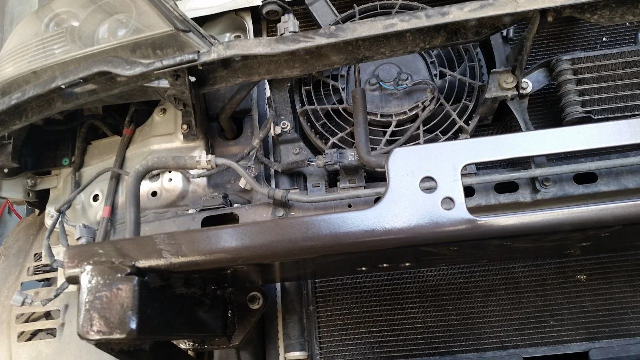

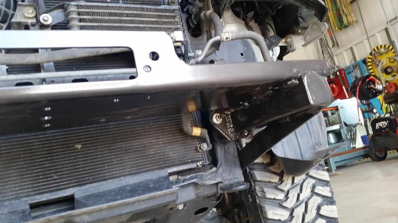

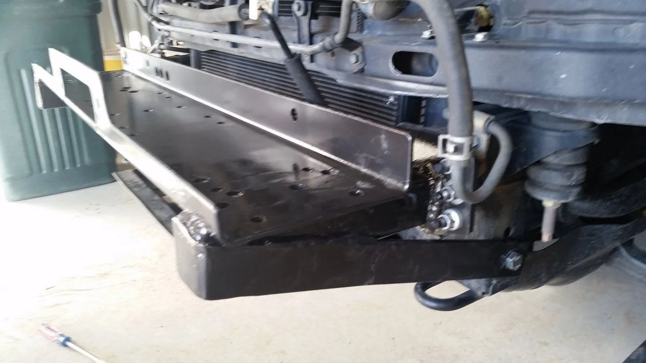

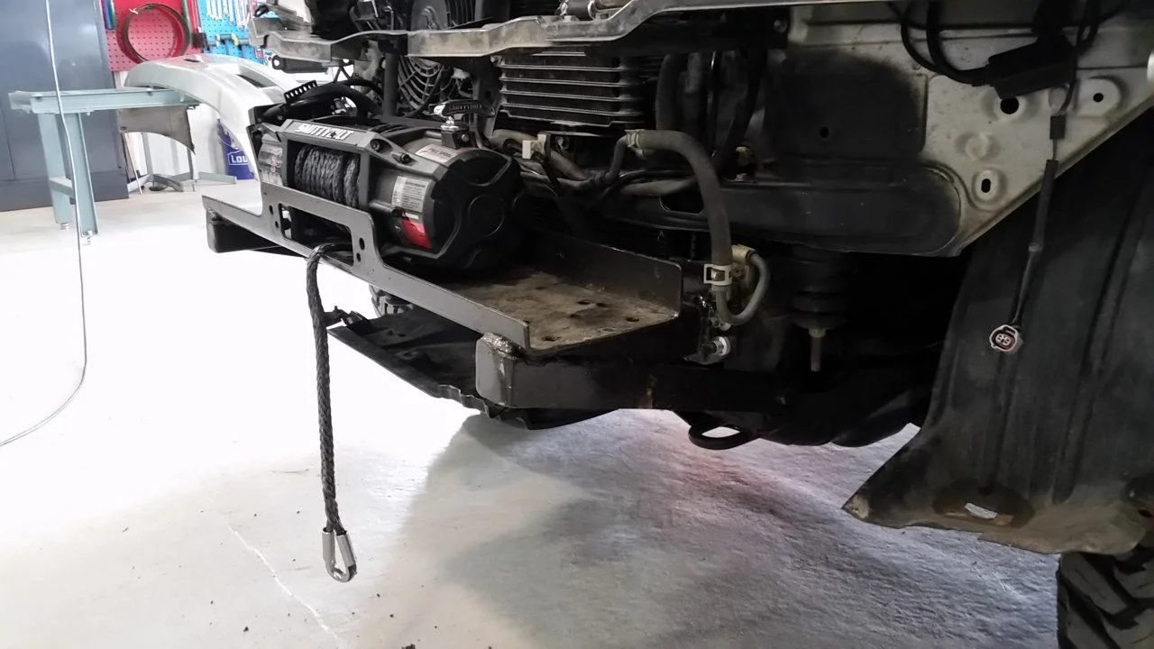

Did you do a write up on your clean winch install?
I have been researching about the Doug Thorley headers with high flow cats and worried about a CEL due to excess airflow.....looks like you haven't had any issues which entices me to do a similar set up! As another member has said here...thanks for sharing your mods.

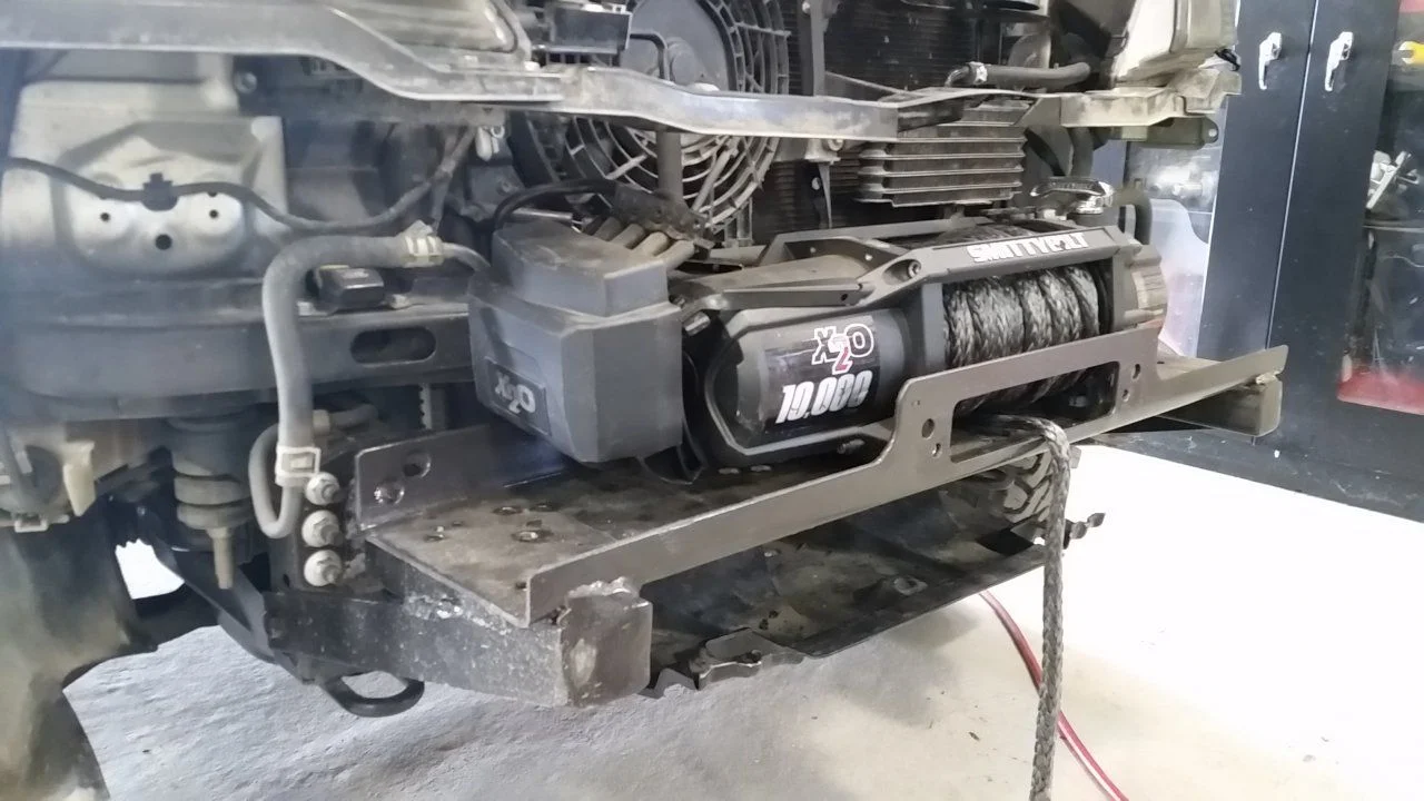

Sorry I did not do a detailed write up on the Winch it was more a Fab and go type of thing I used 1/4 wall square tubing and 1/4 steel plate to mount to the frame at the bumper mounts I closed off the ends of the square tubing and welded a winch mount plate I got off Amazon I also have 2 mounts that go back to the frame using existing threaded mounting holes. I got the wireless set up and mounted a switch in the engine cowling to turn the wireless unit on, the clutch is accessible from the top side under the hood I will get pics with the hood open. As far as the Headers 15,000 Miles and no issues I did have to add O2 spacers to the rear O2 sensors because I was getting the P0420 and P0430 codes, more info in the other thread regarding install of the headers and excess airflow,
