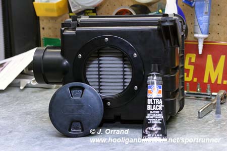

Research this forum a lil more because I'm sure you'll find some useful info regarding the airbox mod. I don't know if you should add a pipe/tube that extends the opening to behind the headlight. That might actually choke some of the airflow. Also, for hiding purposes, there are a few mods on this forum that might apply for you. Take a look at Bama's upgrade, pic below, and you can see that you could screw in a "plug" to hide the hole...

This is what you use: 4" Deck Plate for a Boat
The reason you use a deck plate and not a PVC fitting is so that you can screw the "cap" back into the hole, and put the box back into a "normal" OEM configuration. If black, it's not very easy to spot, and looks somewhat factory for the smog nazis. You can also put the cap back in the deck plate for water crossings, which was the primary intent of using something that is water tight (boat hardware).
This is how you install it: LINKY

How many of you guys would be interested in an open deckplate/closed deck plate dyno comparison on a 100 series cruiser?
I may do this mod and throw it on the dyno, I'm curious what the cruiser puts to the wheels stock.
I have always been interested, it's just taking a drill to my airbox that gets me everytimes
dyno would be awesome!
+1 on the dyno, those numbers are always helpful.

Drill to air box is not a biggie.
On the dyno truck, do you have DT headers?
I don't, my cruiser is a stock motor 98. I have three dyno's at work, so I figured I'd pick up a deck plate today, throw it in, and get you guys some numbers on monday.
