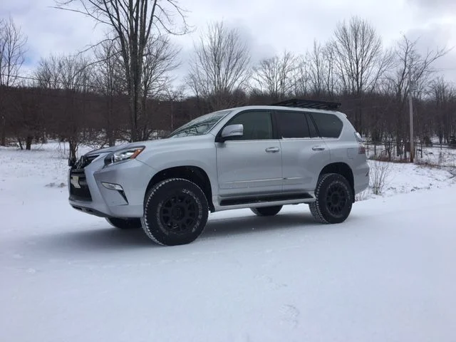

I recently went through the same shopping process as you and ended up with a 2008 LX570. So far I've only changed out the wheels and tires:
It checked all the same boxes for me balancing budget, comfort and capability. I was not scared off by the AHC. It's vastly improved for the 200 series. And I'm not building a monster—just wanted something to get me off pavement once and a while.

2" inch BP51, 34" tires, 4.56 front and rear, ARB at both ends. I still dont like the front facia but i will eventually install a custom bumper.
The rear door is something that I got used to in few weeks.
They are both good cars but until you drive both back to back you will not see the difference between. Good luck. View attachment 1511050
