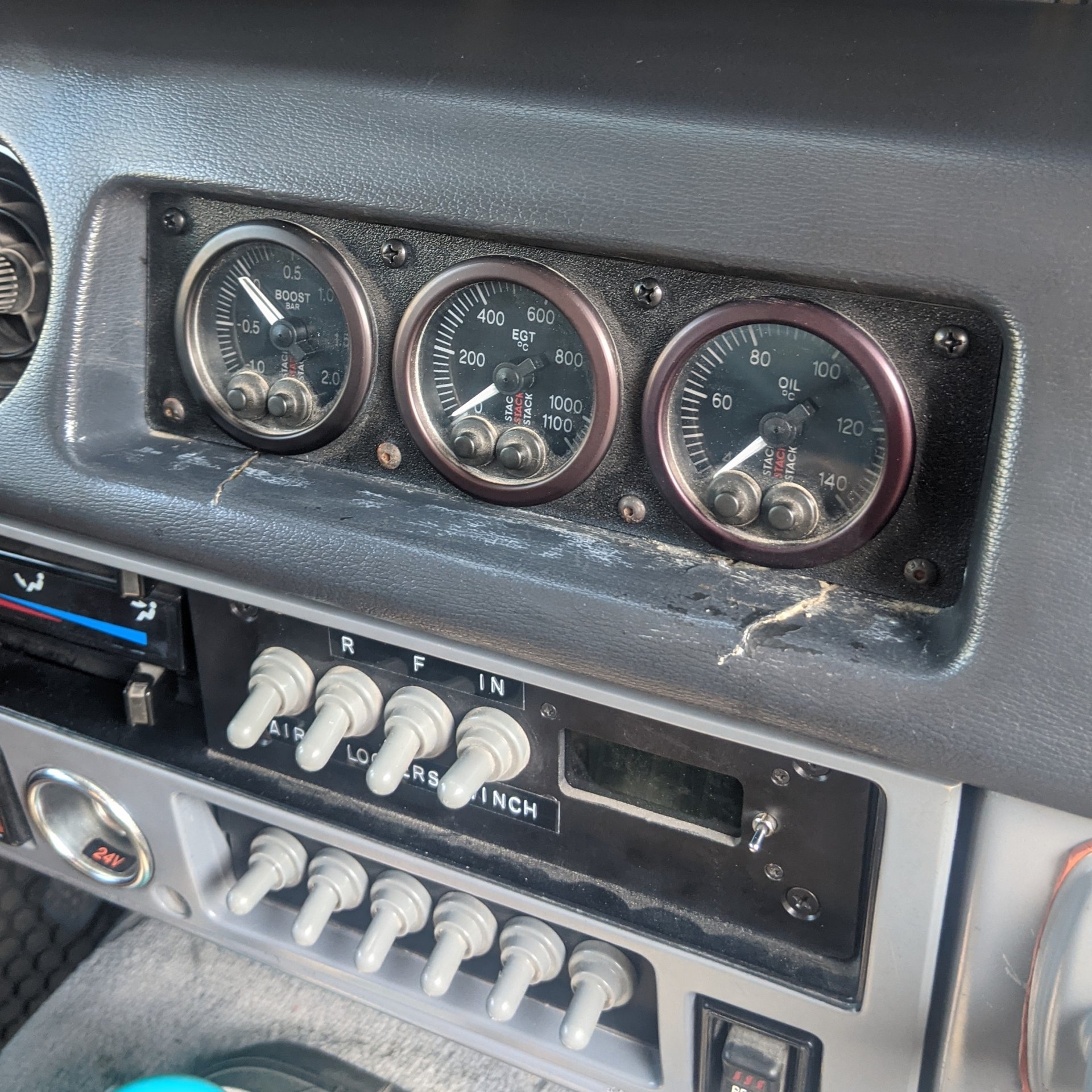

Some of the rats nest coming out. Unfortunately the connectors on the back of the gauges are an AMP design that I don't have crimpers or parts for.

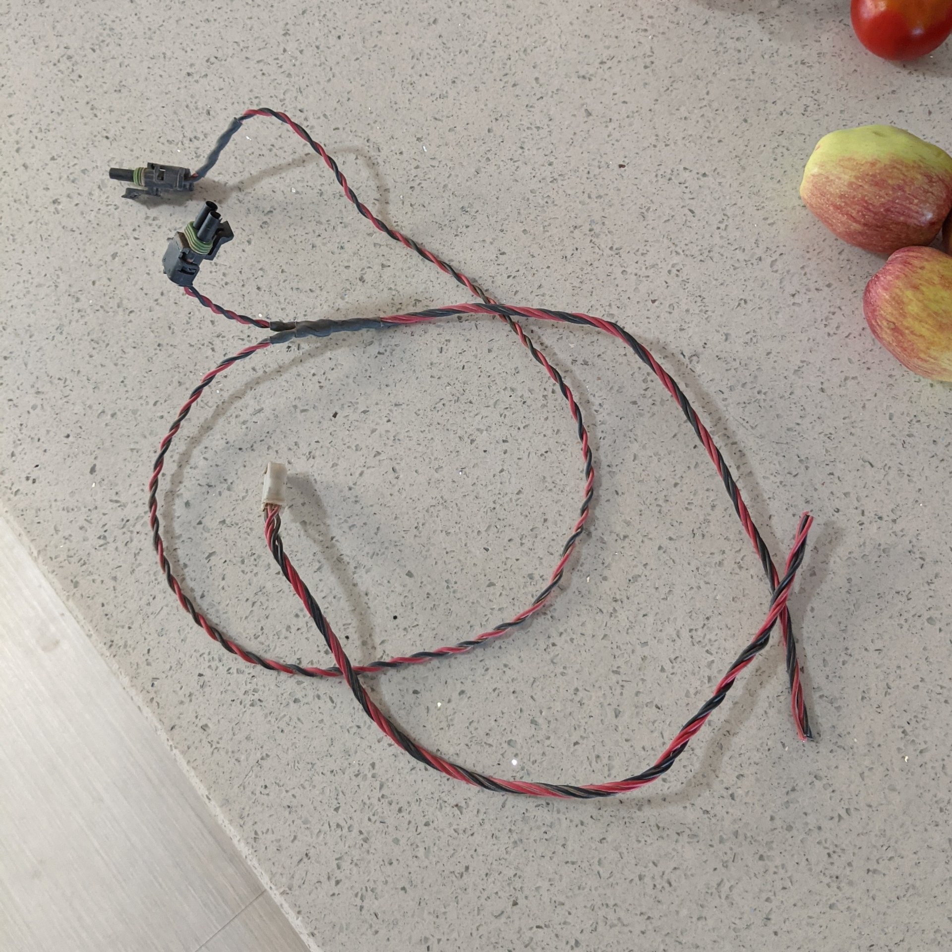

Rather than hard tapping the factory harness all over the place to pick up stock signals, I opted to build some inline taps that use the original connectors.
This worked great conceptually, but (a) they're a little large and there's not a lot of room right behind the clock and lighter so they're difficult to shoehorn in there, (b) the wire routing would have been cleaner if I'd put the tap lines coming out of the male side of the connector, and (c) the stock harness is really designed to plug directly into the clock and lighter so adding additional length to the harness makes it difficult to bend the connectors around to all land in the right place.
Not sure how to do this better aside from maybe making these a little longer, or maybe biting the bullet and just re-terminating the stock harness to include these taps as double-crimps.

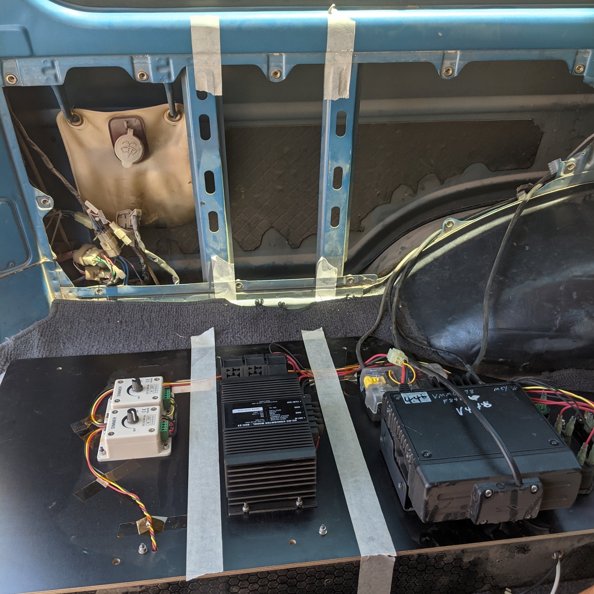

I really should have taped off the location of these support pillars and laid out this panel better the first time around. Anyway, replaced a temporary set of relay holders with a 4 pc relay block from Del City. Overall it seems like one of the better relay holders out there, though this whole space is kind of crappy with 0.250" fast-ons providing connectivity to the ISO mini format. Fast-ons really don't seem meant to be retained in a housing very well.
One of the relays controls the radio power - since this is a 24V system and radios all run on 12V analog amp stages, I've got to DC/DC convert down and of course the DC/DC converter has vampire drain. The relay is controlled by a switch that selects ignition or direct power, so I can have the radio come on with the ignition or manually turn it on if I want to run it in camp for some reason. Ironically the radio itself supports this with an ignition sense line, but that wouldn't help with the DC/DC converter vampire drain.
The other relay that's currently operational switches rear lights that I've had installed for years but tried to put on a dimmer that sucked. I highly don't recommend Skene Designs dimmers, they're flickery garbage that you have to install on the ground side of the circuit, making wiring a huge pain in the ass.
Anyway I'm mostly happy with how this panel turned out - I should have skipped the temporary relay block as now I've got extra holes in the panel. It holds all of the electronics pretty well, but it's hard to stuff the cables into the cavity so they don't get pinched when re-installing. I'm not sure if I could have still fit everything without the interference fit of the radio though, so ¯\_(ツ)_/¯

Finally, de-rusted some hardware while I was at all of this, as well as started to label switches that now are on their way to doing something!
Oh, and replaced the garbage adapted rigid tubing that came with the boost sensor gauge kit with some regular old, you know, vacuum hose that hopefully won't fail nearly as much as the rigid tubing adaptors.
