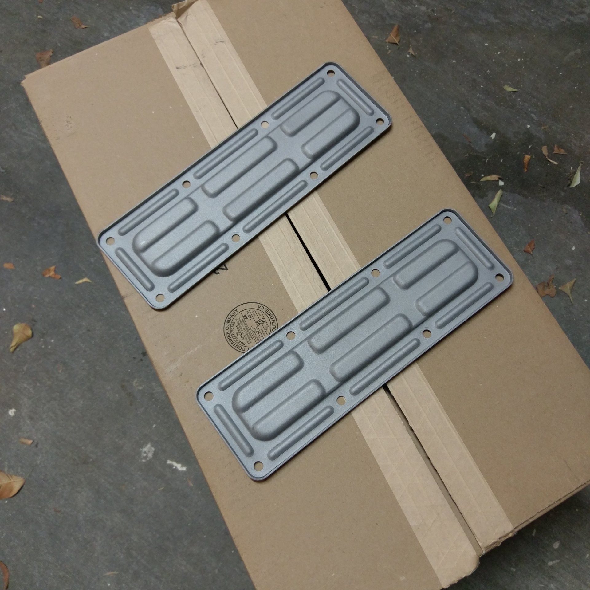

Should have taken my own advice and re-finished all parts at the same time. Doing these lifter covers later slowed me down by a day, but it was good practice for prepping the inside of the tailgate for a wagongear hatch (which is really why I was bothering with the clearcoat).
I can recommend the USC Spraymax 2K rust cure primer and clear, seems to work remarkably well for a rattle can finish.

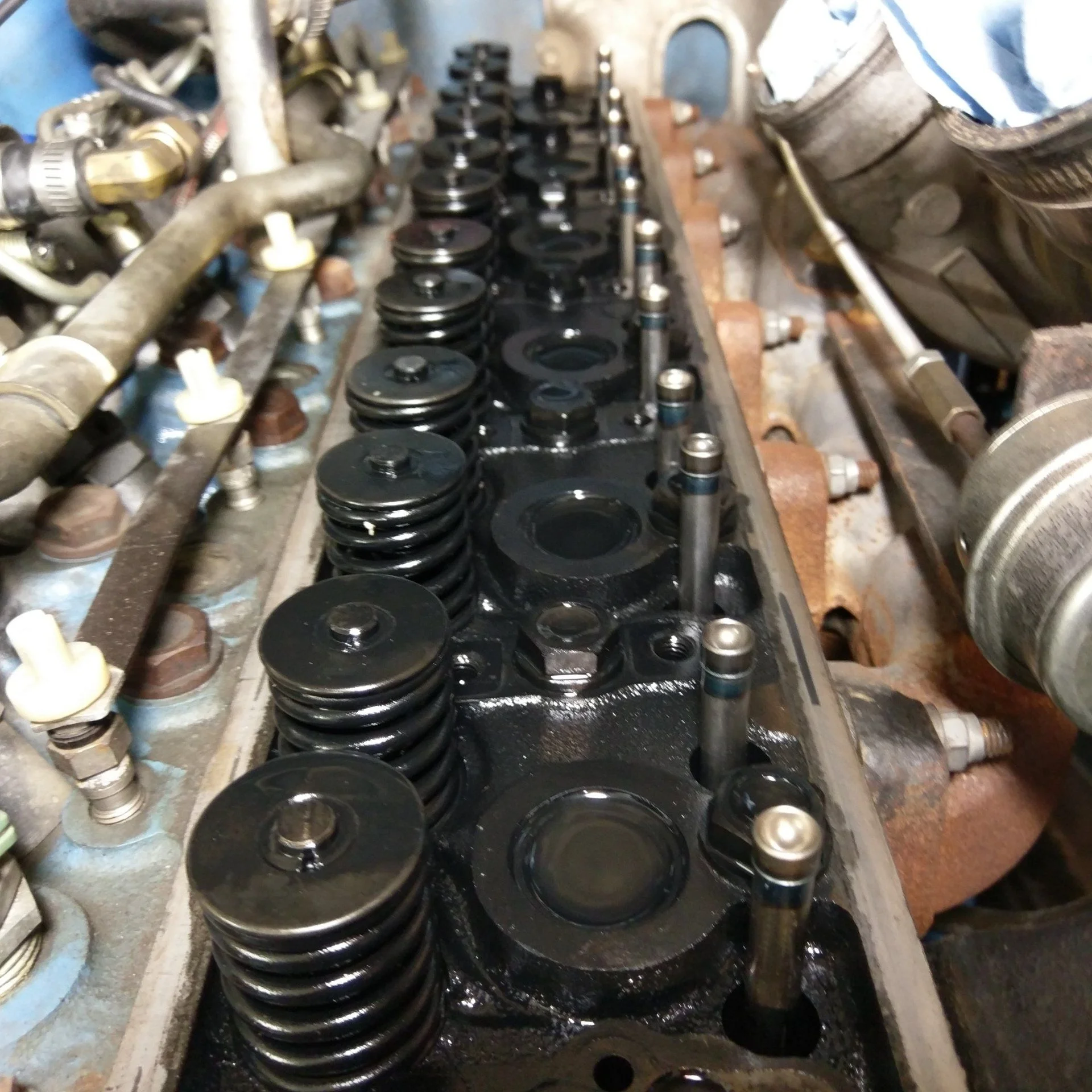

Decided to put in a new radiator while I'm at it - I repaired the old one about two years ago, but who knows how long that'll last. My current approach is to buy replacement parts while they're available as more and more are being discontinued and at that point the only choice will be to repair instead of replace.
Somewhat remarkably the motor ran after reassembly, although it was rough as hell on account of the new lifters and pushrods. I did a feeler gauge valve adjustment that didn't make much difference, and only realized later that I should have probably inspected the rocker arm faces for wear - my guess is that they're probably getting worn. While doing that valve adjustment I discovered that two of the adjustment screw lock nuts were seized in place, so I found a handful of adjustment screws locally and replaced the worst of them. If I can find some more I'd like to replace the rest while I'm at it as they're all sort of sticky. Barring that I guess I'll chase the threads next time I'm in there.
After doing a dial indicator adjustment the motor now runs super smoothly minus what sounds to be an exhaust valve tick on one of the cylinders. I don't know if that was there before, or I'm just hearing it now because I'm conscious of trying to get the valve tune right. In any case, I'll have to dig in again to find the bad valve.

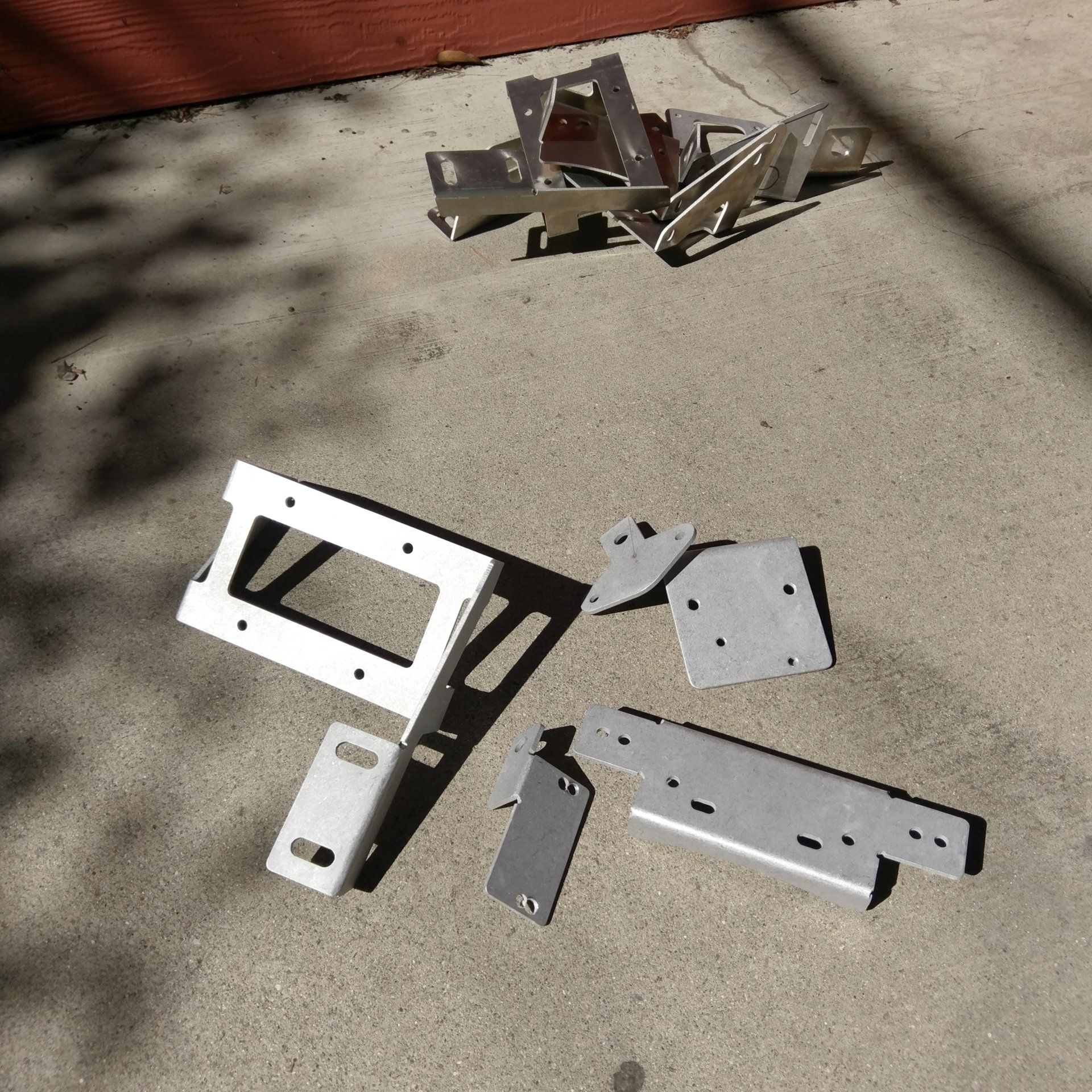

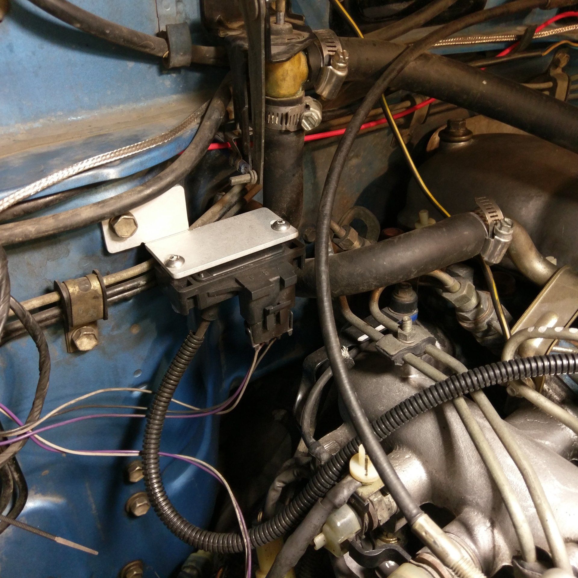

While waiting for the steering gearbox to come back I thought I'd clean up some of the wiring and accessories that have sprouted around the engine bay in the last while. I've wanted to add a battery cut off to make it easier to work on the electrical system without disconnecting the terminals all the time - even with 'military' style terminals it's still a hassle. I also needed to clean up a nasty bracket I'd made to hold the various on board air switches and solenoids, and finally I thought it'd be nice to relocate the winch controller inside for a cleaner front end look.
Now that Onshape and Fusion 360 have sheet metal support, I thought it'd be a good opportunity to use some free-ish CAD tools and learn how sheet metal works. Lesson #1: just because you can bend it in software doesn't mean you can bend it in reality :)
Fusion 360's automatic McMaster part import is super handy for mocking stuff up against McMaster hardware, and (at least here in LA) McMaster's same-day delivery is almost as dangerous as Amazon's - it's a winning combination for getting stuff test fit in a hurry.
I stubbed out models of the devices or hardware to interface with, as well as various hole patterns in the engine bay and on the frame. From there, I modeled brackets and then sent the flat patterns off to the waterjet or cut them by hand depending on difficulty. Prick punching through 1:1 paper printouts makes quick work of arbitrary hole pattern drilling.
The most challenging bracket was the battery switch, which touches down on the stainlesstrays.com support as well as some existing captive nuts on the wheel well. This took a few tries to get the fit between the two correct, but it's solid and works out great now that it's in.
If I were to make more of these I'd probably pemsert some captive hardware into the bracketry, but for now nylock nuts on the backside seem fine for the few times I'm going to assemble/disassemble.
Lesson number two: always cut slots to mate against existing hole patterns, without a fancy CMM my measurements are never going to be good enough to pick up centers on standard clearance without a few tries.
