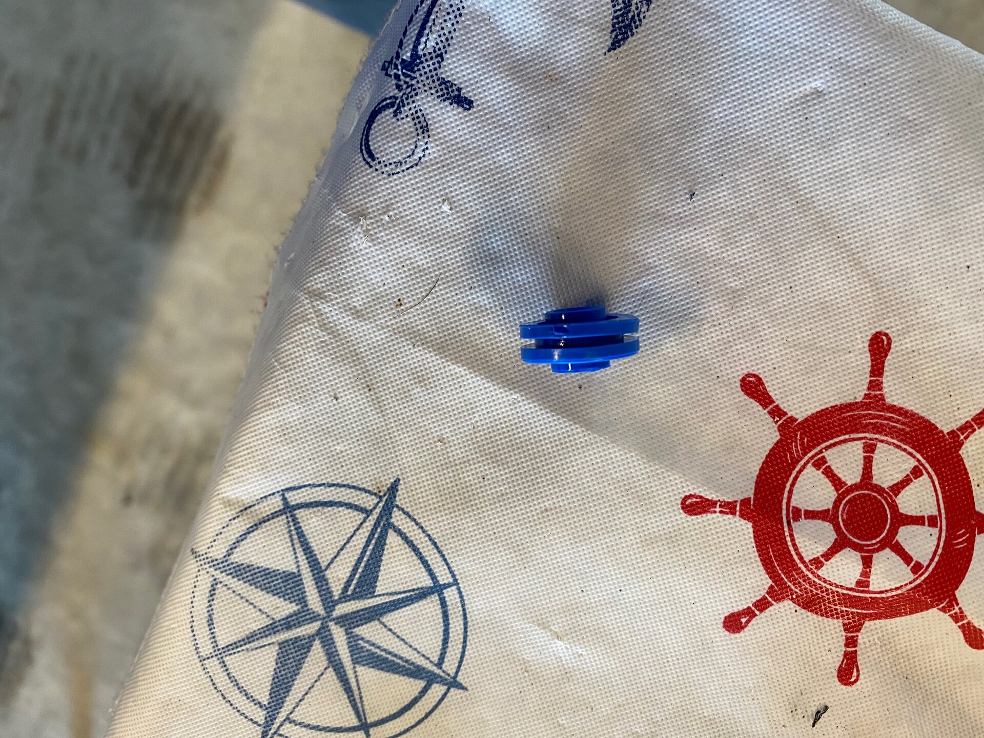

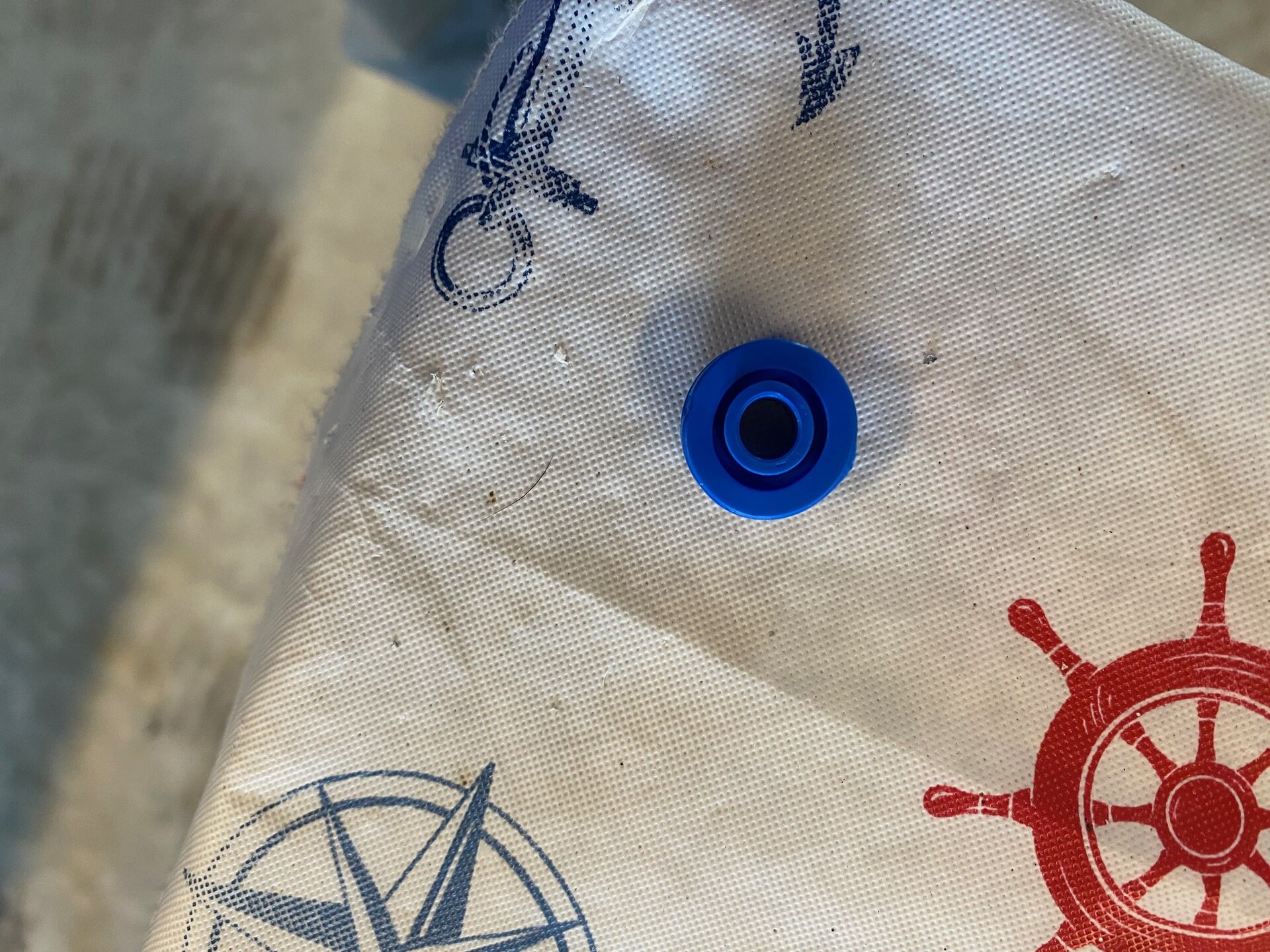

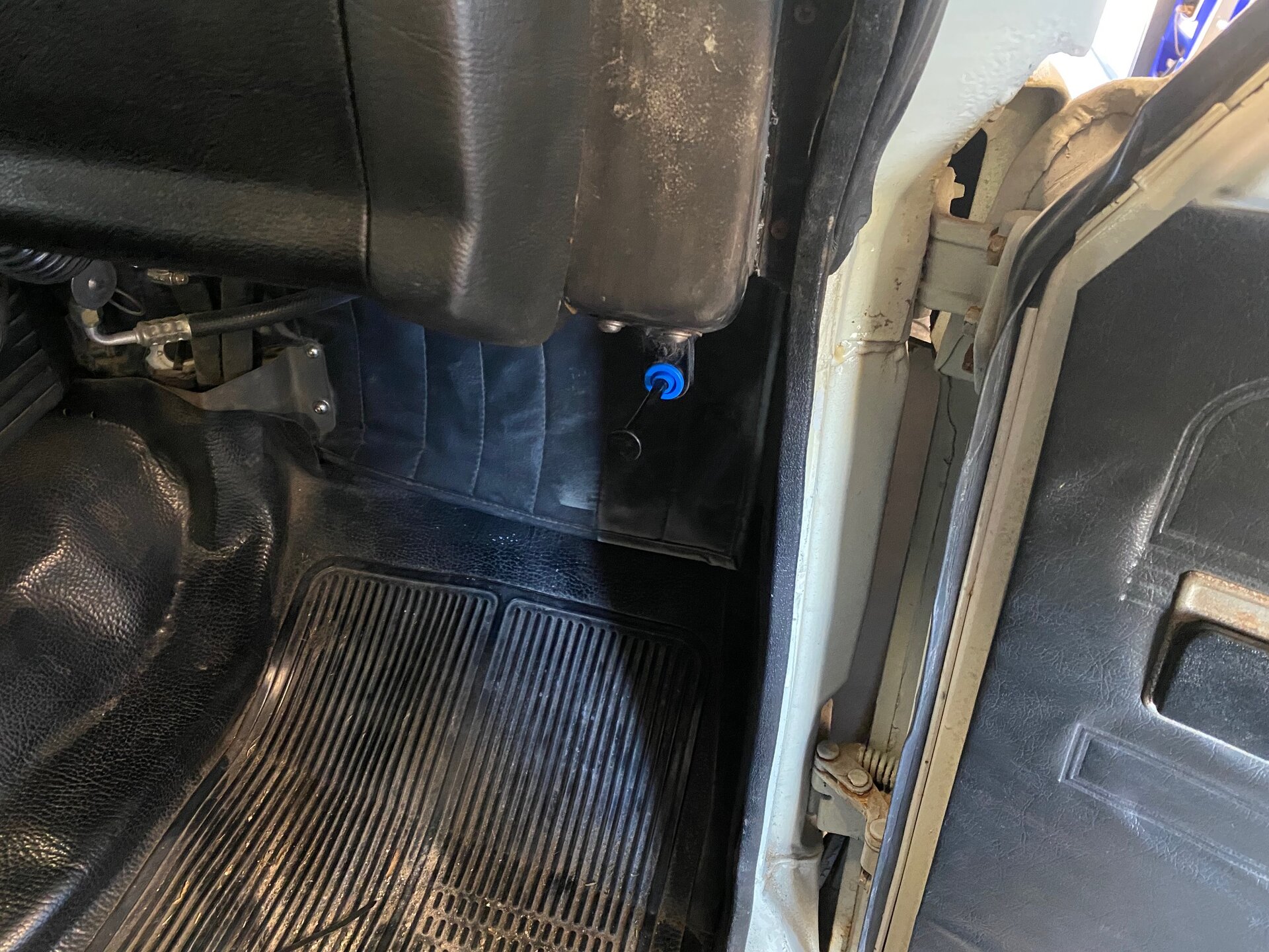

Hello All,
So I realize this VERY minor, but I will pass along all the info I come up with for our Pigs so..... I found these grommets at McMaster-Carr for the front vent pulls. They only come in blue, which is OK for me coz Wilbur's blue & white, but they fit perfectly. I had to buy a bag of 25 and only need a few, so if anyone else out there needs a couple, PM me an address and I'll stick them in the mail to you. I'm looking for every way I can reduce "rattling" and this will help some for sure. If you just can't live with the blue, I did discover these grommets are 1/4" ID for a 9/16" Panel hole and 3/8" overall thickness if that helps anyone in their search. BTW, they are made from a thermoplastic material so they won't dry out like the rubber ones and are more impervious to oil, etc.
Thanks!!
