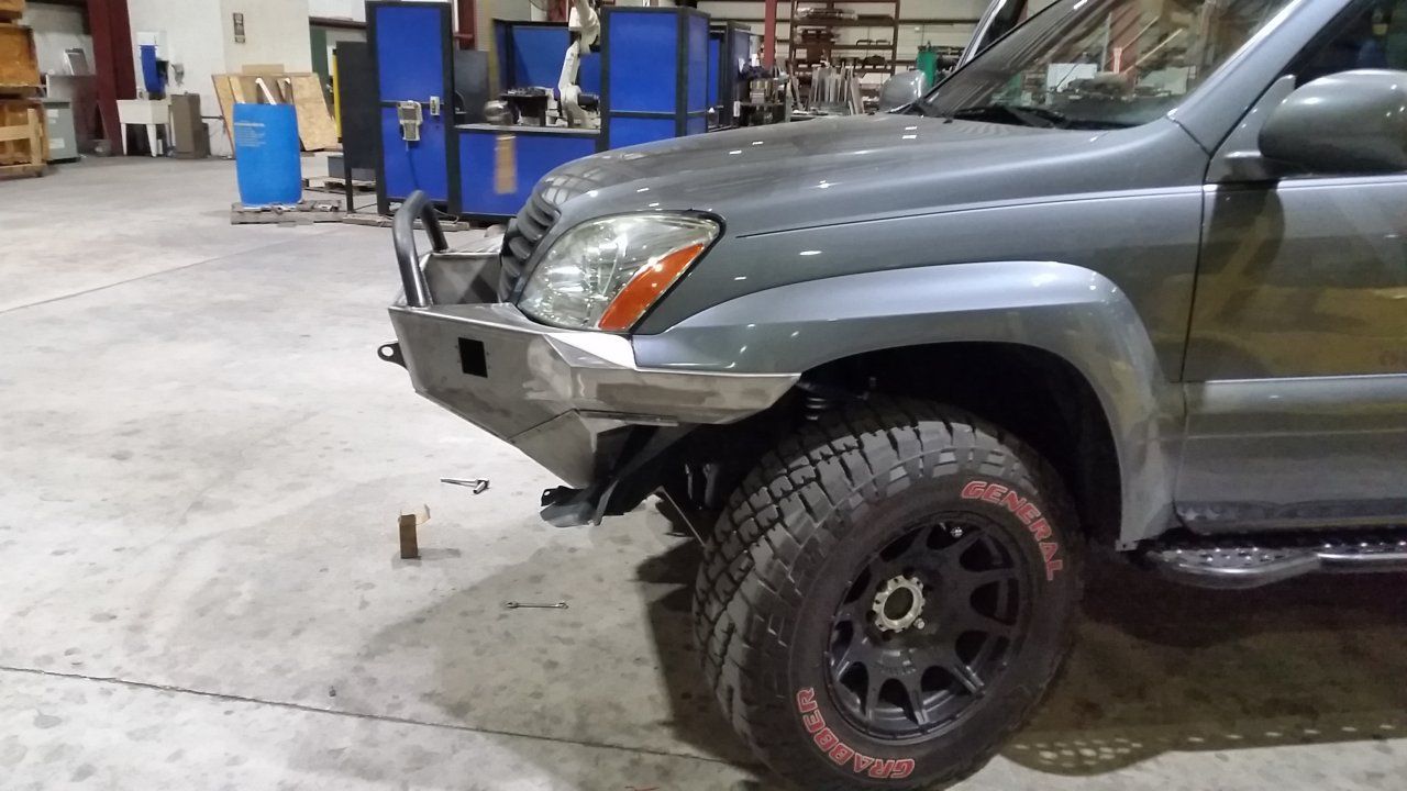

I had to jockey the front bumper around a little, needs some more tweaking but it's sitting way better this morning than it was this morning. I also did some quick welds and put my light bar back on. I need to get a relay to finish it up since I'm going to have it switched off the hi beams but that can come later. Also remounted my Toyota badge on the pro upper.

got the bumper wings trimmed off. i thought i had some 1/8th" steel laying around to box the end together but i can't find it. ill have to pick some up to weld the ends closed.
i had to use duct tape to mark the cut line BECAUSE SOMEONE USED ALL THE BLUE PAINTERS TAPE

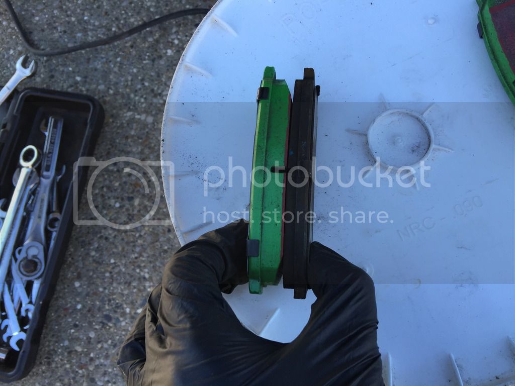

then i placed an order for some EBC Green stuff 6000 series brake pads. going through my paperwork from the previous owner and the last inspection of the brakes by a shop under their ownership was at ~38,000 miles and they were about half way through their life. i can only assume that my heavy braking habits at nearly 80,000 and they're due for a replacement. i can't really be bothered to take these wheels and tires off to inspect them with the level of apathy i have going on today.
anyway, these Green Stuff pads should be awesome and offer about 30% more stopping performance over stock. i ran the Yellow stuff on the front of my Jeep with 37" tires and it worked awesome, but it ate through those pads every 20,000 miles, and at $150 bucks for a pair them, no thanks.
also ordered a pair of H9 bulbs to swap my H11 low beams out with. should double my available lumens out of the low beam
did my brakes. WOW what a difference. huge improvement on the pedal feel and initial bite of the brakes and for the first time since it was stock, i can lock the brakes up cold (with E rated 35x12.50's)
i was super surprised with how the pads change out on the front calipers, i never really looked at them when i had the tires off before - but the whole cartridge concept was really cool.
old vs new on the front. the old ones had ~75,000 miles and were the original blue Toyota set
rear pads were even thinner, which i was surprised at.
