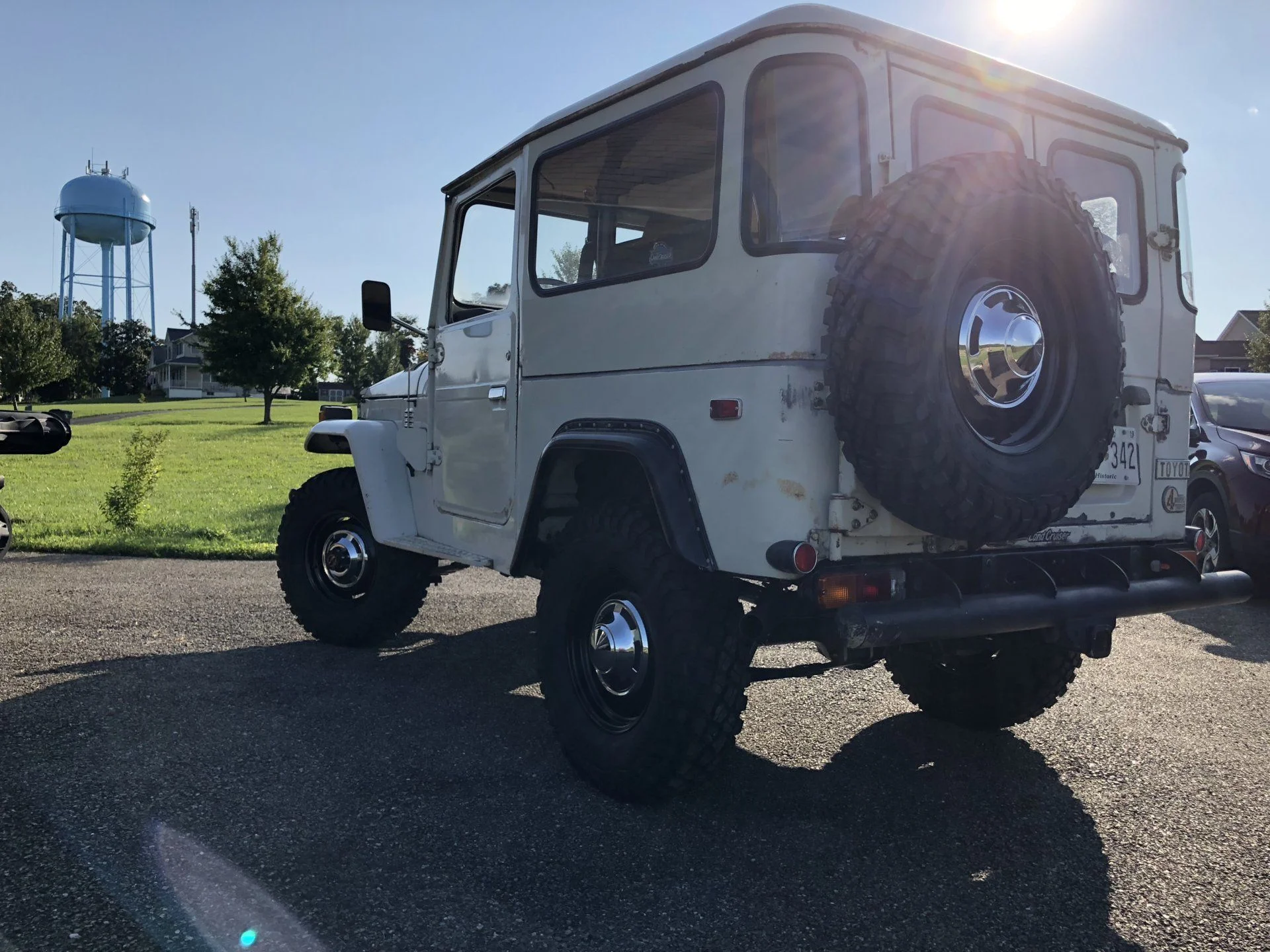

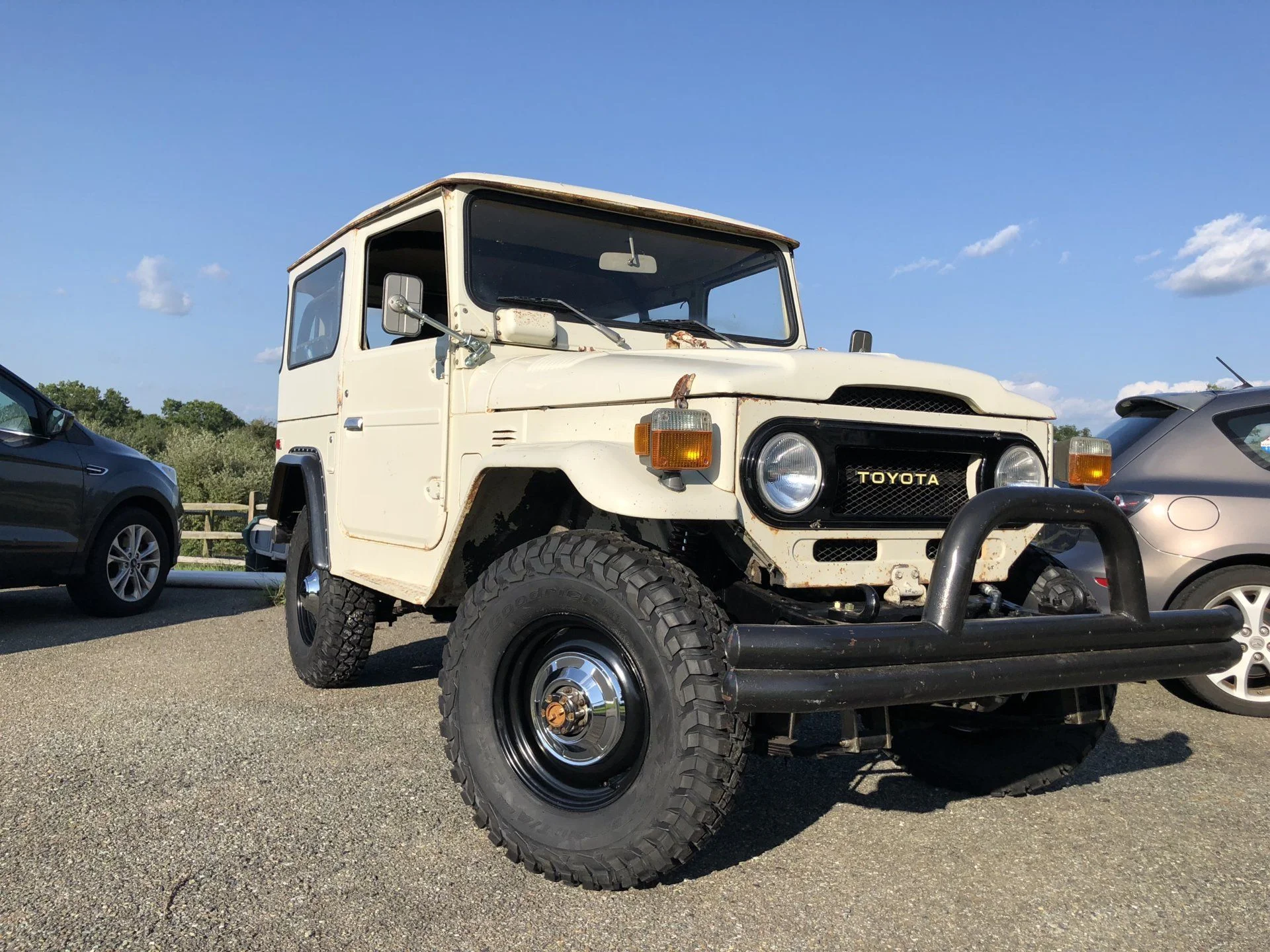

Ok all, I'm sure this has been asked before but haven't found much by searching...
I'm getting to the point in my build where I can actually think about joining you guys for a wheeling excursion one of these months. I've still got a bit of work to do yet but the fact that my truck survived the drive to Lancaster this winter was encouraging. A couple of things working against me:
  1. I have NEVER wheeled before - hoping I might be able to bum a ride as a passenger for a trip or two before I attempt anything.
  2. Rausch Creek is 110 miles from my house and I don't have a way to tow my 40. Yes, this means I intend to drive a 44 year old FJ40 100 miles, wheel it, and then hopefully drive it home... Which means I'll likely stick to the "easy" stuff so there's less risk of breaking my ride home.
My first question - am I asking for trouble? I'm honestly not sure if I'm insane for contemplating this...
Second question - Assuming I'm not crazy for considering it - what, realistically, do I need to bring in terms of recovery gear, tools, etc. and what modifications are a "must" for a 40 in its natural habitat?
Some basics:
  • My FJ40 is a 1975 with a 350 conversion; carbureted, running a Quadrajet. Stock Toyota 4-speed and T-case w/ T-case savers
  • There's an Aussie (lunchbox) locker in the rear
  • Stock Springs, mildly oversized shackles (maybe 1" lift) and (awful) load leveler shocks, slightly trimmed/flared rear quarters
  • Saginaw Steering
  • BFG KM3's (brand new) with full-size spare
  • Knuckles/Fine-Spline birfields and steering components from a FJ62
  • 4-wheel disk brakes
  • Tube Bumpers front and rear
Most everything has been gone through at this point - new brake/fuel lines, solid mechanical baselining, fresh fluids. Rebuilt T-case, new clutch, new engine has ~1000mi on it. Only thing questionable is a bit of whine/"chugging" in neutral from the transmission input bearing - but I have no issues shifting.
Tools and Gear:
  • Basic assortment of metric wrenches
  • High lift jack (unsecured) with a winch kit
Some concerns:
  • No winch; no D-rings
  • No skid plate
  • Not much lift
  • No radio
  • No tow chains/recovery straps
  • No tow-rig/trailer
  • 11mpg highway :hillbilly:
This post is getting long - so I'll end it here and wait for some opinions/constructive criticisms. If the reasonable answer is seriously "do not attempt," I want to know it! If it's feasible - I want to make sure I'm prepared, at the very least, to tackle some green trails. I'm not made of money but I have saved a few pennies I could throw at this - so I'm hoping to get your input on what type of gear/modifications/etc. are critical out there. Essentially, the "wheeling starter kit," from those of you who have been there.
Most of you know the truck at this point - but here's the junk in question:

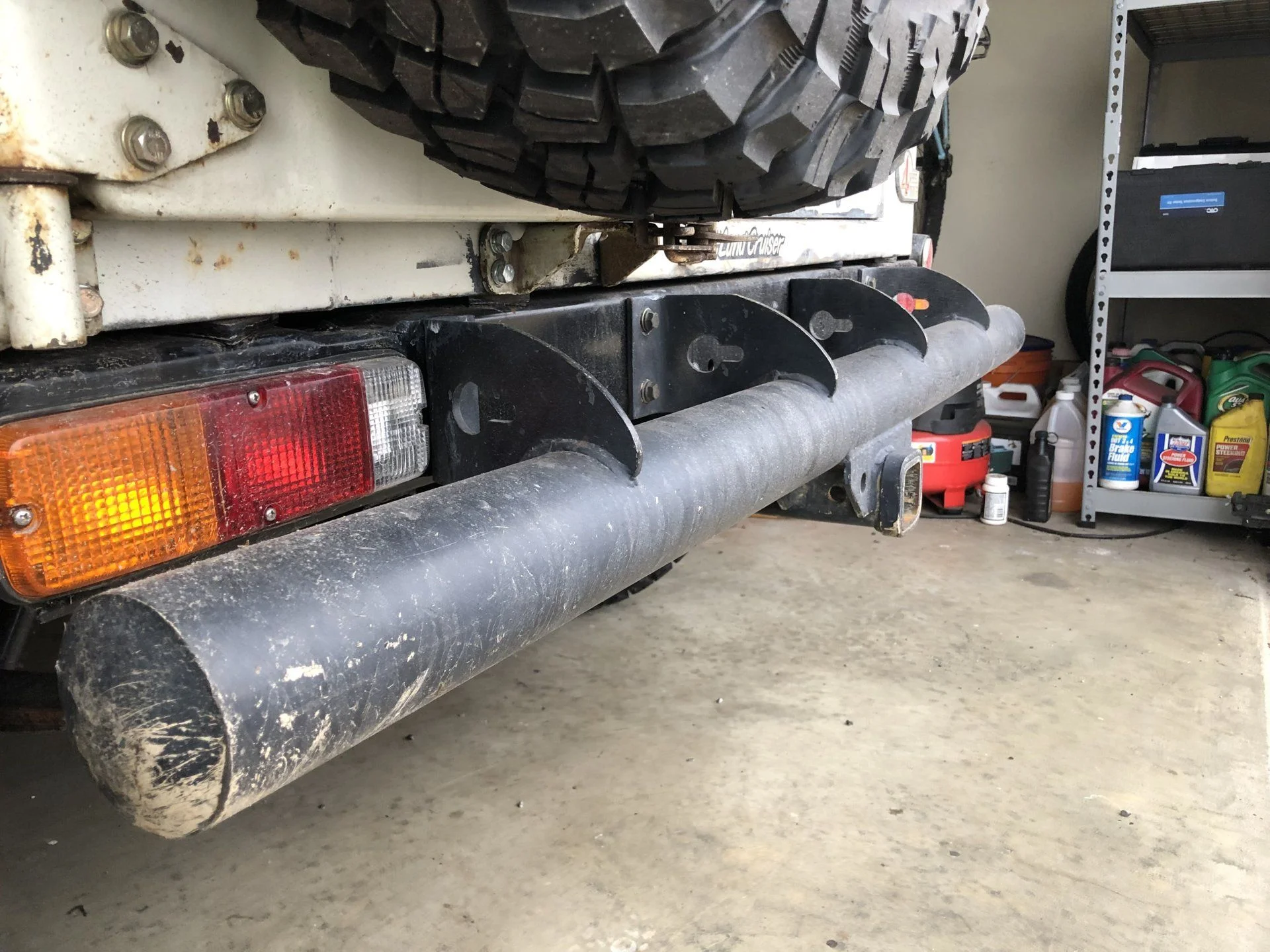

Any advice there? Technically, the holes in the bracing on my rear bumper are supposed to serve as recovery points - but that's putting quite a lot of faith in the bolts holding that bumper to the cross member. In front - I'm guessing the stock hooks probably don't count - but beyond a completely different bumper (not out of the question) are there alternatives?
The stock hooks on the front frame rails work ok. I can't comment on your rear bumper without seeing it. There should be holes on the rear of your frame rails that will accommodate hooks.

Here is the bumper - though I hesitate to use it. I know at least one of the bolts holding it on is stripped - which makes me question the rest of the old welded nuts. Frame holes seem like a good alternative.

Yeah - trying to avoid pulling by the bumper - I know I have at least one stripped bolt holding it to the rear cross member so if there are frame recovery points - those are more ideal until I get some new welded nuts on the bumper mounts.

In my opinion your 40 is easily capable of Blue trails in its current form. I didnt see a tire size though. I'm assuming at least 31's
The biggest limitation I can see is you. Thats not a insult either. We were all virgins once. Most people have no idea what it is we do. They think we just go and drive on fire roads. Or the unpaved roads people take to get to hunting cabins. The truth is that this is low speed technical presision driving. Some times 1" makes the difference. As we take our senic drive through the woods we are ascessing and adjusting the ever changing situation. Do I climb that rock, do I go around it, do i try and stradle it. You will be picking the line to try and negotiate the obsticle in front of you. Hopefully you suciede, somtimes you wont. Stay calm at all times. Panic will help no one. Wear you seat belt at all times. You may find youself upside down unexpectedly. I did as a passanger once. And if you do this long enough everyone will take the ride of shame. On the back of a flat bed or a trailer of some type. Not a fun bill to pay but like they say you have to pay to play. Ive done it 3 times. I think @Pacer did it 3 times in a year! AAA is my plan B for getting home. Their Plus membership provides 3 100 mile tows per year, over that and you start to pay. They offer a premeire membership that has the 3 100 mile tows and 1 200 mile tow. The 200 mile one you must wait 10 days to use after activating your membership.
Id use that bumper as a tow point. Looks stout to me.

Your truck, as it sits, will eat any green trail at Rausch, and have a few blue trails for desert.
You'll be shocked at what it can do.

It is - and I thought about that but wasn't sure you could literally wrap a strap around a bumper and pull...On the rear bumper there's at least one (maybe 2) stripped bolt(s) anchoring it to the crossmember - so my concern isn't the bumper failing but the nuts.
