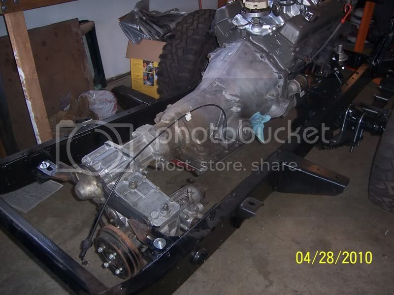

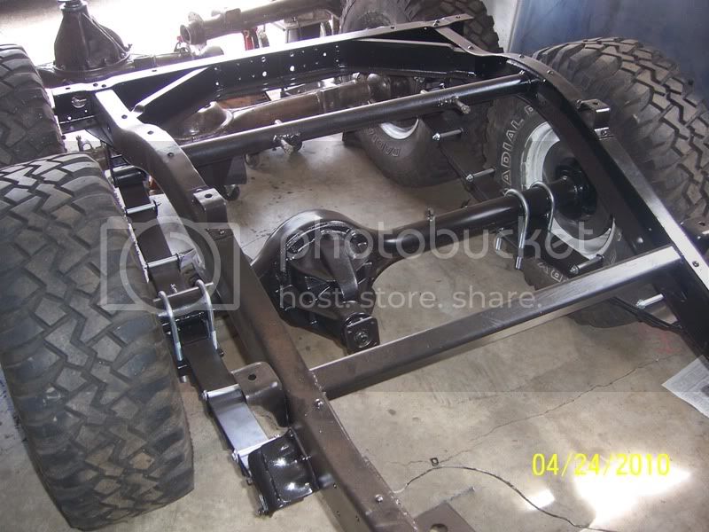

I installed the drive train this morning. I'll take some pics this afternoon when I get home. I left out the torque converter until after I break in the engine so I don't have to finish all the tranny plumbing before hand.
OK, so here are the pics I promised.
Rear axle in place. Note the new rotors, but no calipers yet. Those go on this weekend.
4 axles. The one with wheels is going on the front. The other two I bought with the intention of using the housings for a spring over mod, but that is delayed. I need the cash more so I am cleaning them up and selling them.
Front axle installed. I still have to swap out the knuckles for disc brake ones that are on the work bench behind the frame. I needed to get the frame rolling so I could get the engine installed and make more room in the garage. Space was getting too tight to work.

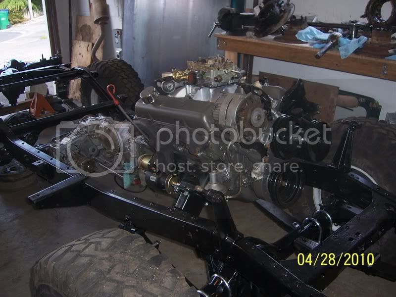

And the engine installed. Yay!
From the back looking forward. I am pondering welding the washers in place to keep the t-case from moving side-to-side. Any thoughts on that?

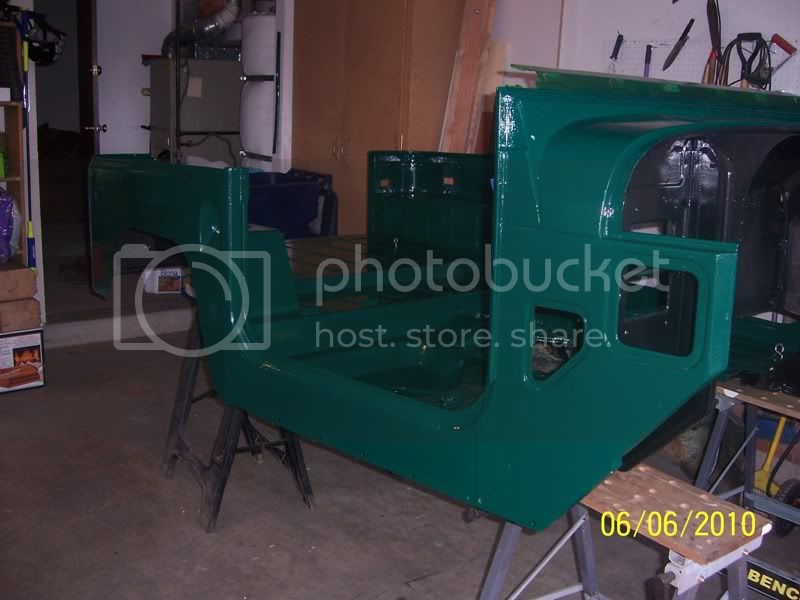

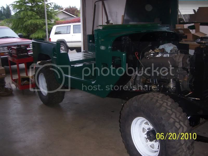

So this weekend I painted the tub. I have been planning that for a long time and decided to use smooth Durabak inside and out. It is not a real smooth finish, but it should be great on the trails. It took three coats with a super smooth roller to get complete coverage. The rest of the body pieces will have to wait until the tub is back on so I have room to work on them.
I am not too thrilled with the shade of green, though. It started out as British Racing Green. It is quite a few shades lighter now. My wife says I'll never be spotted if I go off trail into the trees. I just told her they will look for the flames and smoke.:D

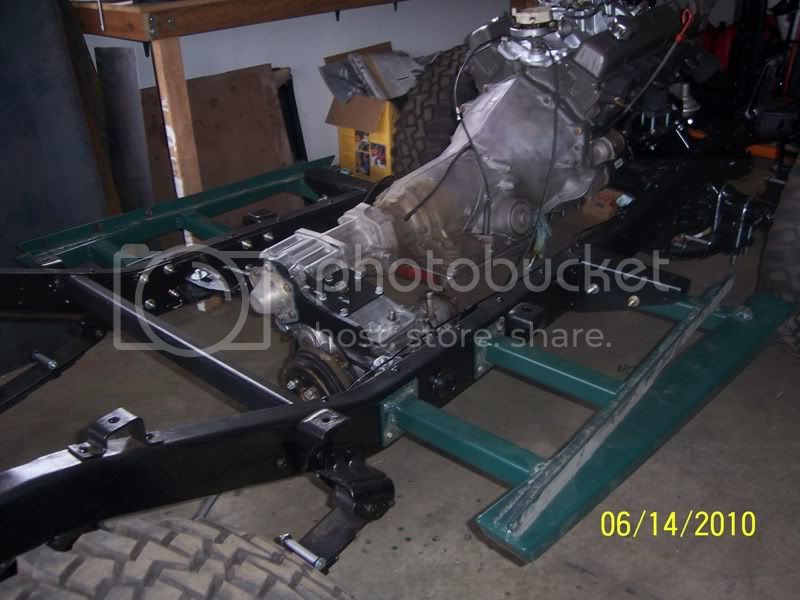

I hung the sliders

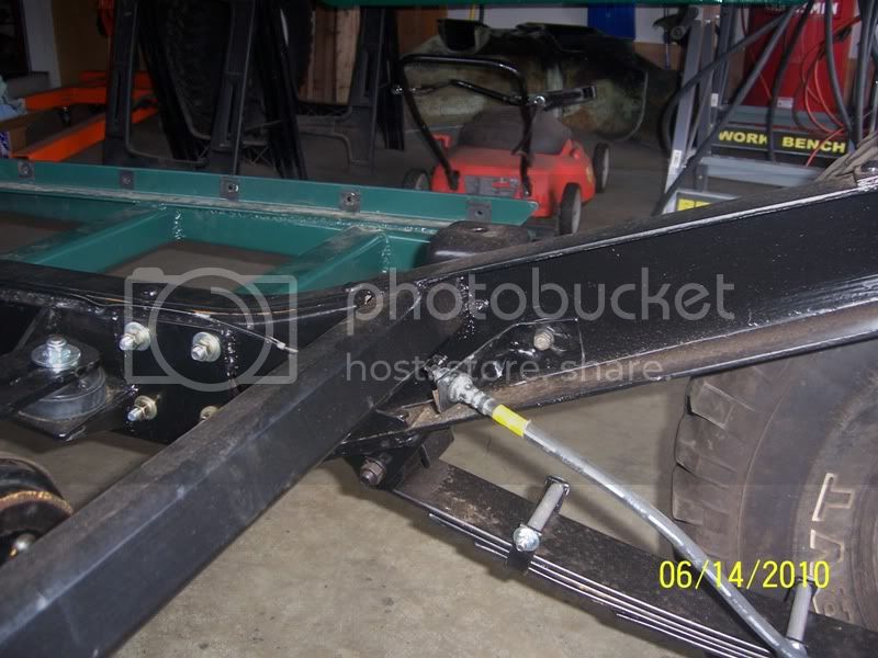

I ran pressure and return fuel lines and the factory brake hard line, modded to fit the changes I made to the frame.
I am having trouble finding the correct length rear hose without getting one custom made. The FAQ's and such list a part number for a 22" hose, but I think I need 26" to be safe.

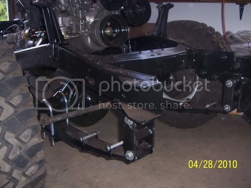

I also flipped the front springs and redrilled the second leaf. Got those back in.

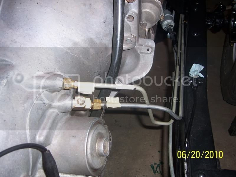

The last thing I wanted to do before the body went on is get the trans cooler lines installed. I bought some tubes and a T for the temp sensor and bent and installed them. I suspect the temp sensor won't fit under the tunnel cover, but I'll have to test that later.
Then the tub.
The more I look at the paint color the more I hate it. I'm going to sand and then rattle can it. At least it is hard paint :)
I think the color's cool, especially with the white wheels, but it's your truck, and you'll never have a better opportunity to get it right. Great build.

That looks pretty amazing for a DIY roll-on paint job!!
Any tips on doing this kind of paint work on the fiberglass dome? I've heard that a different paint or prep needs to be done when painting fiberglass? Needs "flex" in the paint? Is that b.s.?
I have a fiberglass dome that has remained unfinished and exposed to the weather for almost 2 years now. Recently got quoted $850 for primer, paint, and clearcoat, white on top, Zolatone on the undersurface (instead of a headliner). But, I'm thinking of trying something like this myself. I want it nice and durable, but probably doesn't need to be glass perfect finish. Any tips?
