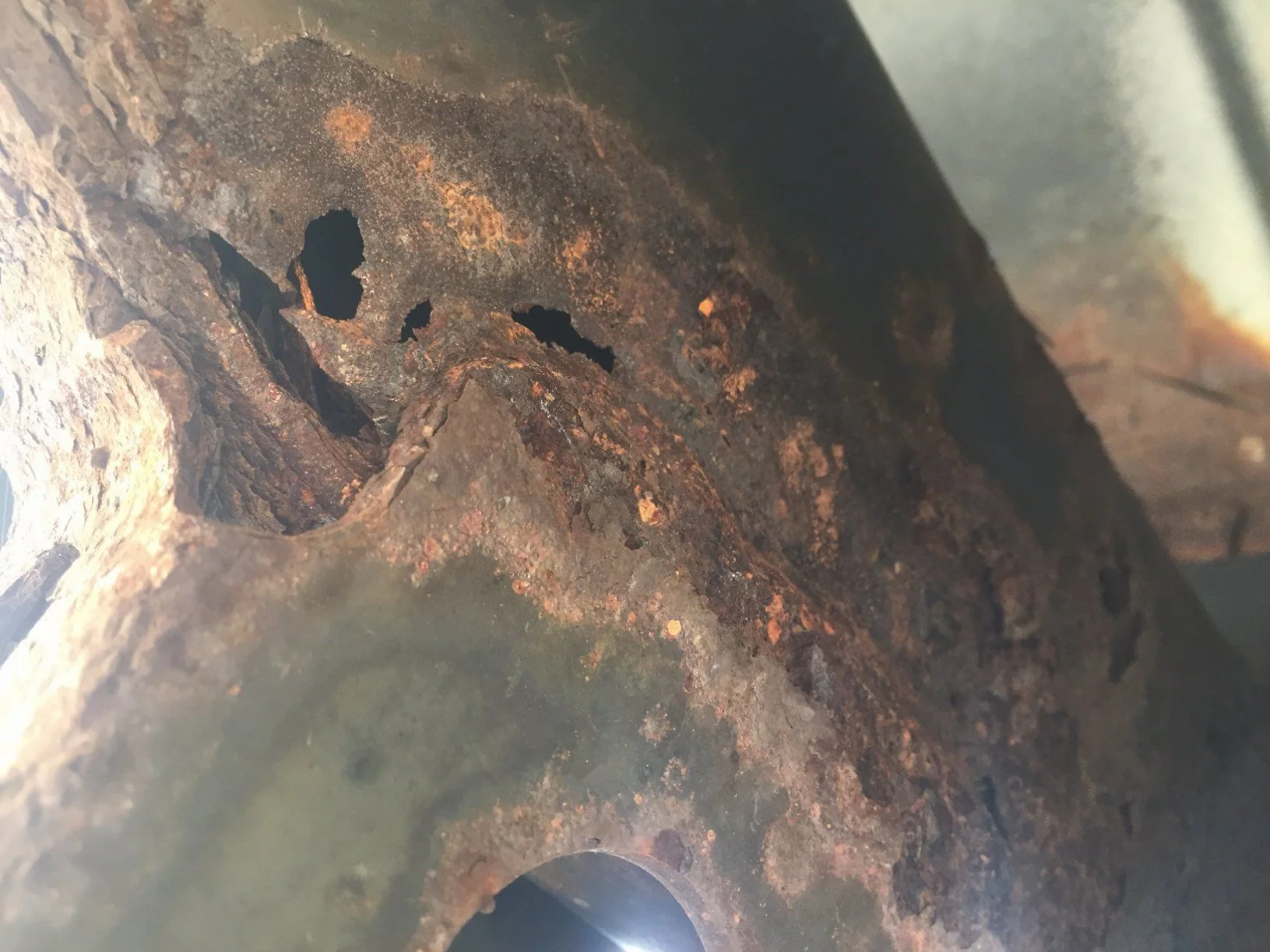

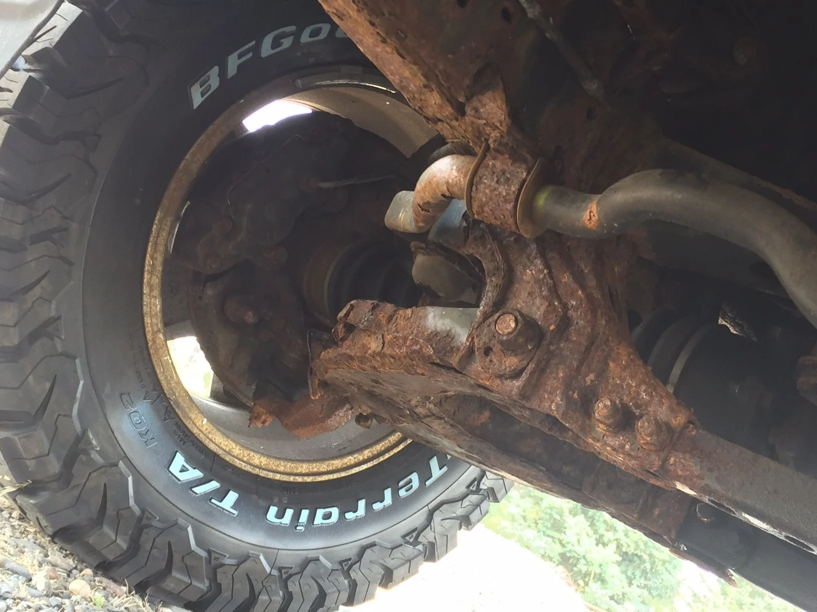

Hello,
I just picked up a 1998 4x4 auto sr5 T100 and need some help
The good,
Immaculate interior, paint is in great shape, a/c blows cold, stereo is in great shape, all gauges work. The engine only has 105,xxx
on it. Mechanically it is near perfect. It was a one owner truck.
The bad,
I had a pre-sale inspection done. I bought from a guy in florida. I am located in Bozeman Mt. The local toyota dealer did the pre-sale inspection, I also spoke his mechanic. They both told me there was surface rust on the vehicle but the frame was in good shape, so had it shipped out to MT.
I brought it to my local mechanic last week when it arrived. He immediately called me and told me he would not even hoist it on his lift for fear of the frame would break in half. I then took it to the local toyota dealer, asked them for a basic inspection and they told me the same thing, both said not to drive the vehicle.
I am trying to figure out my options. Does anyone have any experience with replacing the frame? I am ok mechanically but not good enough to replace the frame.I was wondering about the basic cost of that. Should i just junk it? Is there some sort of law where the seller would have to take it back and give me my money back?
Thanks for the help

Pics, we need pics! Truck must have been used for launching a boat in salt water, been standing in flooded sea water, or originally from elsewhere. Otherwise, how could a Florida truck be in such bad shape?
here ya go,
If all your information of the pre purchase inspection is documented, it's lawsuit time. You got the inspection done to avoid such a mistake. Now you have a low mileage dangerous vehicle. Yes you could fix it with a new frame, but I think that dealer in Florida should fix it or give monetarily for your hassle you entrusted them monetarily to keep you out of but they failed to keep up their end.
Wow, thats just unacceptable that the dealership in Florida did't tell you that upfront in the presale inspection I would be ripping them one for that. Wish you the best. Worst case a frame is not that bad at all the worst part will be the brake lines and with that rust your better off with new ones anyway. Good Luck :cheers:
