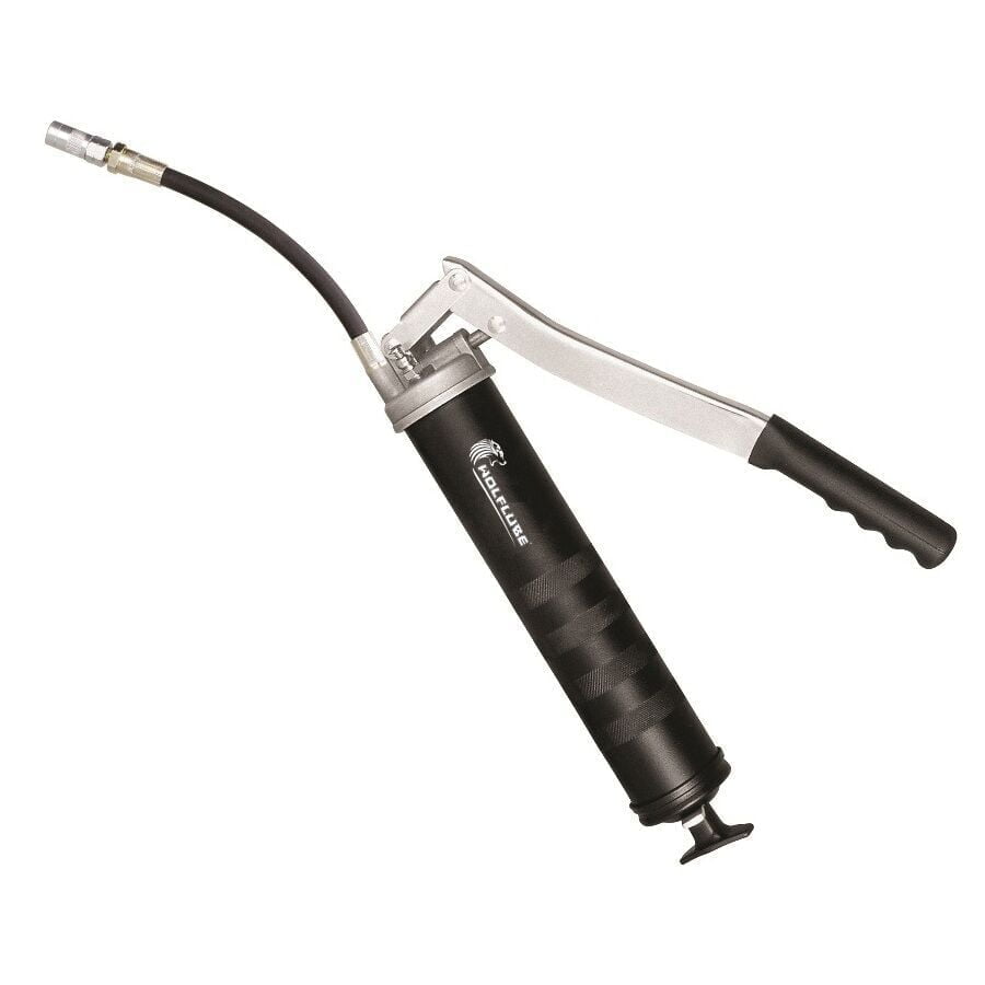

Traditional design (I use a long flexible hose extension):
Newer design (watch the video in the link):
Not sure I like the above design with just that orange cap, doesn't seem like a very positive seal?? Just posted it for reference. My traditional lever type grease gun was Made in the USA 30 years ago.
