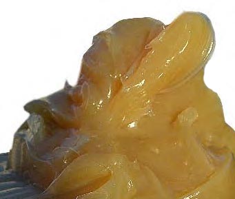

A "lithium" grease refers to the Lithium base complex grease which chemically holds onto or absorbs the lubricating oil which is the bulk of the grease. The lithium complex sorta holds it all together. Along with the lubricating oil may be additives (anti-corrosion, anti-oxidation) and other solid lubricants (like Molydenum Disulfide or Graphite for example).
So a "Moly" fortified grease means Molybdenum Disulfide has been added to the grease to provide extra protection, but that could
be in a Lithium, Aluminum, or Calcium complex. Key is to not mix different bases or complexes.
To answer the question above: some people have run Molybdenum Disulfide ("Moly") fortified Lithium base grease in their U-joints without issues. IIRC the rule is it's OK to use up to 5% Moly in the grease for wheel bearings. Valvoline Palladium with 3% Moly is approved for wheel bearings for example.
This talks about Lithium grease:
