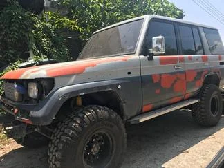

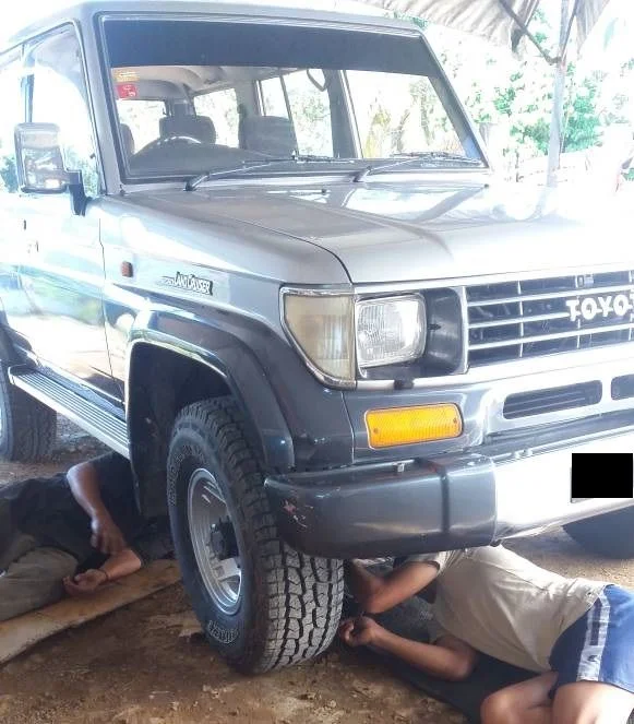

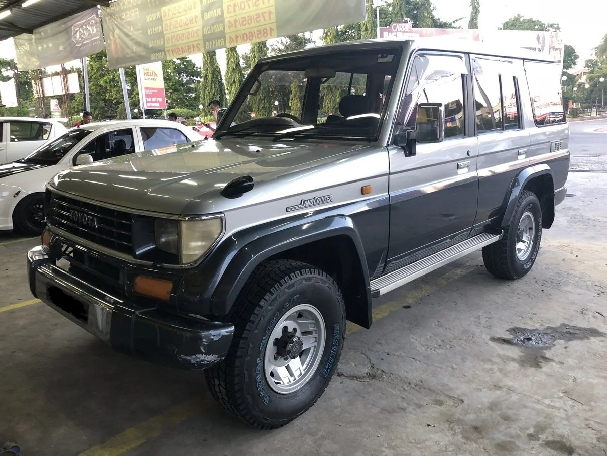

This is how she looked like when I picked her back in June this year. Stock as a rock!
Nothing special, stock 2-tone paint job and interiors with some body work to be done. Bits of dents and bent on the LHS bumper side. She had clocked 320K km on the odometer. 31" AT tyres with some old suspension setup. In fact, she has not been up and running for few months.

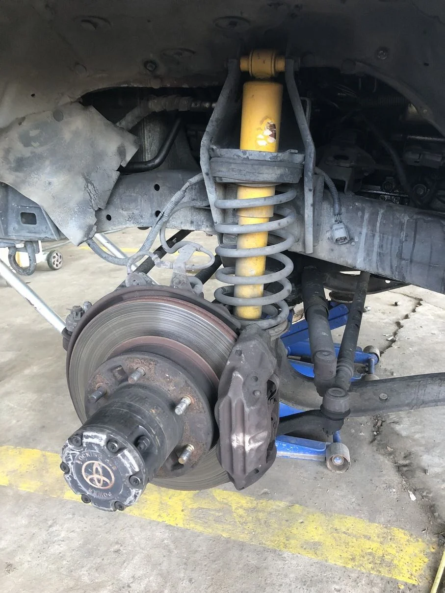

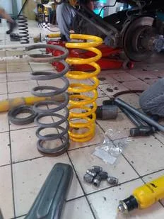

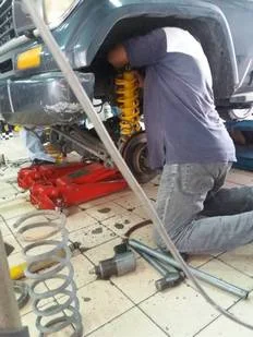

I reckon some good OME Nitrocharger Sports combined with yellow coils would tackle those bumps good. This gives me a 2" lift at the end.

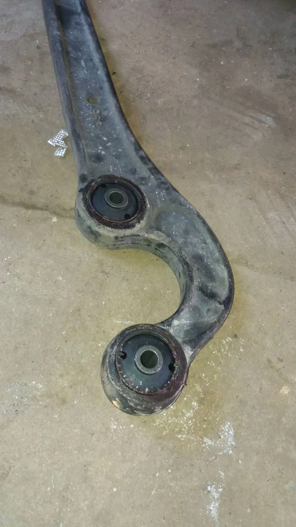

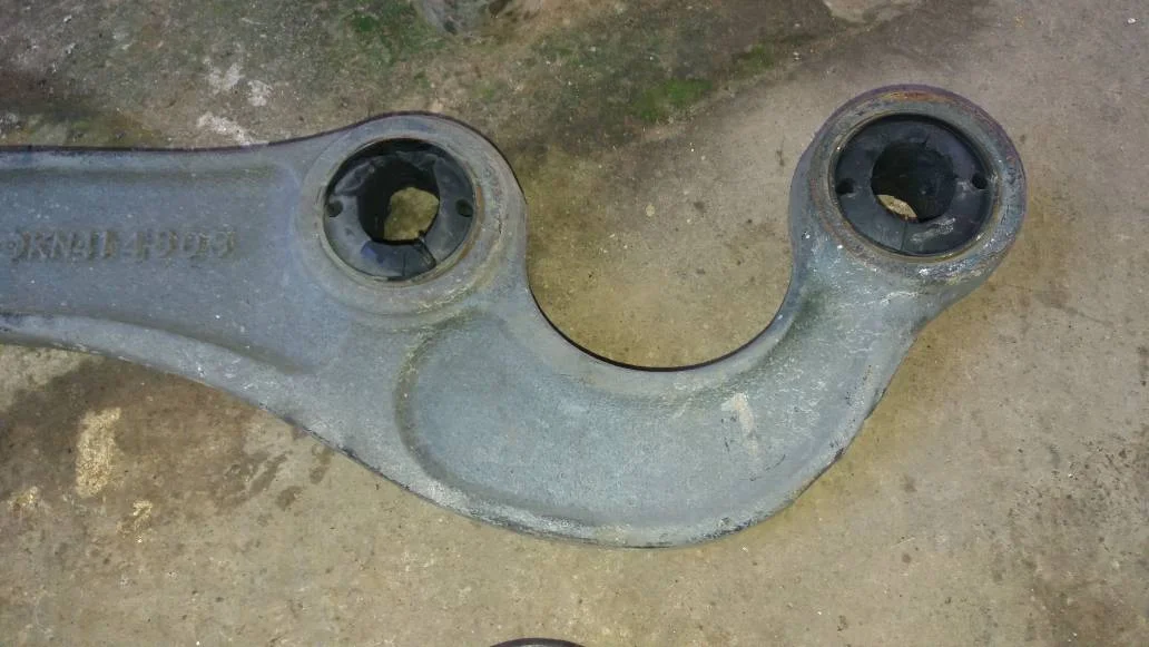

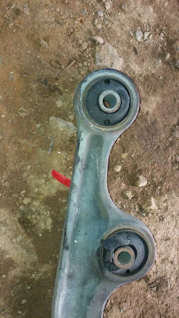

I made the Same mistake, The little holes in the bushings are supposed to be in line like the one you took out.
PS: I left mine and it has not been a problem. Also I have never seen bushing that Badly worn out
What are those little holes for? I never seen anything like this bad too lol

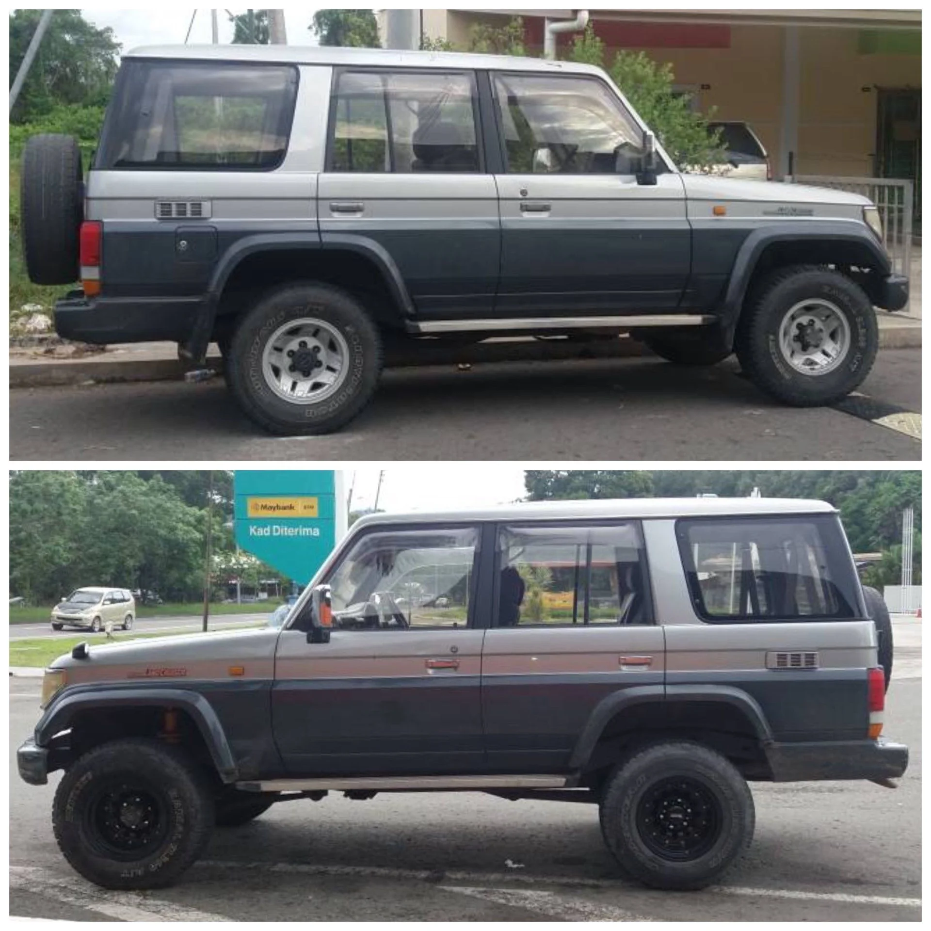

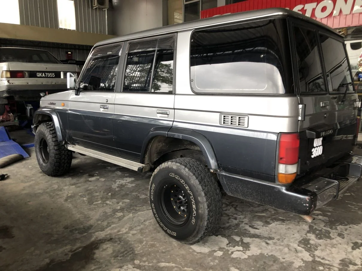

Changed the rims too to get wider traction to suit the height.
Ordered the tyres. I went for Maxxis Bighorns 33s on 15" 10JJ wheels, I think this would compliment the engine power well with the auto tranny.

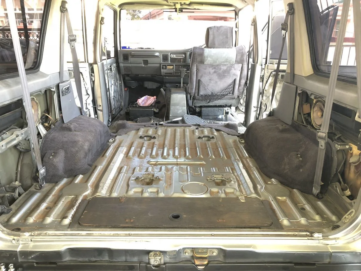

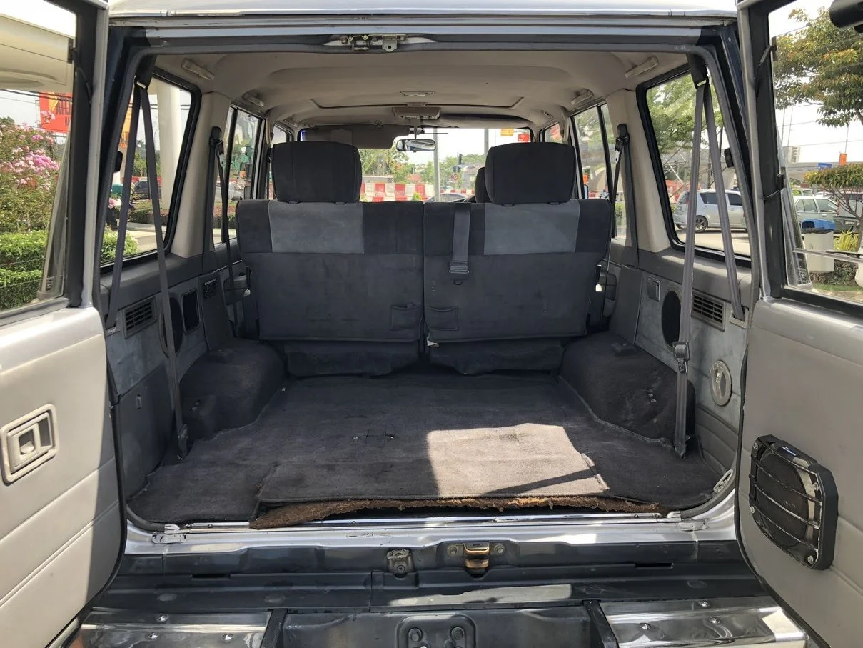

Finally got to the interiors. Got the seats and door trims re-wrapped and done the body work too, with my favorite colour of course. GRAY!

From what I understand if the holes are aligned correctly they Felix better.

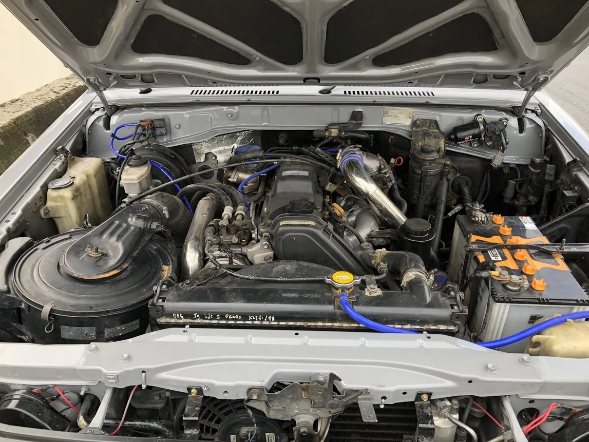

Thanks man and pretty good looking flex there too! What you got under the hood?

It's got the 1FZ-FE Petrol motor, They never brought any Diesel motors to North America. To import one it has to be at least 25 years old so very few 70x in the U.S.
