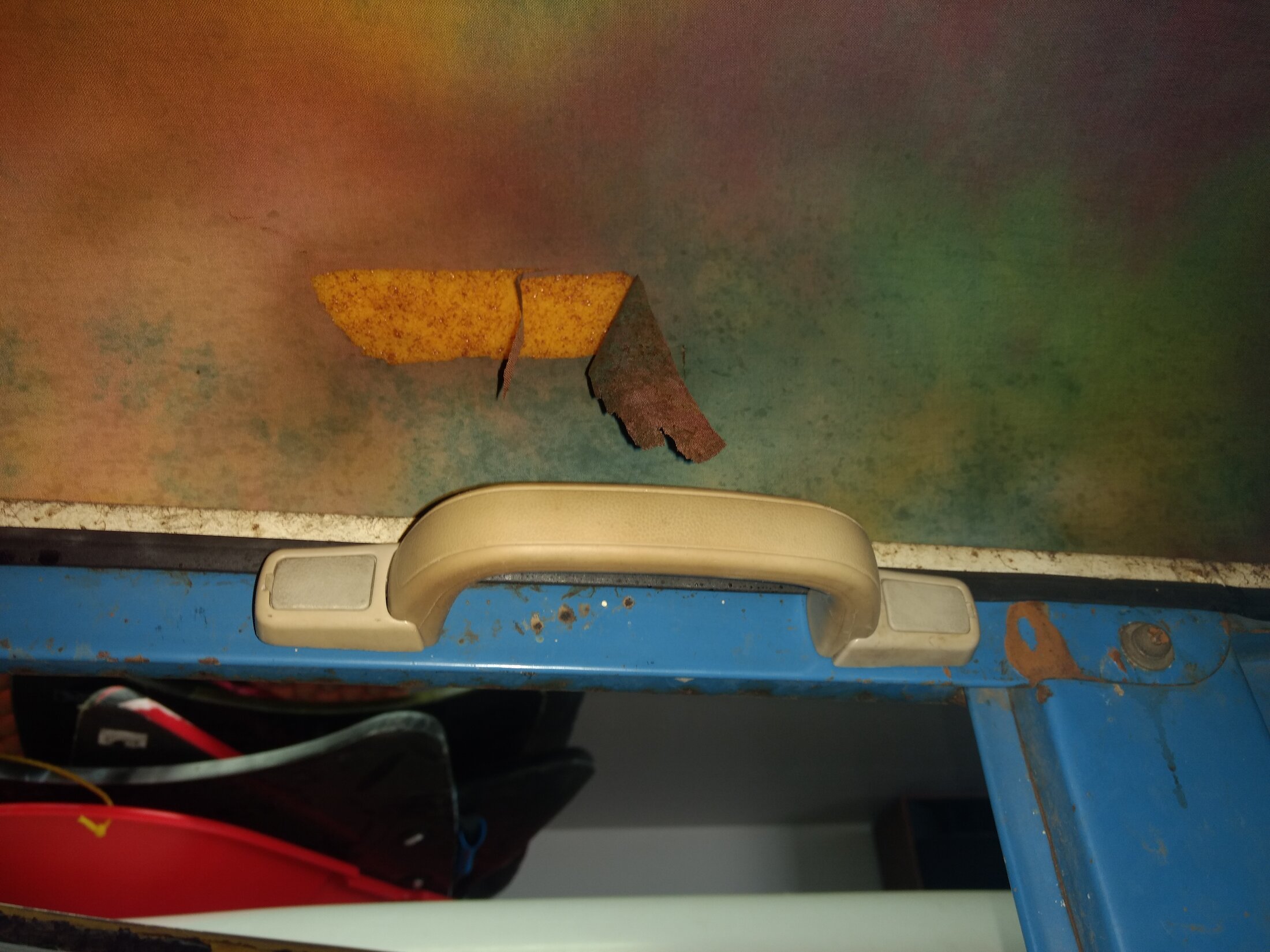

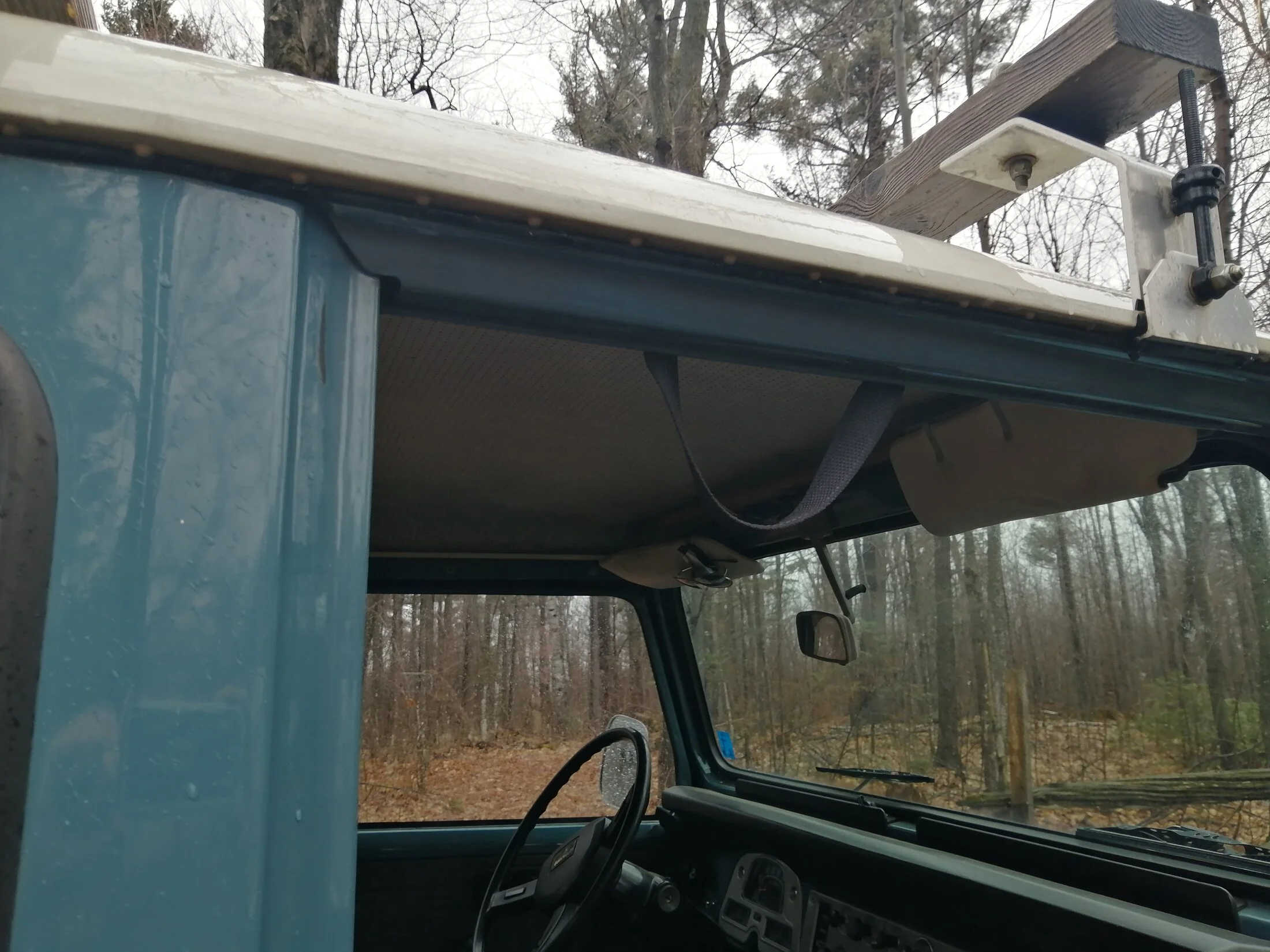

Toyota added grab on the driver's side above door on late 40 series.
I also like these off the FJ62 and 80 series for side of the windshield frame.
These are not going for getting in but getting out. Sliding out wears the cover on the side and breaks down the foam. Lifting while gets out slow that down.

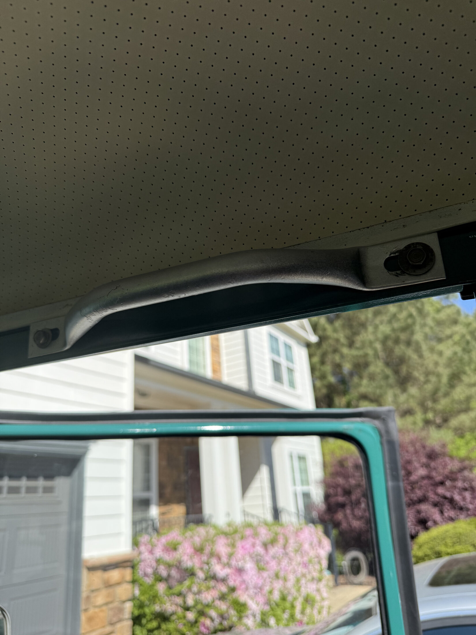

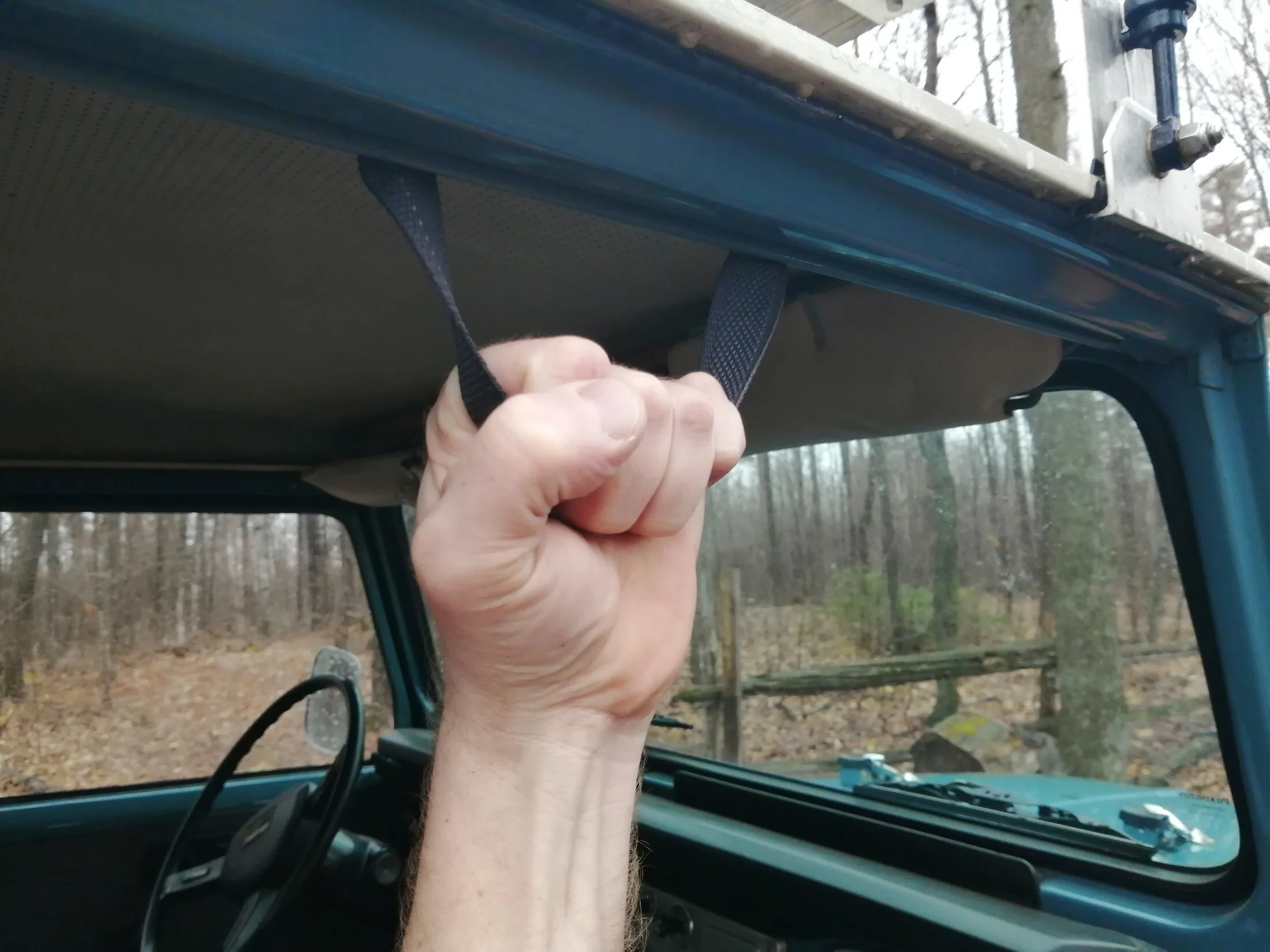

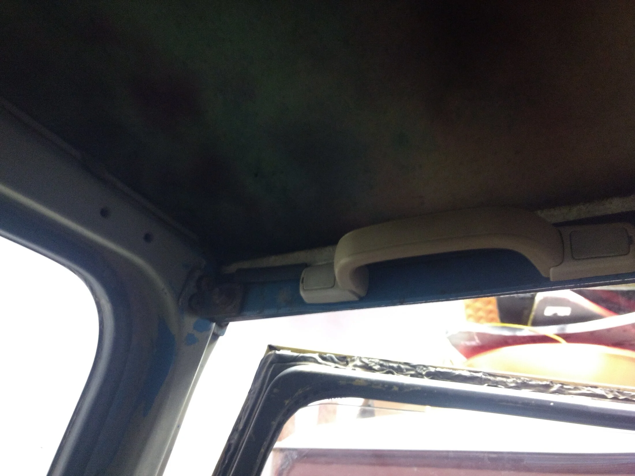

Are these standard on our trucks? They have no problem with me hanging off of them..

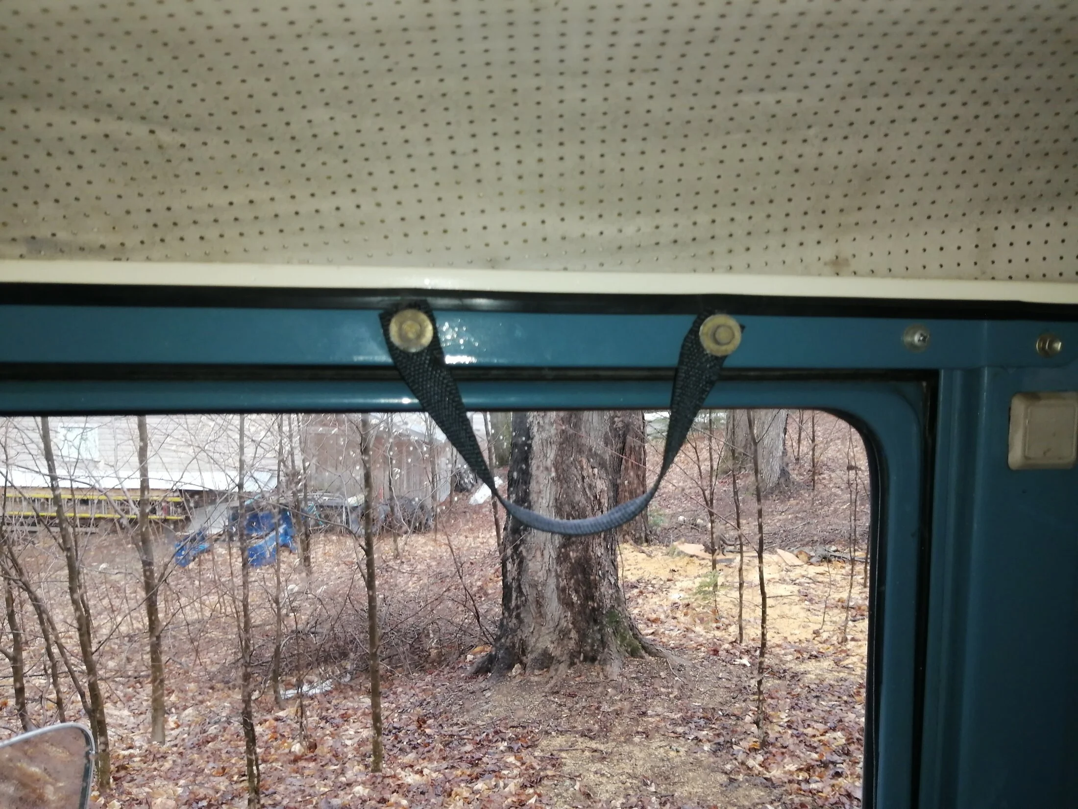

I have a set of those. I asked the forum many years ago if anyone else had them trying to figure out a manufacturer. No one at the time recognized them.
I have had no problem with hanging off them either. Mine originally came off a 79. One on each side. I now have them on the passenger side of two of my Cruisers to help the wife out.

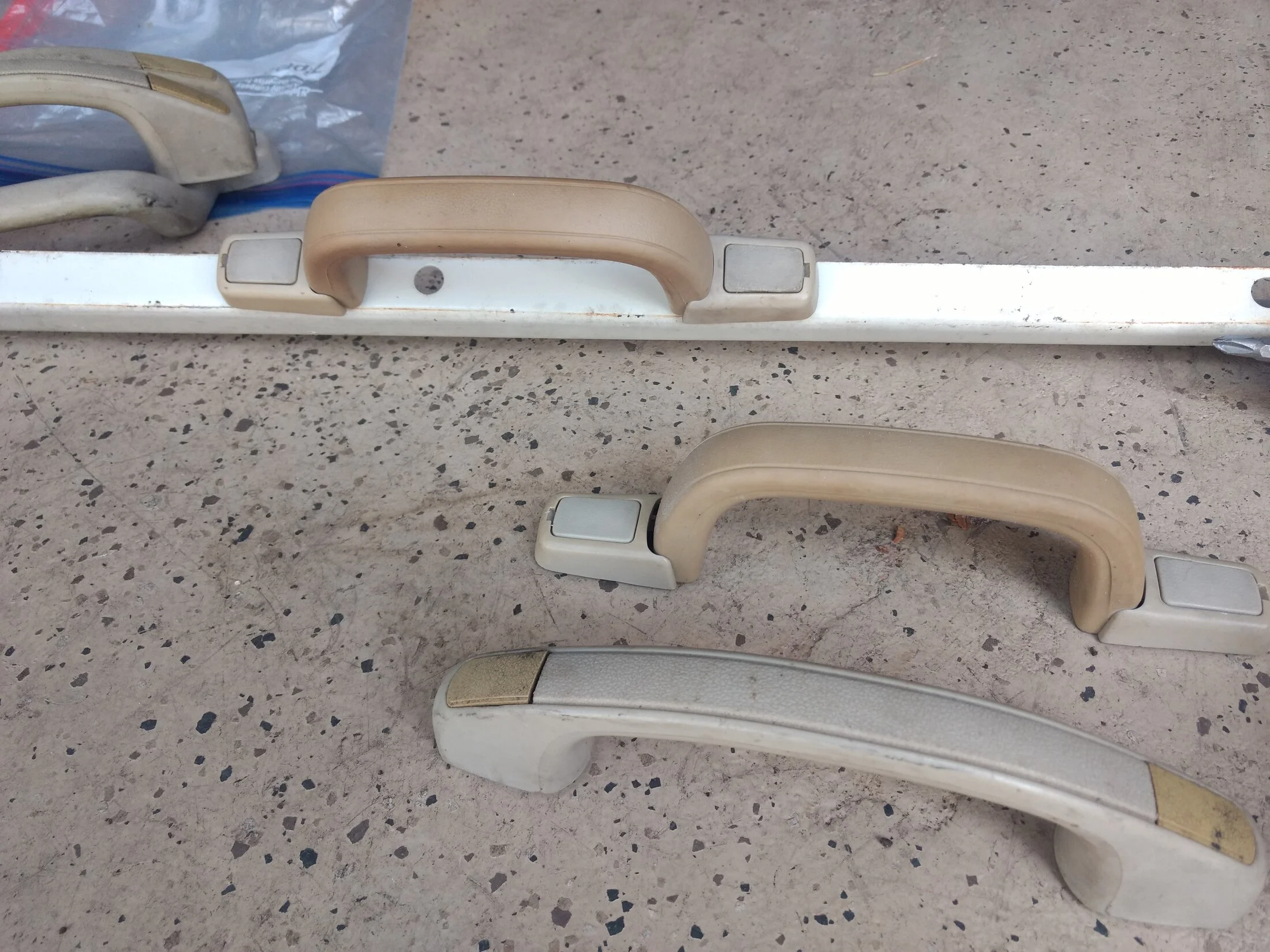

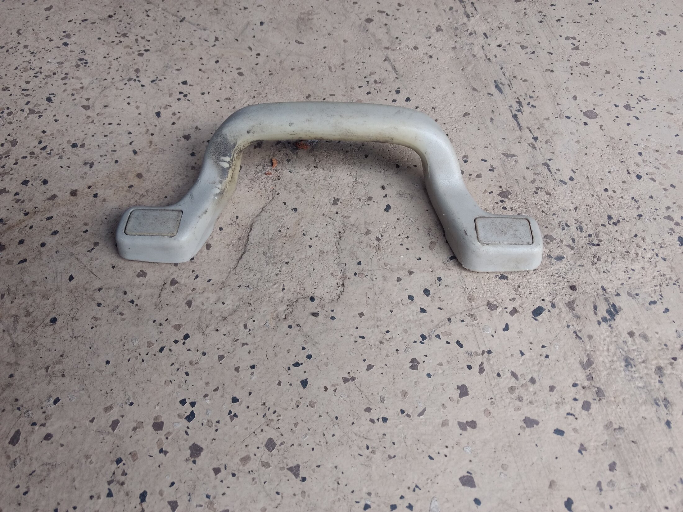

These are OEM handles for the 40 series except for the bottom handle in the second picture which is from a 60 series.
These handles except for the two black one are from early 70 series. The black ones are door pulls for late 40 series and early 70 series.
Spacing for screws match 40 series 70 series for each type. Over door and door pull spacings are different.

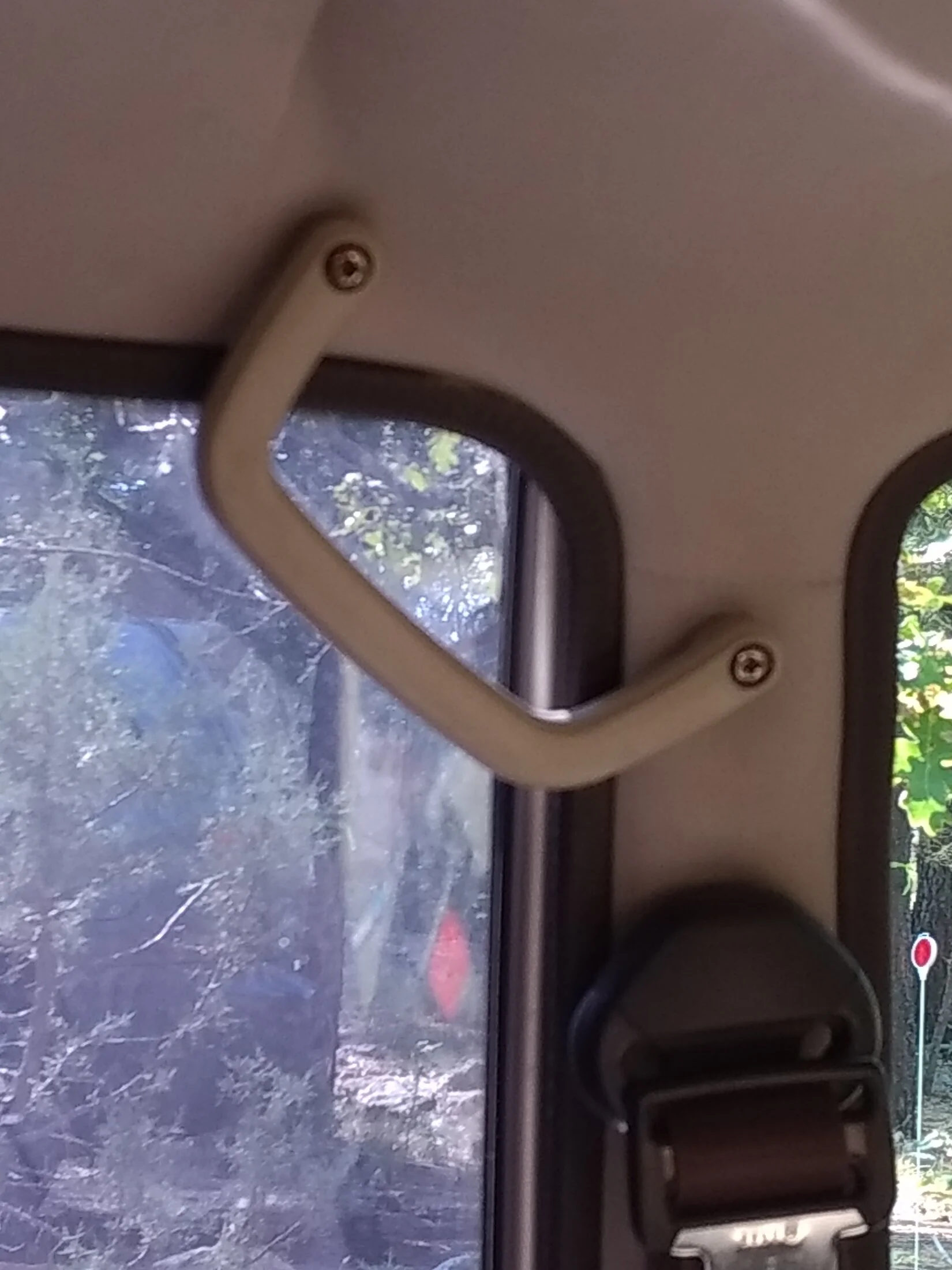

The factory grab handles started 10/81. They are too short to fit standard three screws. The extra fixes nut is between the back two screws. Towards the front would have made more sense. Personally like the grab bar on the side of the windshield frame. My FJ62 has one on the driver's side. I added one to the passenger's side which more convenient than the over the door grab handle or the bar above the glovebox for getting in. I also installed these grab bars between the B pillar and door header for rear passengers.
The threaded holes were already there. Can't understand why we only got the soft handle above the door instead of these. Same with Toyota dropping the A pillar grab bar for the driver on 5th generation 4Runner.

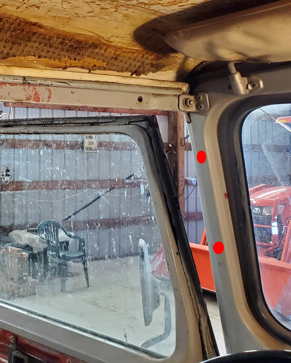

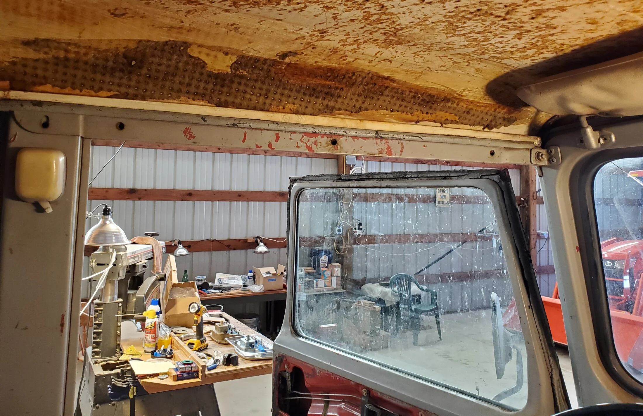

I'm planning to put a couple of M8 rivnuts in the A-pillar (red dots in the picture) and get a handle from somewhere. I mainly run with a bikini top and tube doors, so it won't be in the way of the upper door frame...I'll probably do the same to the section above the door when I have the hard top on.
My 40 is a resto-mod, so I don't really mind if it's not an original handle. I just need something to help my old-ass and my wife's short-ass get in with the 2.5" lift and 33's! LOL
I just grab the windshield frame in that location when I hop in. Your wife would probably appreciate the handle though
I do the same thing....and yeah, my wife is the one who asked for the handle. My OCD won't let me do just one on the passenger side though! LOL
