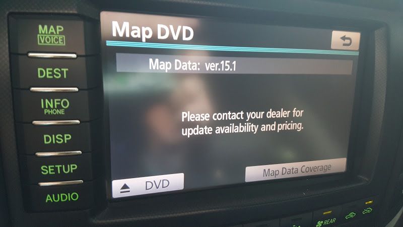

I recently updated my 2011 Navigation DVD and wanted to share my experience. I purchased the DVD from toyotapart dot com for about $169 and the transaction was easy. Once it arrived, however, I ran into issues with locating the DVD player in my 2011 LC.
Many other posters here commented on the DVD player being beneath the passenger seat or behind the fold-down display of the head unit where the maps are displayed. Neither was the case for me - turns out it was in my glovebox. Next step of the process had me struggling to find the eject button - there was nothing physically on the player inside the glovebox (I even partially disassembled based on similar instructions for replacing in-cabin air filter).
Also, for the record, I have the rear-seat entertainment unit with the 6 disc DVD changer, but I knew that wasn't the location as there were no pre-existing DVD's for GPS located there.
I searched over and over within the 'Maps' & 'Setup' menu of the head unit thinking it had to be there.
Finally, after several false starts, I called the local Toyota dealership and spoke to a service technician (gratis) who walked me through the menu path to eject current disc. It was located under the 'Info(phone)' menu, not the 'Map' or 'Setup' as I incorrectly assumed before.
See attached photo for reference.
Once the old disc was ejected, new disc went in easily enough - update itself took only a couple of minutes once I knew where the eject button was located!
Good luck.
