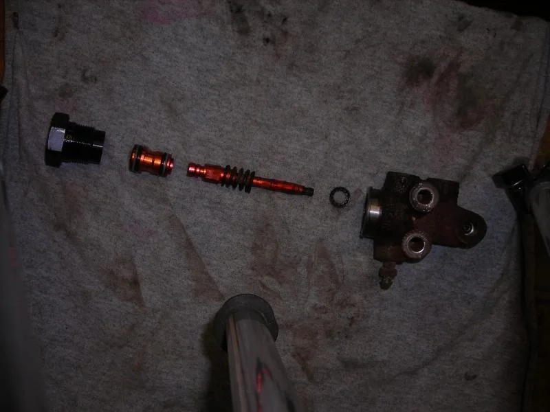

Anyway on the the other items. I installed new front rotors, cleaned and repacked the front wheel bearings and replaced the inner wheel seals, replaced the rear inner wheel seal as it was leaking, rebuilt all the calipers with new Toyota parts, installed Hawk LTS 100series front pads and Wagner stock replacement pads on the rear. I also cleaned the rear parking brake shoes and flushed the fluid with fresh clean fluid. I also pulled the rear LSPV and disassembled it to clean and make sure it was properly working. I have attached some pics to show the insides of this valve in case anyone else chooses to do something similar. I was pretty corroded inside. I cleaned all the rust out and wiped all the seals down, then reassembled it with some moly grease. Once I reinstalled it, I adjusted it for the ride height changes due to the lift.
The truck now stops much better, actually stops pretty nice for something so big. I am still debating putting a bigger front rotor on, but so far 13 and 14 in rotors are looking pretty pricey. I figure a front upgrade to 13 or 14in rotors with a caliper spacer should improve braking nicely for the trucks equipped with bigger tires. Plus it will fit inside the stock 16in wheels.

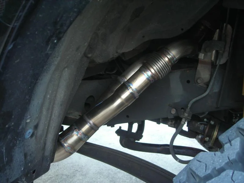

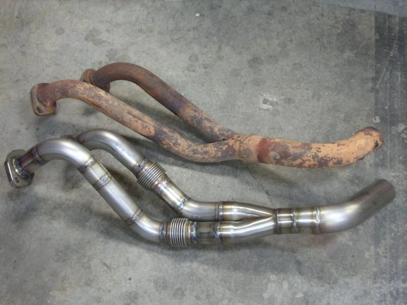

Back from the dead. Been working on my truck lately. I built a new down pipe to replace the cracked stock piece.
I built this to replace the cracked stock piece. I used 1.875in diameter 304 stainless tubing. I used a very nice merge collector and some stainless bellows to compensate for expansion and movement in the exhaust system. The stock system used no form of flex joint. I also used a nice ball flange to connect the rest of the system to the cat.
I tossed the stock cats (2) and used a modified S2000 three way cat. It is much more efficient than the stock cats and it is a larger diameter to allow for better flow. I expanded the tubing coming off the collector to 2.5in going into the cat and 3.0in coming out.
At some point in the future the stock exhaust is going away and I will build a nice stainless 3in system all the way out the back. Want to get a little better sound as well as some power. I machined all the flanges from 1/2in thick 304 stainless plate and designed all flanges to use the stock sealing arrangement. I also made some new oxygen sensor flanges out of stainless to replace the ones on the stock system. This system puts the O2 sensor in a well protected location behind the body mount, no worries about knocking this one off or showering it in road grime. This system should out last the the truck.

That's some really nice work. Would love to hear how it sounds when its done.. Over the frame or under?
I haven't decided yet. I was looking at my options yesterday, I don't really like the idea of putting the exhaust close to the floor of the truck, but do like having it up out of the way of damage. I was also thinking about doing some oval tubing and running under the frame a little further back than the stock location. I want to do a full 3in out the back. I am even debating an electronic cutout to have a dual mode exhaust system, quiet on the highway, louder around town.
